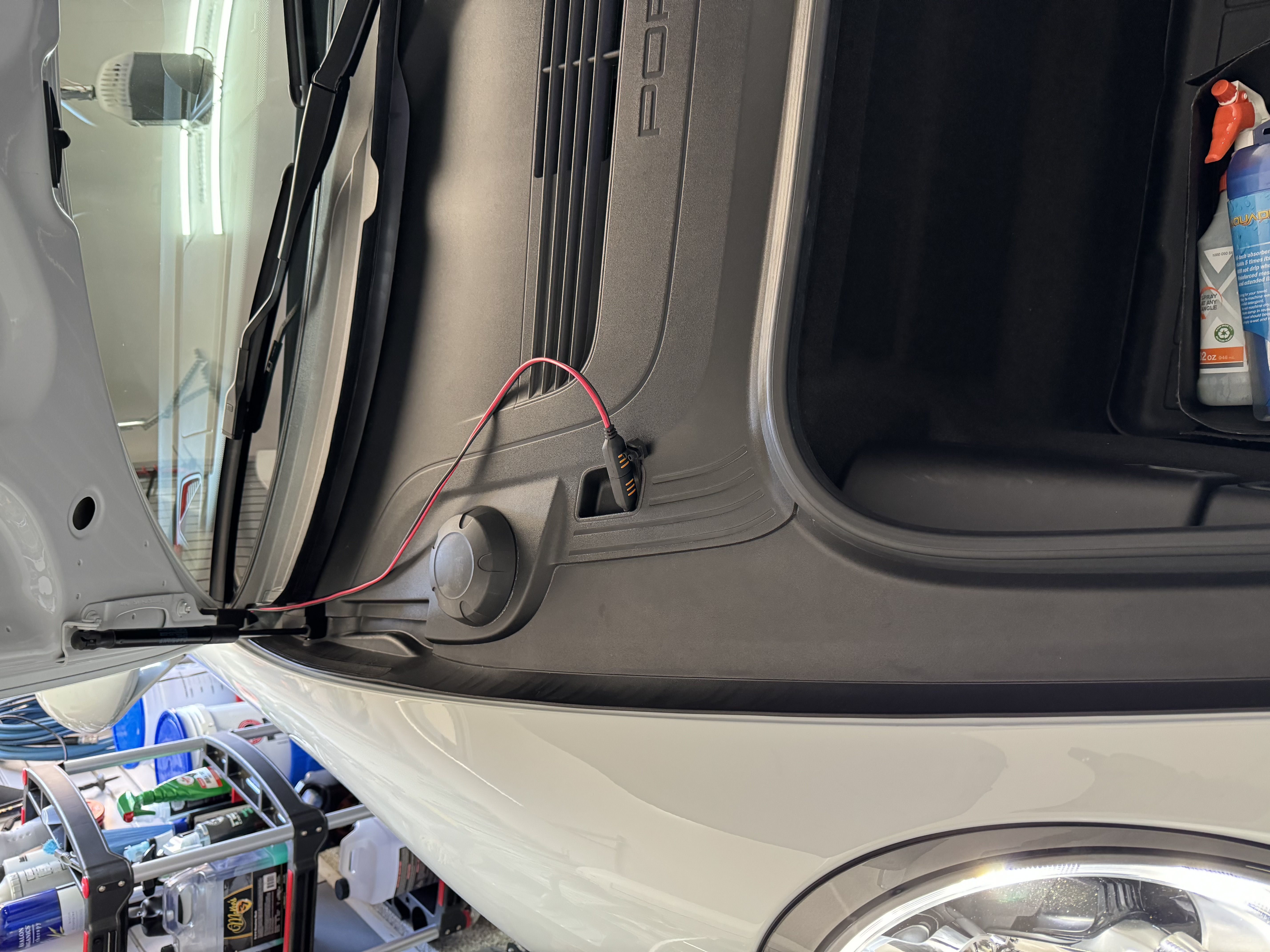

I connect mine on the frunk, positive to the pos post of the battery and the negative on the stud by the strut tower. You don't have to buy another tender if you already have a few. As long as it is no more than 3A-5A is ok to maintain. I bought a Porsche one, because I didn't have an extra one laying around. And if you have the rear steering, you do have a Li battery.
Eric

I use a CTek with this pigtail attached. I open the frunk to connect or disconnect, keeps it hidden but easily accessible.
