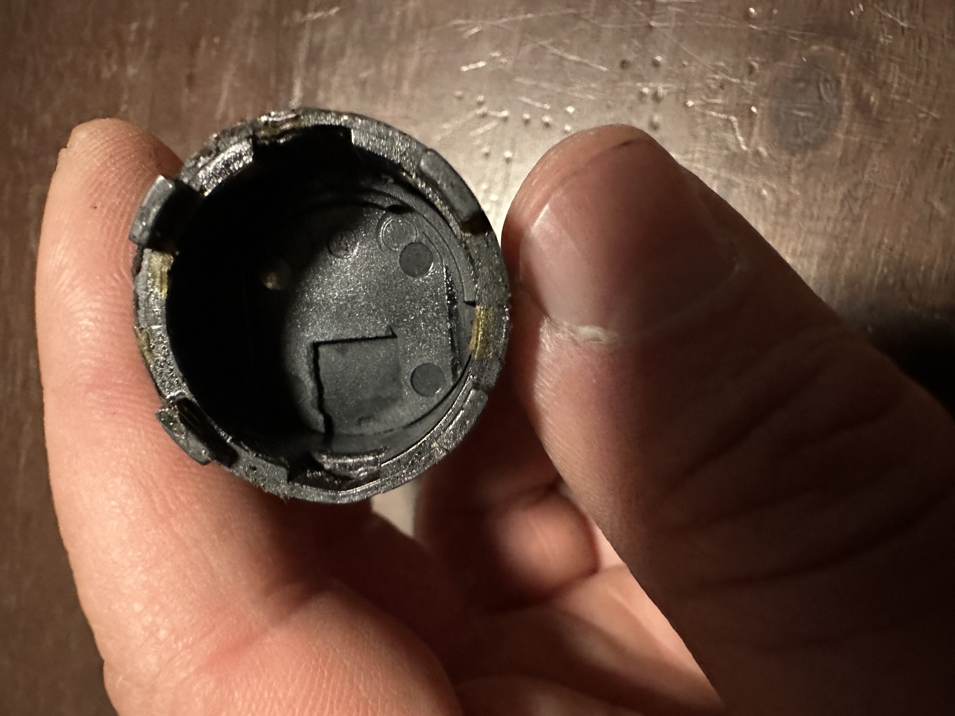

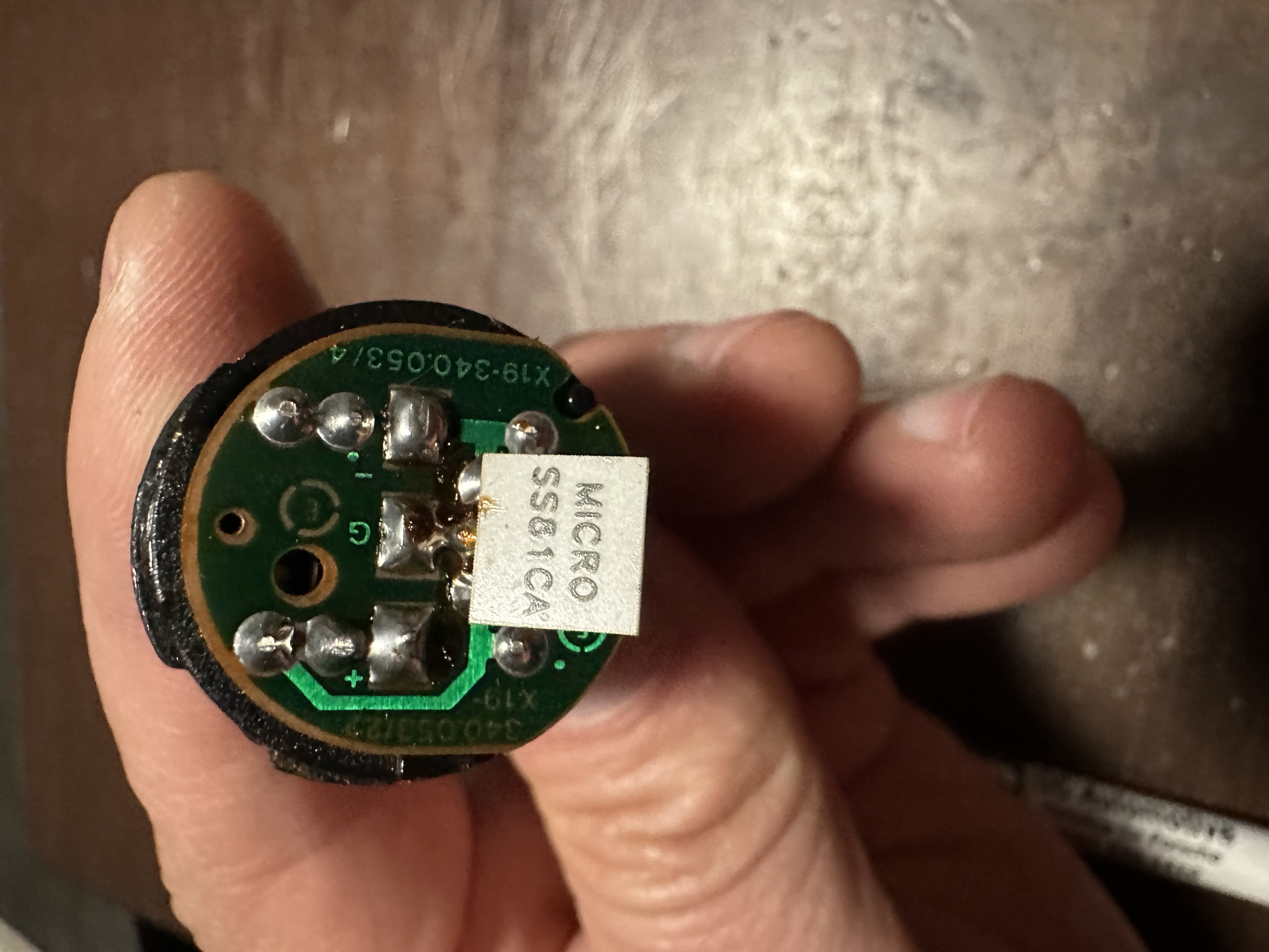

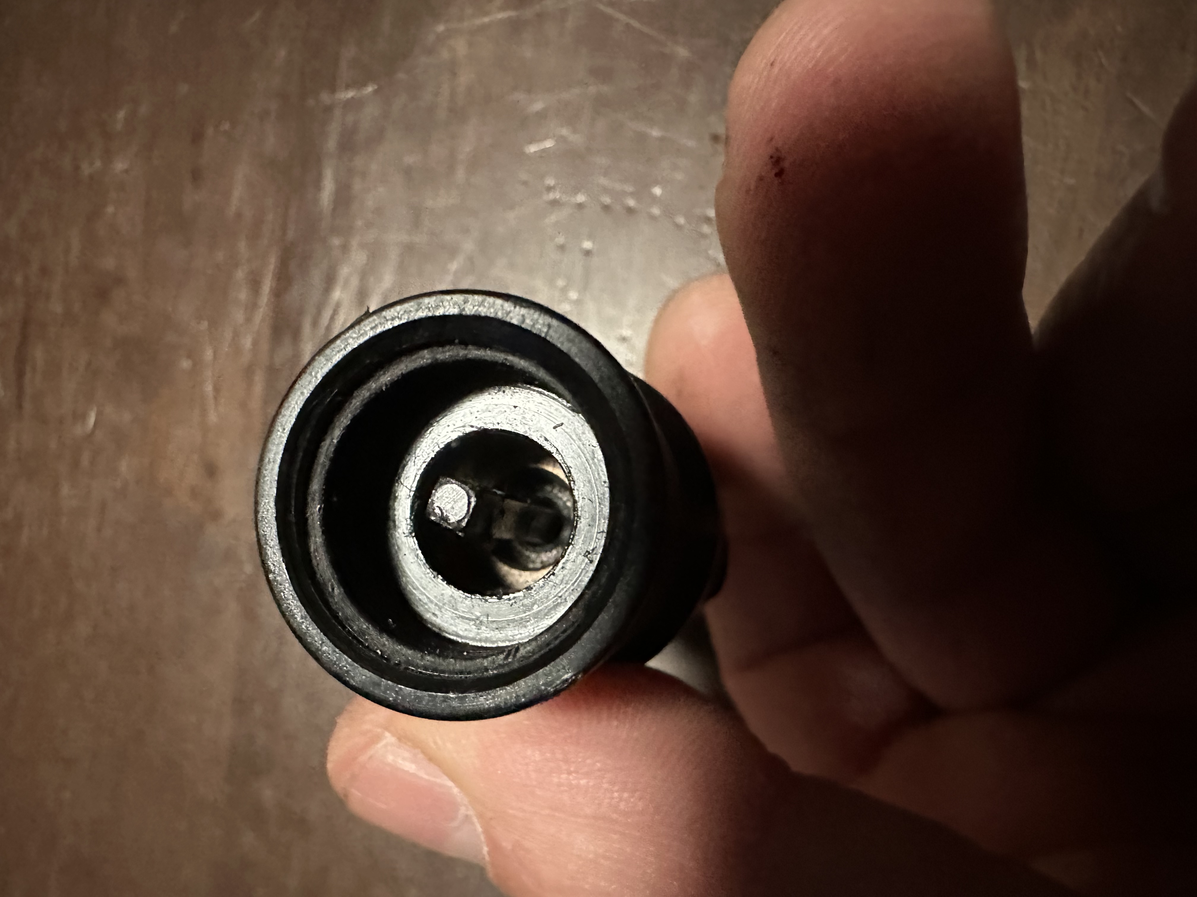

Since i have 2 of them that don’t work i was going to see how it comes apart and what i find inside. I’ll post pictures here and maybe if i can’t figure out someone else in the group may be able to help, if all else fails getting a refurbished one at least gives me options.

Here is what the inside of the impulse sender looks like

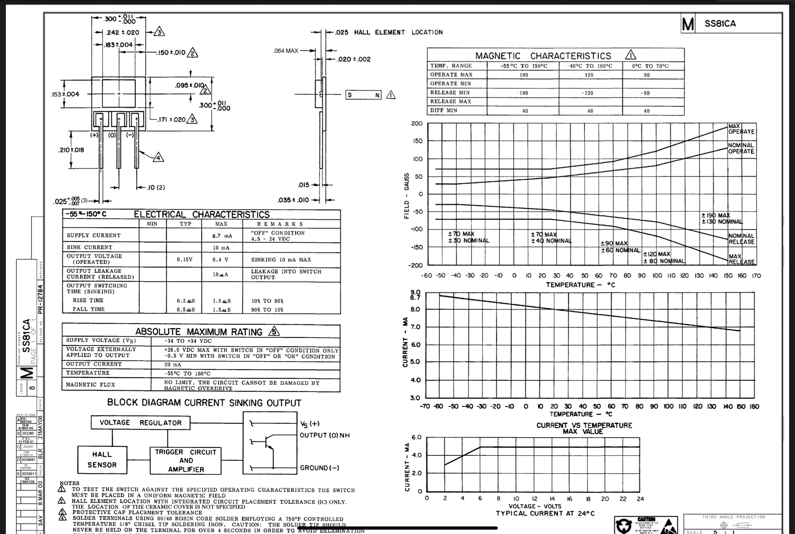

Here is the data sheet for the SS81CA on the sensor

Appears to be discontinued, but not impossible to find new old stock...
https://www.radwell.com/en-US/Buy/HONEY ... CH/SS81CA/
