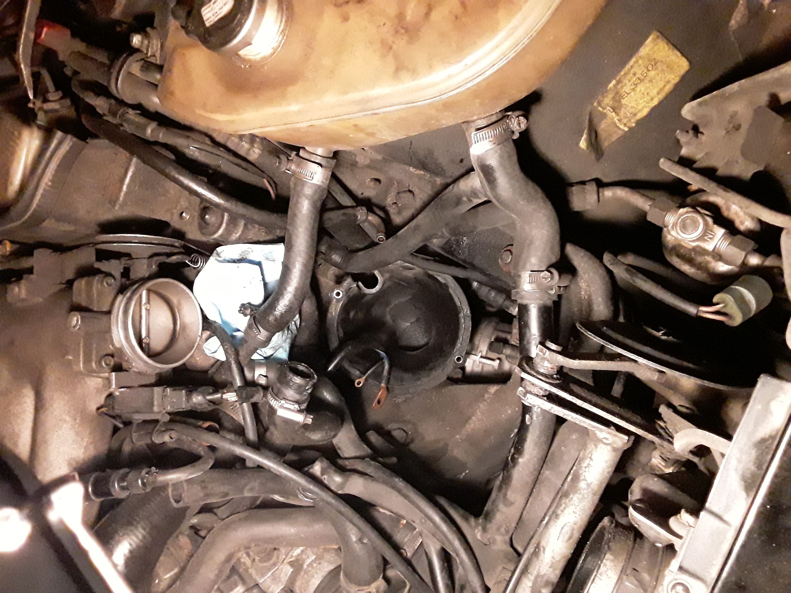

I finished changing the voltage regulator. I had to take the alternator out. Thankfully, I busted the duct mount hole on the one side you can't reach so I didn't have to pull the cooling parts; the alternator comes out fine if you leave the duct behind lol

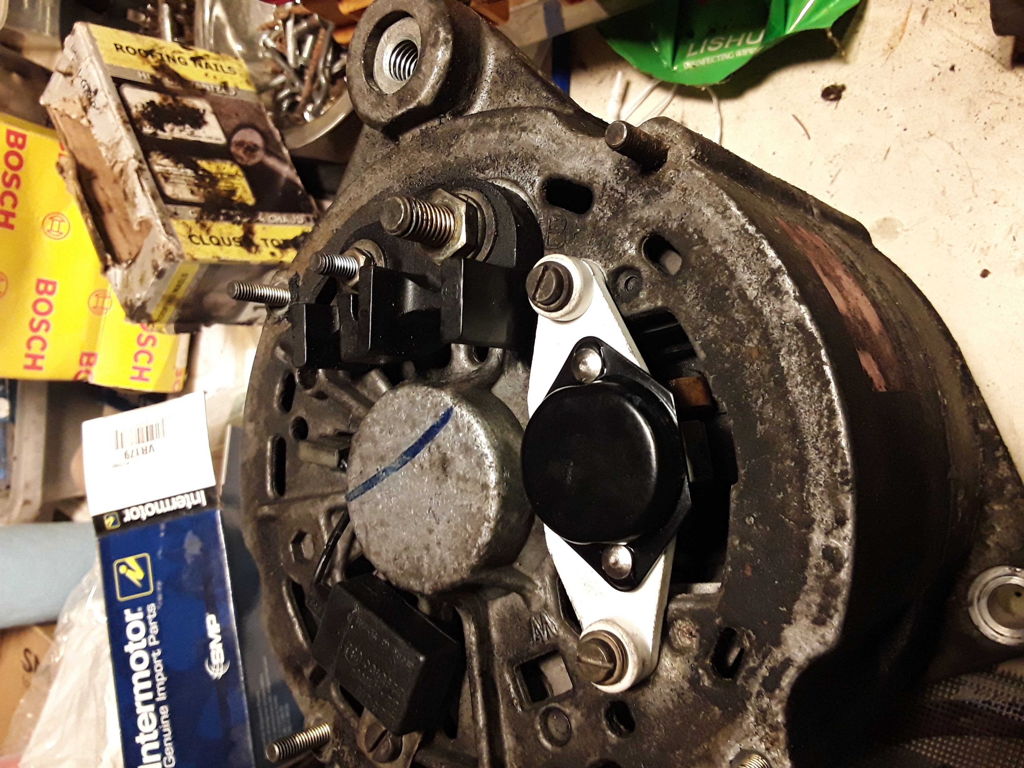

As time is important to me, I sourced a voltage regulator that is in stock at the place I buy parts from nearby. It is an aftermarket version of the Bosch original. It is clearly not as well made.
I replaced the regulator. Wow.. those original brushes are quite worn out
Put it all back together and.... mixed results. Just went for a test drive.
On startup, I get lots of volts.. 14.5v at idle measured with voltmeter at battery. However, when I crank the HVAC fan to 4, I get a drop to low 13v / mid 12v. I am guessing this drop as I was driving and my in-dash meter shows 12v; I know it reads low. Nevertheless, the drop is big.
After this drop, if I turn off the HVAC fan, voltage does not bounce back up unless I rev the motor. This revving bounces the in-dash meter back up near 14 where it stays. Not sure why revving the motor gets it to "switch" back like that (ie. not a gradual movement based on rpm but like a switch back "on")
I also notice a distinct squealing sound when putting a heavy load (such as the HVAC fan above). This squealing is intermittent but it occurs almost every time heavy load is started.
Am I correct to assume a completely rebuilt alternator is in the works here and that simply chaning the regulator / brushes doesn't cut it? Or, is this just the behaviour of a very cheap made knockoff regulator?
