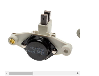

I just found a new voltage regulator for cheap. Looks like the brushes are part of it?
Seems to me if the alternator puts out 14v then suddenly nothing, most likely either a bad wire or this regulator?
I think I'll just try the regulator first. While I'm there, might check on the wires.
Anyone have experience replacing just the regulator? Is this a common thing to go?

I've done it twice in the last 20 years. Alternator has about 250k miles. Most recent regulator/brushes have maybe 8k.danmartinic wrote: Mon Nov 21, 2022 7:00 am I think I'll just try the regulator first. While I'm there, might check on the wires.

You've changed this regulator twice.. and the alternator itself still the same?
Are these brushes that are on the regulator the only brushes in this alternator? Seems a bit odd the way they are situated in back like that..

That's right. I've changed the brush/regulator pack at the back of the alternator twice. It is still the original alternator. The car (and consequently the alternator) has 250k miles. (I've owned it since it had 120k miles, which is usually about 30k miles before the brushes/regulator seem to fall, so I surmise the car has it's original alternator.)
I don't have personal experience with the internal construction of the alternator, but I believe they are legendarily robust.

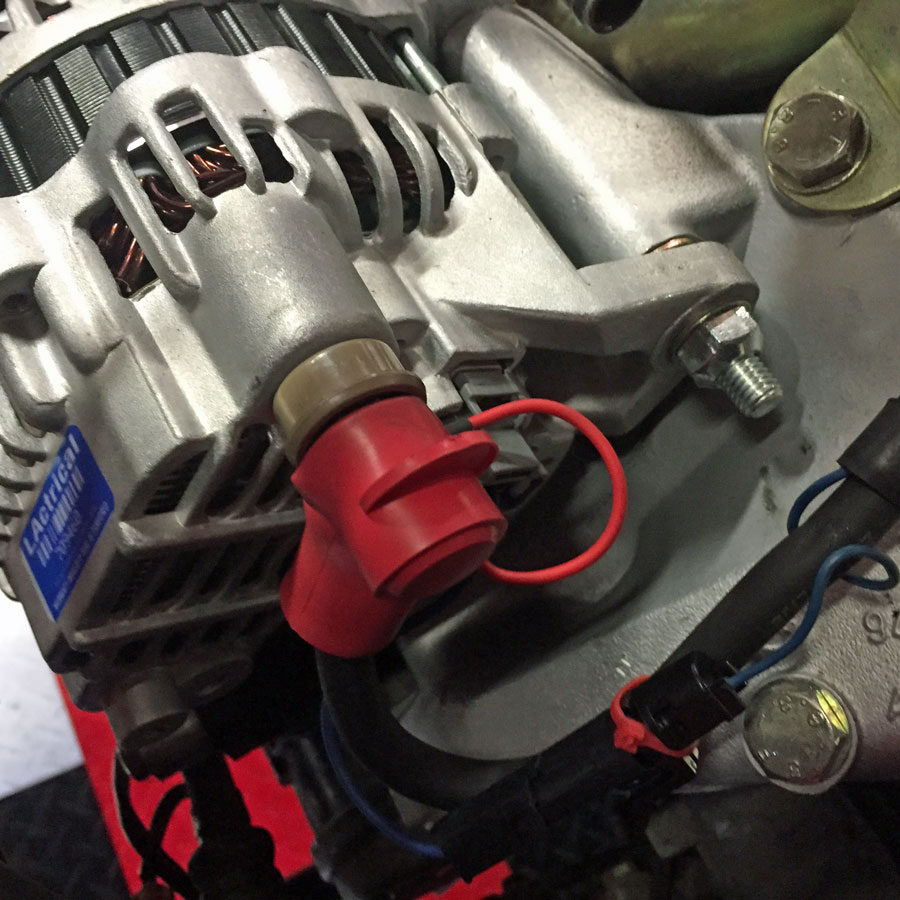

Electrical Jumper for alternator: Part # C1900. I terminated the wires with a standard WeatherPac and eye-ring connectors as shown. (You could also use spade connectors in a pinch.) You can see this in the alternator picture below.
http://store.alternatorparts.com/partnoc1900.aspx
Post Insulator: I found these post insulators at Summit – Ron Francis CC14 post boots. They are an ok fit – way better than not having-- but still on the look-out for something that seals around the alternator post a little better.

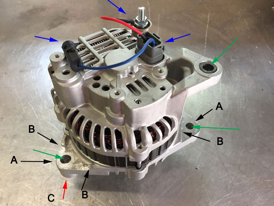

In the picture of the alternator below, the blue arrows show the electrical connections. I used WeatherPac connectors to mate the blue wire in the factory/iceshark harness to the blue wire on the alternator. I added a standard eye-ring connector on the red wire, and adhesive lined heat shrink.
The arrows marked A show where I ground down both surfaces so the pulleys all line up. I had to remove just under 6mm from the pivot mount side and about 2mm from the fixed mount side.
The arrows marked B show where I had to grind away material to clear the factory mounting bracket. The red arrow marked C shows where I had to grind about 8mm off the forward face of that mounting tab, to prevent the bolt from hitting the belt that passes right in front of that tab.
The green arrows point to where I drilled the mounting holes. I used a 13/32” on the pivot side (i.e., the closest I had to 10mm) but had to use 7/16” on the fixed mount side in order to get the bolt to slide through.

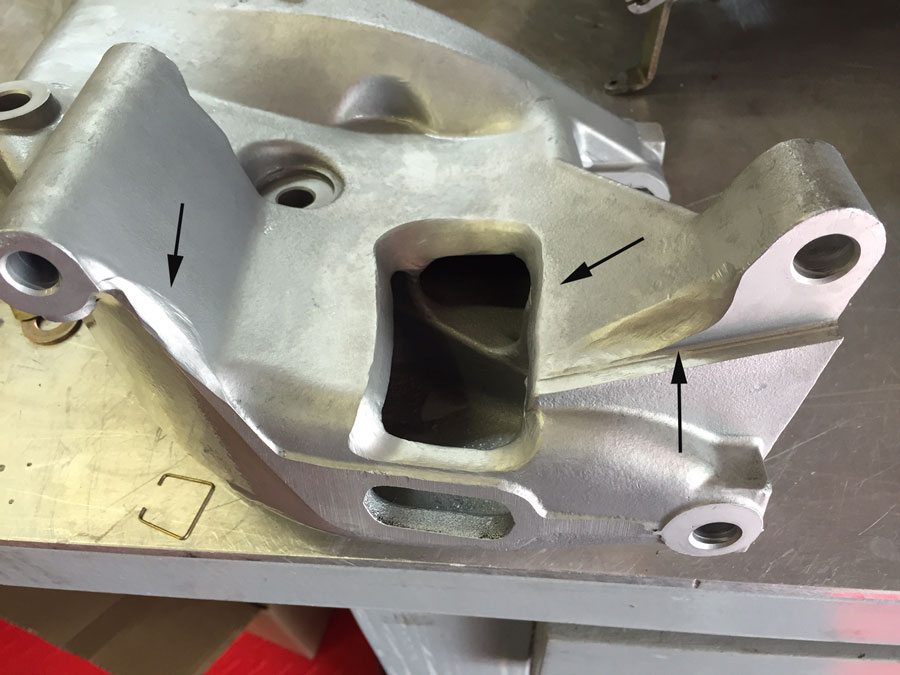

Picture of bracket shows where I ground/cut for the alternator to clear. Grinding the mount and alternator case is by far the biggest part of this job. I did it all with a cheap Harbor Freight side grinder.
