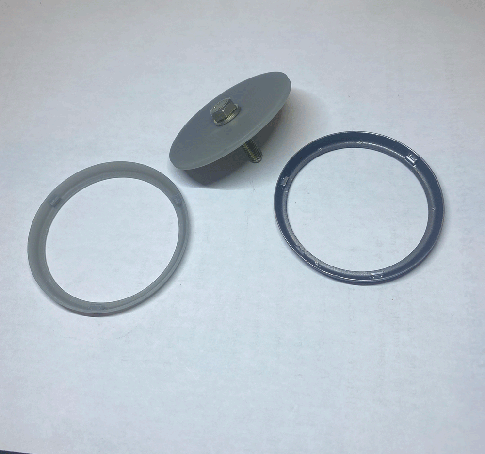

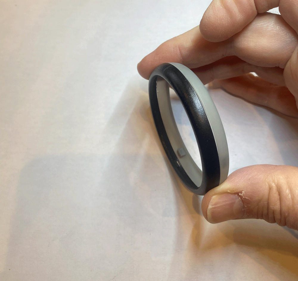

1. I believe Bob is correct about the bezel not being available separately. However, he might recall that we successfully replicated the stock bezel in plastic. I just never pushed the plastic replica because most people willing to remove the factory bezel are also willing to paint it. But for someone who wants to preserve the factory bezel as delivered and still have a painted bezel, the plastic version is a good solution. The plastic clips in the replica are weaker than the original pot metal version, so won't hold up if you repeatedly install and remove it, but if you just paint, install it, and forget it, it should look identical to a painted original. I just hope I can find the CAD (.stl) model.
See pictures below.
