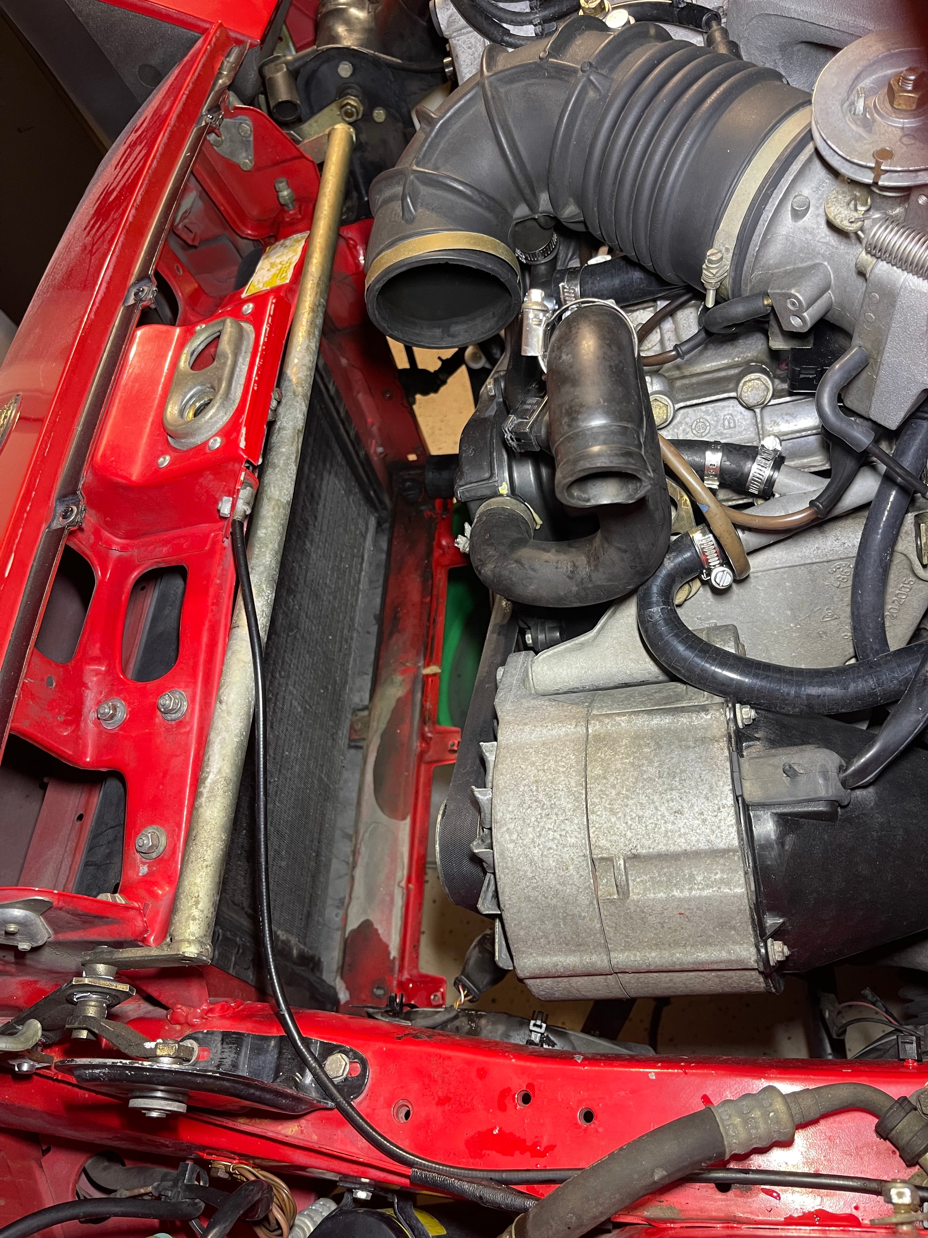

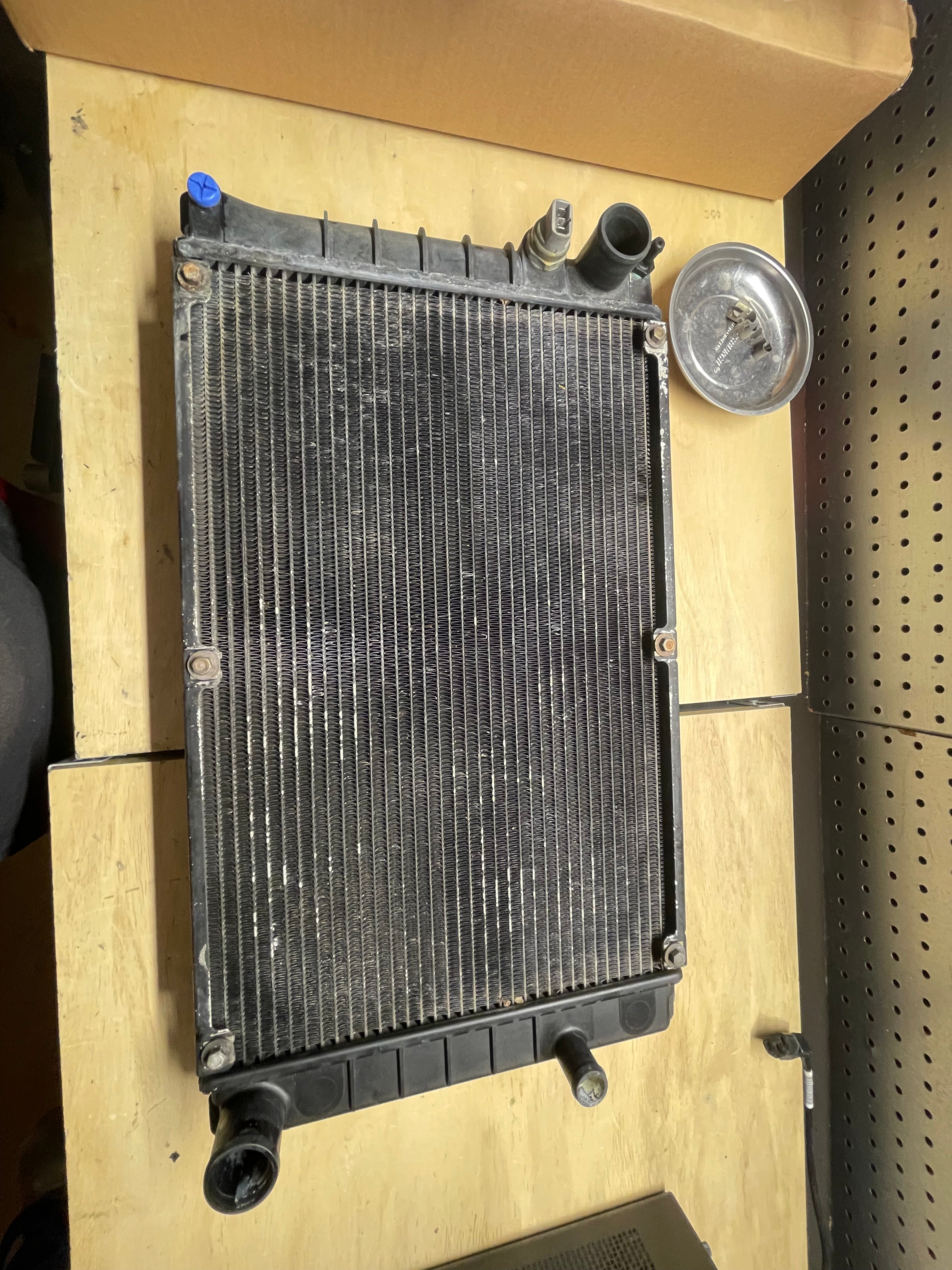

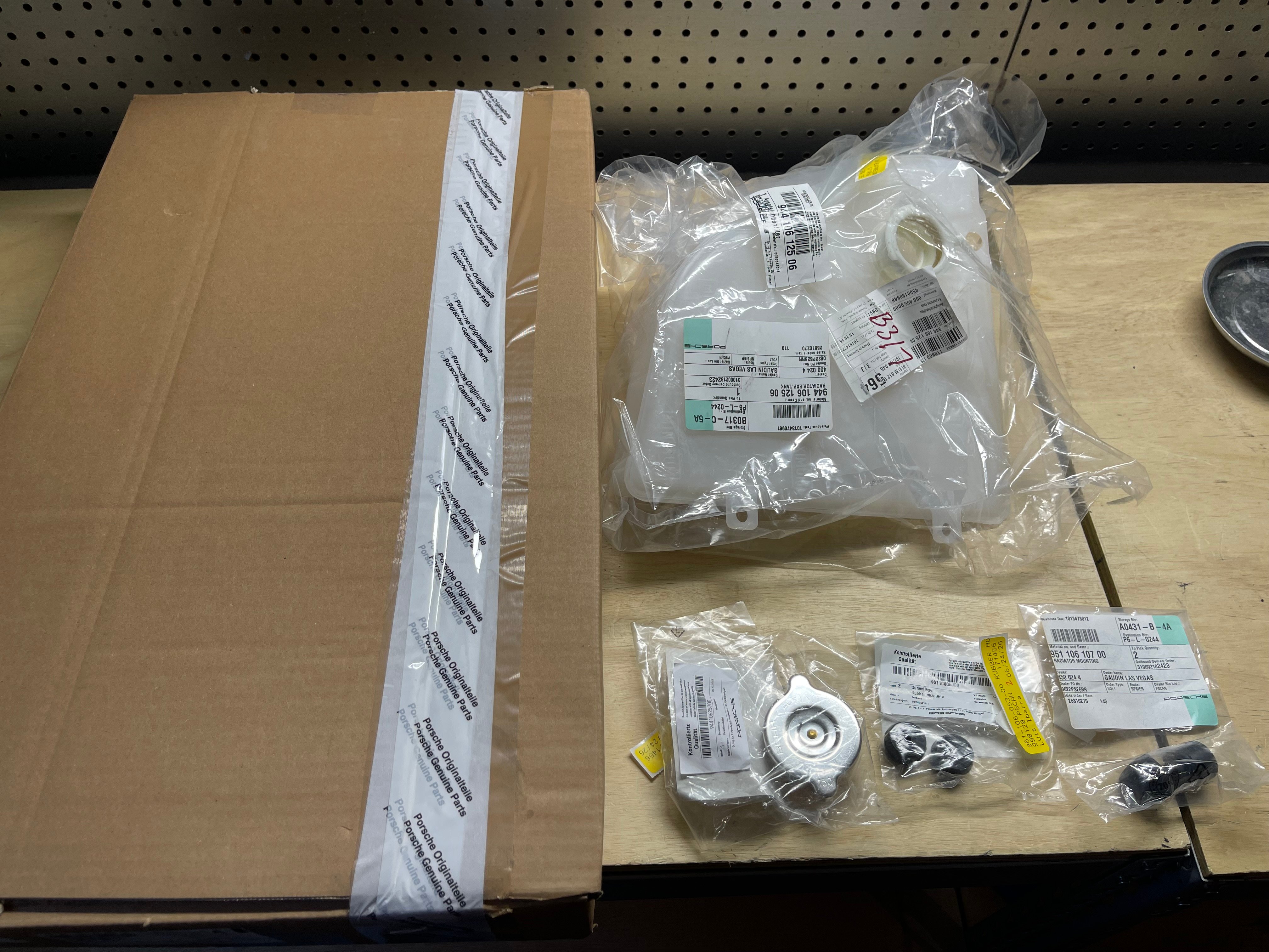

Your superpower is definitely strong, Tom :lol: Just got a new radiator along with the rest of the parts to finally wrap up the cooling system restoration.
Taking out the radiator was actually pretty easy. I’ve been in that area so many times that getting to it felt second nature. All I had to do was loosen the bolts on the left and right at the top, no need to remove them completely. Then I tilted the radiator forward, lifted it up off the grommets, and slid it down and out from the bottom.
The old radiator doesn’t look too bad. I might take it to the radiator shop, see if it can be repaired, and keep it around as a spare.
