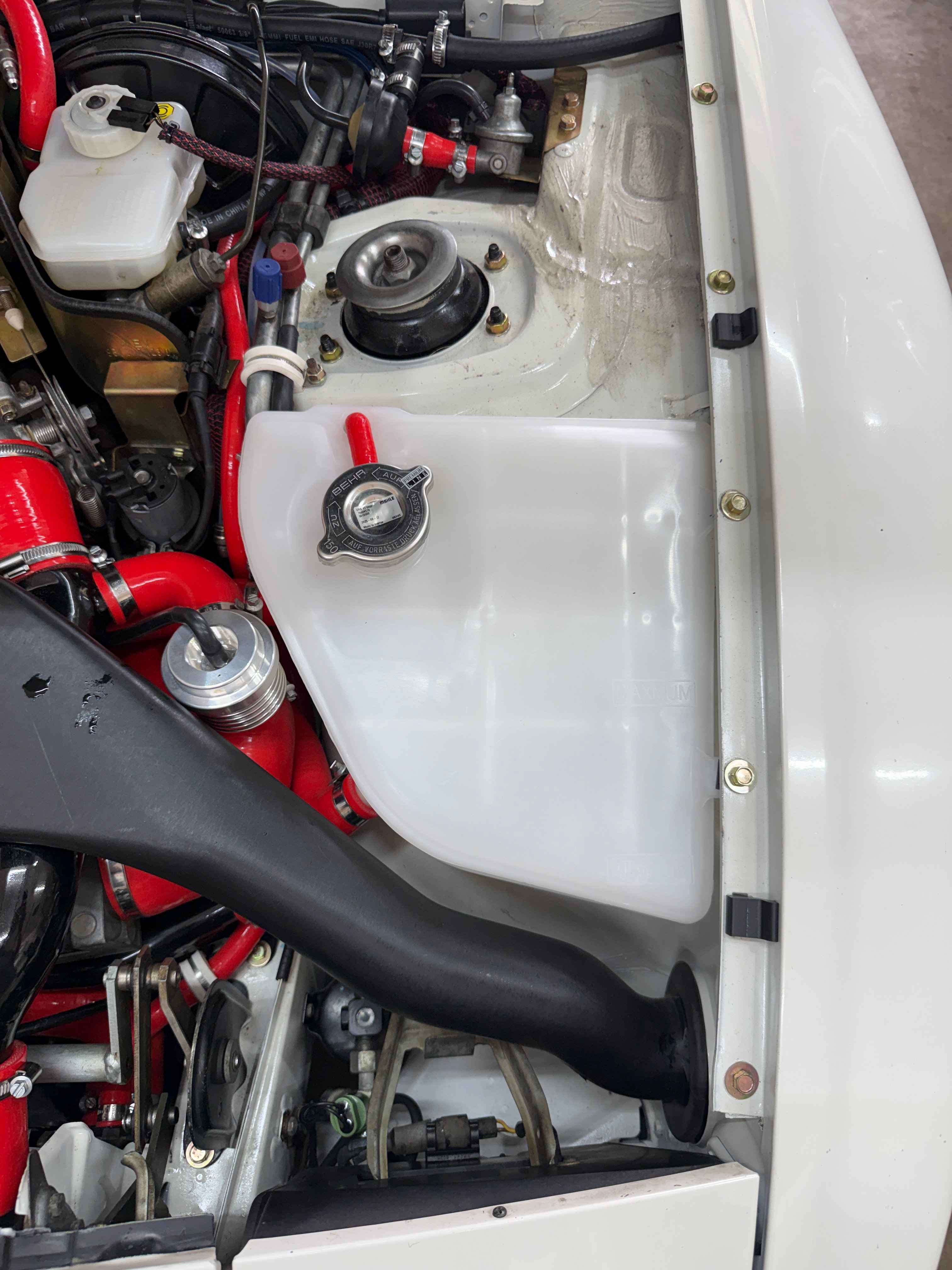

$85 Amazon expansion tank.
Mscromer
Posts: 58
Joined: Sun Mar 01, 2026 5:43 am
Has thanked: 34 times
Been thanked: 21 times
Black944 turbo wrote: Mon Jun 15, 2026 9:34 am Does it have the level lines? Just curious.
Yes it does but not quite like the original porsche one . If you zoom into the pic of the top of the tank you can see it says maximum and minimum. It’s a little hard to see.

Just installed the $85 Amazon tank. Fit was perfect, didn’t have to pry it into to place at all. Took the car for a drive and everything is working as expected. No leaks.
