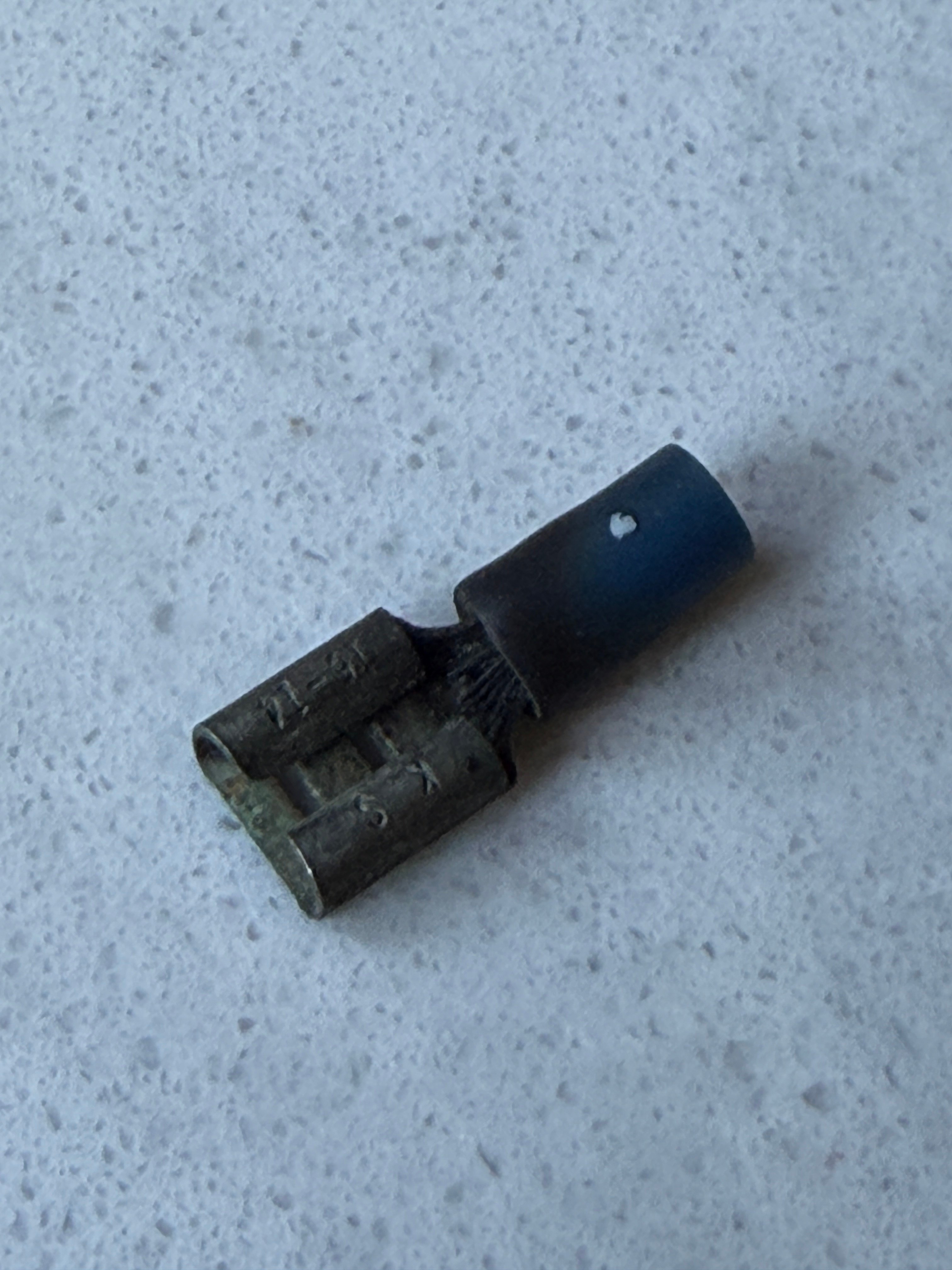

Well I finally got my car up on the lift to keep troubleshooting this issue.
Located the wire coming off the compressor. It was zip-tied to a hose with two short zip-ties connected to each other - which gave me my first inclination that I wasn't the first one to put hands on this.
The second sign that someone else may have been chasing this at some point was the crusty crimped on connector when I pulled the two apart.
I put my multimeter on the female spade connector and the other terminal of my meter to ground. I got some million-ohm reading and I thought - "well that's not good".
I tried putting 12v to it and that did nothing as I sort of suspected. still it made me a little
disappointed.
Then I pulled on the connector and on the wire itself and the crimp-on connector just pulled right off. the exposed wire left behind was all oxidized and brownish.
So I snipped a bit back and stripped it and measured the resistance again and got the 2.5 ohms. I put 12v to it again and a big arc and a clunk sound came out of it!
So I sanded the strands of wire and soldered them to a new female connector and put some
heat shrink tubing on and plugged it back into the other connector.
Took the car for a spin and turned on the air. I can't say I really felt a huge difference, but I did notice it draw the rpms down on the engine
when the compressor kicked on. I got out and looked at it and the clutch was indeed engaged!
When I turned the air off though it did feel just a little more humid possibly. or maybe that was just optimistic hope kicking in?!
Success - at least as far as getting the compressor to work. I think I will add some
R134a and see if I can feel it cooling a little
better.
But at least the system is holding some measure pressure (or the compressor wouldn't even engage) and the compressor does now kick in when it's turned on!
Thanks guys!!!

Looking hard at the simple crimp connector in your picture, it looks a lot like heat damage from the spade end, maybe less from the wire crimp end. Maybe. Regardless, heat looks like a prime suspect. Heat from current flow through the connector and some resistance. There are schools of thought on whether a crimp is better than a solder connection to the connector itself. The aircraft industry has decided on a proper crimp rather than solder and heat shrink, if that helps in the decision. Most DIY crimp connectors, like the one shown in the picture, don't readily fit the 'proper crimp' criteria. If you look at the ground logs used throughout the car, you can see how a 'proper crimp' really works. Most decent crimp-and-shrink connectors will be fine with a ratcheting crimper, less 'fine' with a common squeeze crimp. Considering the high current (14.4 volts over 2.5 Ohms means about 6 Amps continuous current flow through the connector and the ~~16ga plated steel wire stranded wire to the clutch. Yes it would be better with a bigger wire, but that's not our option. From the harness side, the wire size is closer to 16ga too. Should we hunt down a better connector? Heck yeah! Go shopping for the best connector and the best crimper for it. Watch some yeaux-toob videos for clues on how to use the ratcheting crimper correctly. Remember to actually shrink the sleeve that's already part of the connector, and maybe add another full adhesive-lined sleeve for some mechanical support.
The opposite may apply too -- Do what works right now, get the cabin cooled now and for the rest of the summer. If you have another episode like this, you'll know right where to look.
I like forever solutions but sometimes immediate has a higher value.
