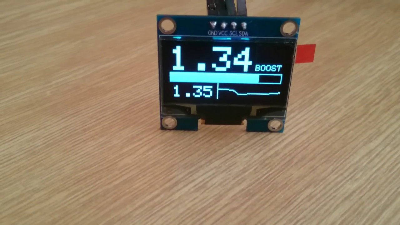

Check this out. someone made one. I think he shared the code in the comments but Im at work and cant open it. SHould give us a good start
DGUN951
Posts: 52
Joined: Wed Oct 13, 2021 5:10 am
Has thanked: 11 times
Been thanked: 19 times
If we could use an OLED display we could display a lot of info on one screen, Grear, Boost, Target boost. ect
