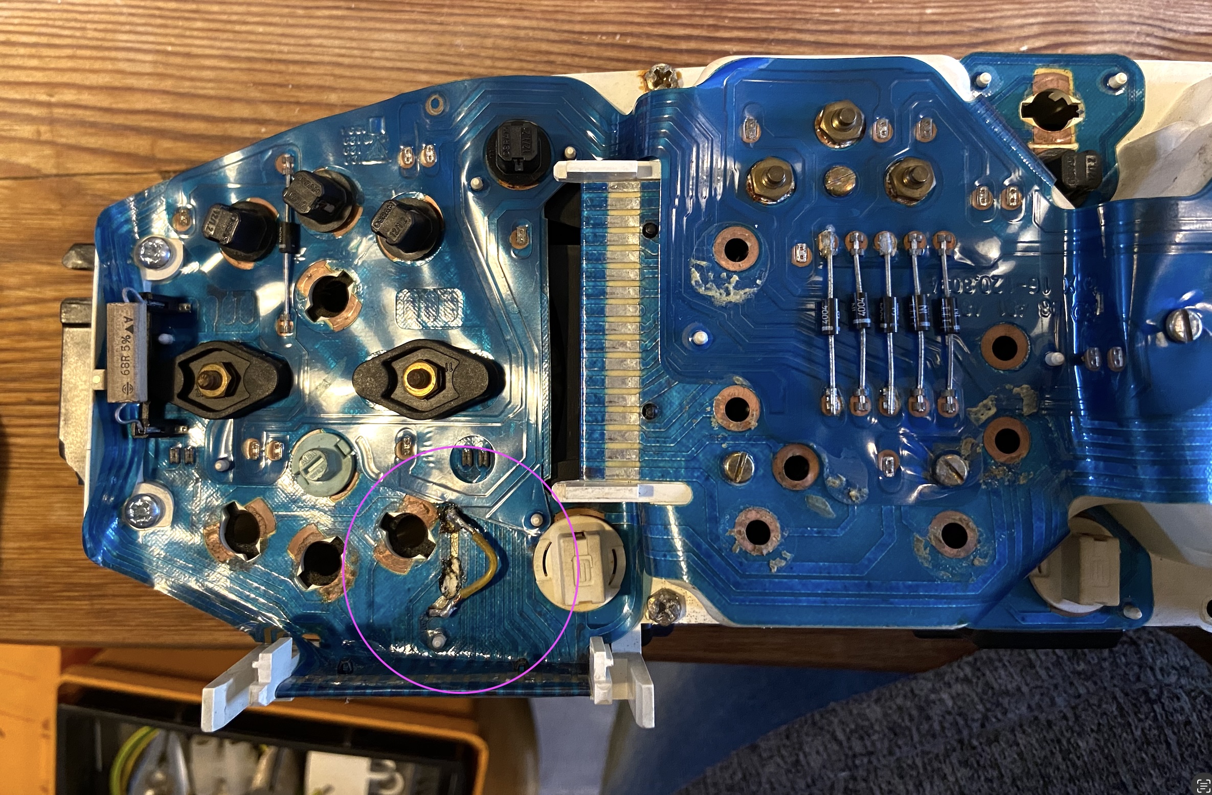

I'd start by testing to see if B6 and b7 have continuity to the bulb socket pads. Conceptually, the cluster bulb is no different than a light bulb with two wires attached to it (b6 and b7 are the ends of those wires). If b6 or b7 is not connected to that bulb socket, you just need to find the break in the copper trace and patch it. Or if that seems intimidating, just tap into the B6 and B7 wires and run a jumper wire straight to the bulb socket. Hacky, but no worse than a separate bulb.

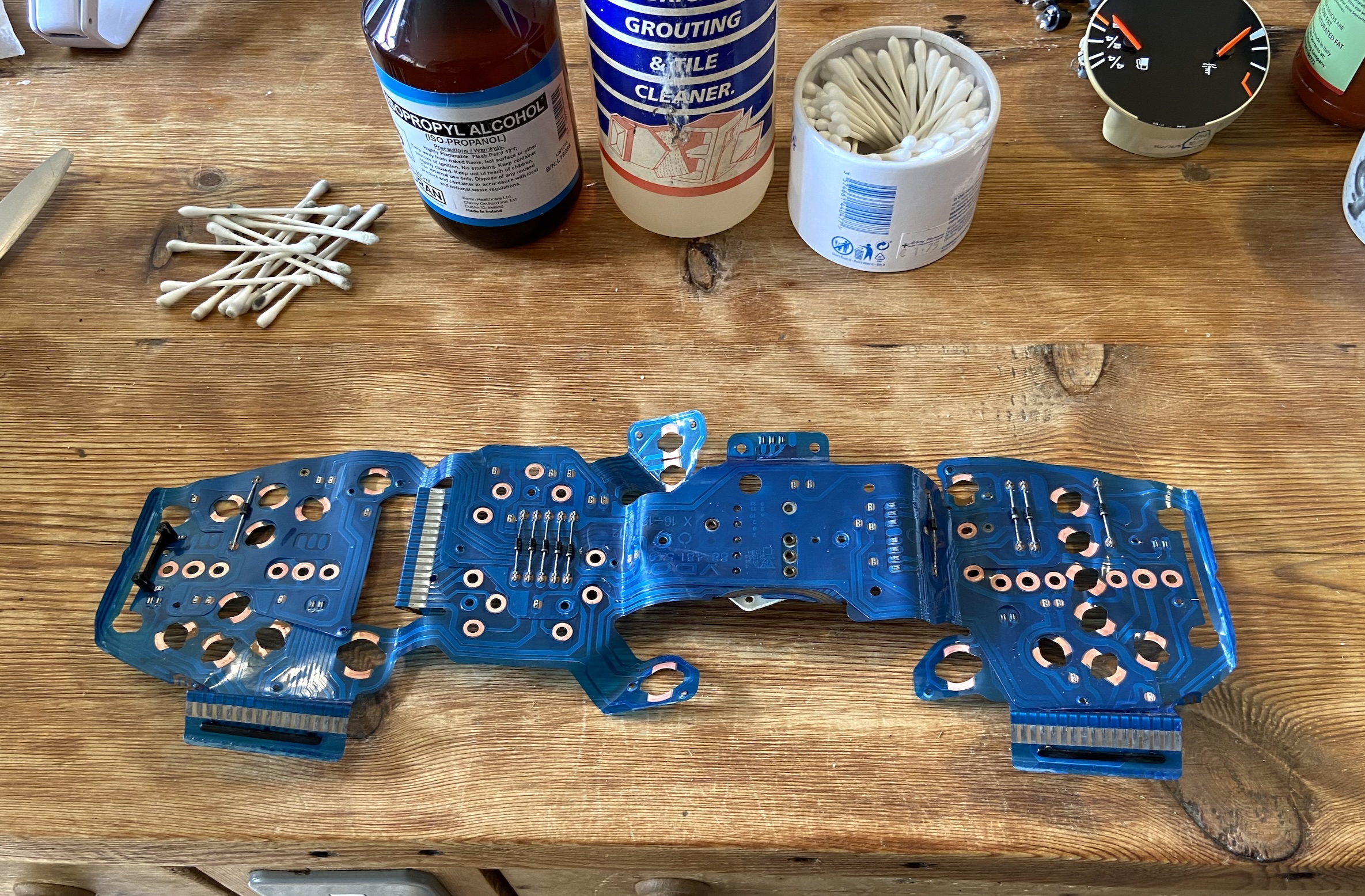

My car had a poorly-repaired cluster when I bought it.
I bought a salvage cluster and swapped the circuit board over:

jeyjey wrote: Sat May 30, 2026 2:04 pm My car had a poorly-repaired cluster when I bought it.
Was any soldering required to fit the new circuit board?

blade7 wrote: Sat May 30, 2026 3:44 pm Was any soldering required to fit the new circuit board?
Nope. It's all little plastic poppers and screws.
