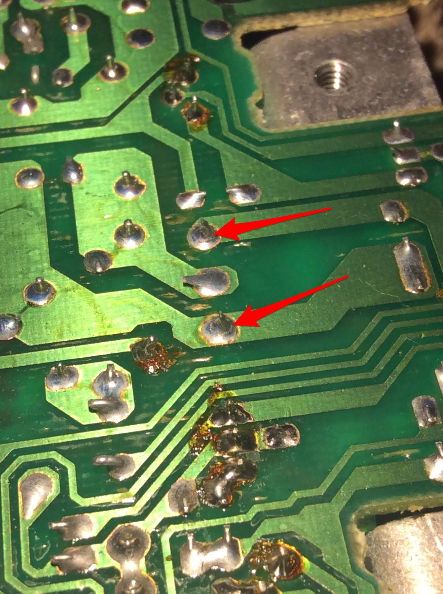

Open your ECU / DME and look for these little lines
Touch a hot solder-tipped iron to all of them
