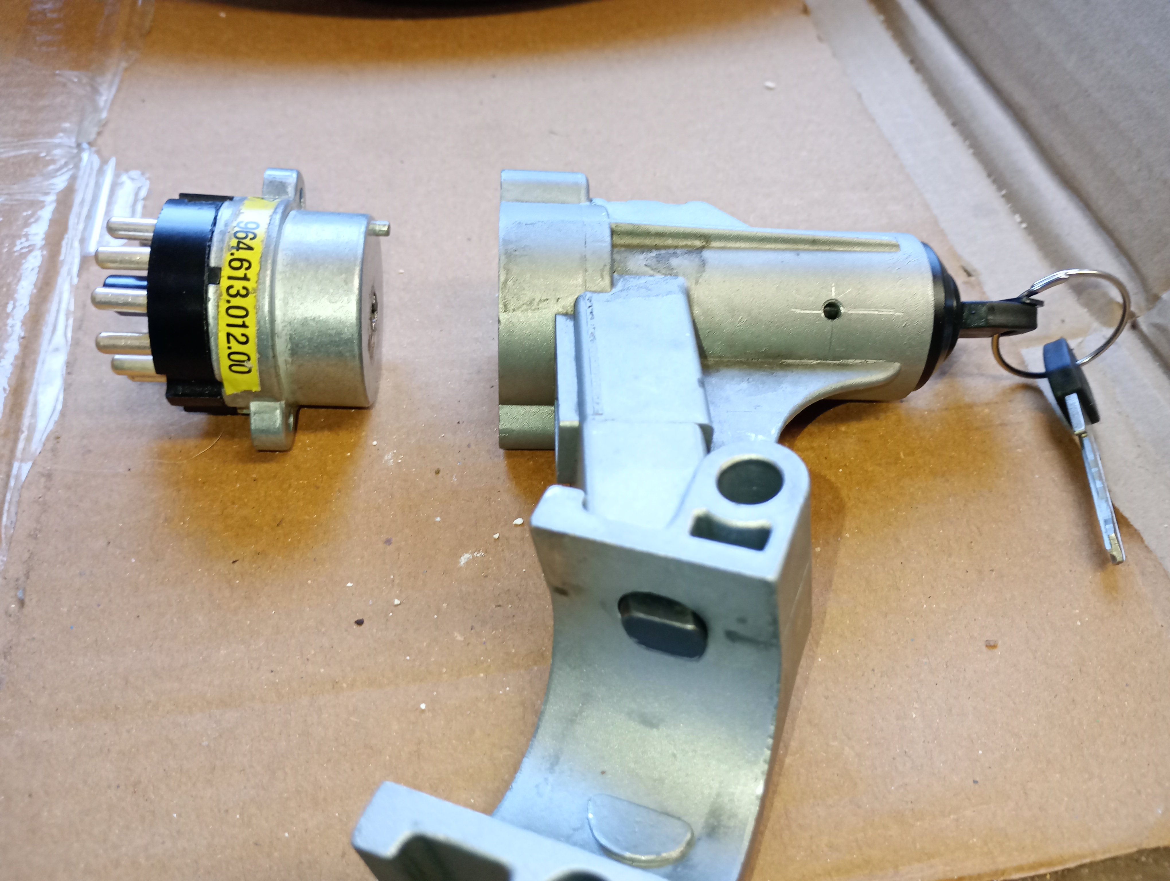

I'm having an issue with the steering lock/ignition switch. When the key is turned past the accessory position to activate the starter motor, and then released, it doesn't return to the accessory position. So is the return spring located in the steering lock assembly, or in the multi pin plug that fits onto the back of the steering lock/ignition barrel assembly?

Try looking at the electrical switch on the back of the lock first. I’ve seen them get sticky/worn and not spring back properly after the start position. Much easier to try that before digging into the whole steering lock/barrel assembly.

Thanks for the reply, too late now though. Did all the digging, and I've just bought a new switch from Porsche.

So the spring is in the electrical switch piece?

jeyjey wrote: Tue May 12, 2026 3:48 am So the spring is in the electrical switch piece?
It is.
