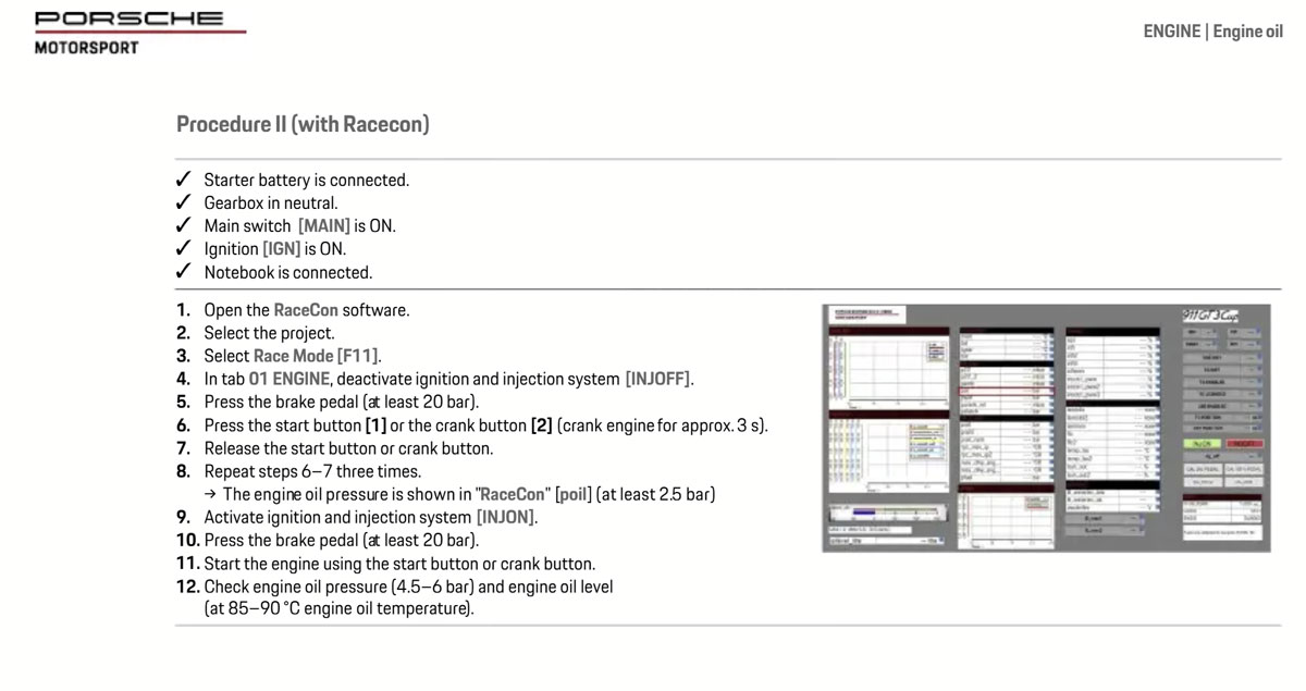

I'm no expert on the new GT3's but it is my understanding from hanging around owners and posts that it does run higher oil pressure. Here's a page for the GT3 Cup car (not an identical motor obviously, but lots in common) that lists oil pressure of 4.5 to 6 Bar (i.e., up to 87psi).... I've asked a friend with a GT4RS to check his and will report back what he sees...
