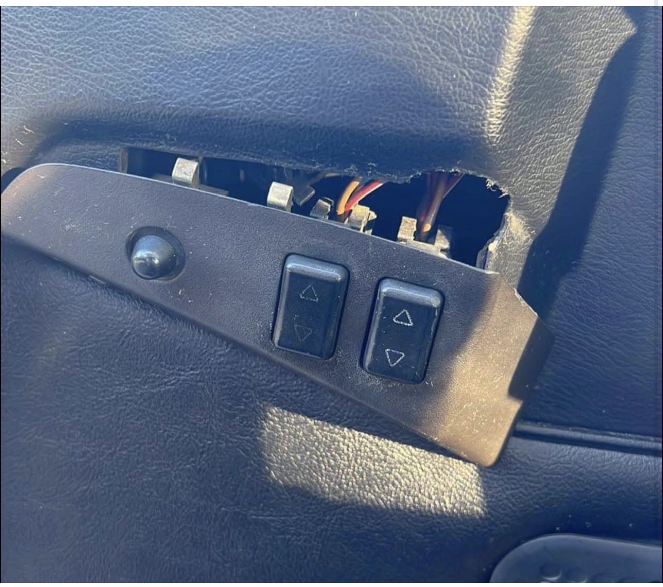

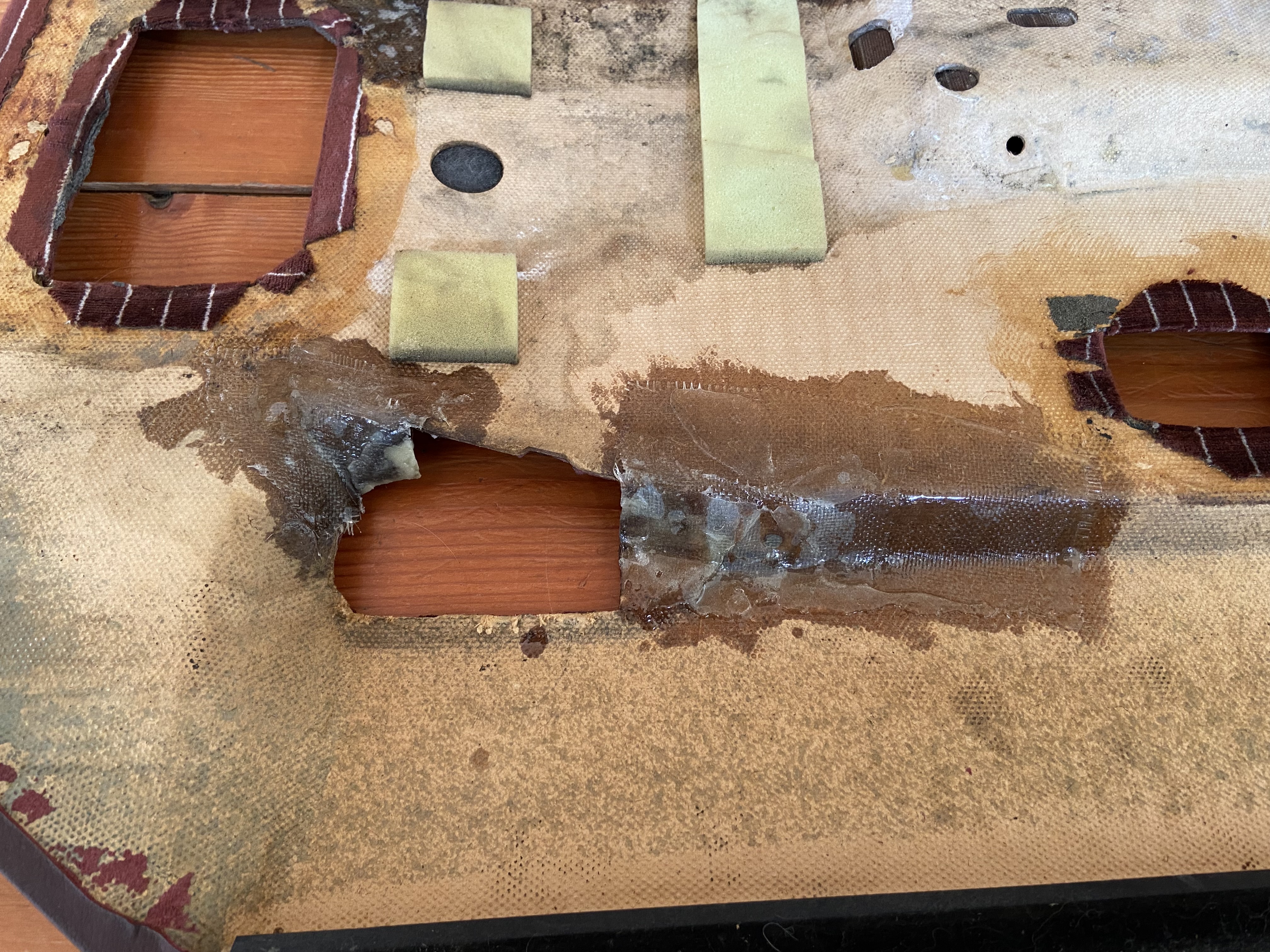

Last week I would have killed for a set of those 3D printed switch surrounds! Not sure how I missed this post. Spent the last couple days fiberglassing, cutting and a dremel to fix mine! Post with pics to follow :D

I'm also interested to see how washers were used to reinforce. I planned to just use glass cloth.
