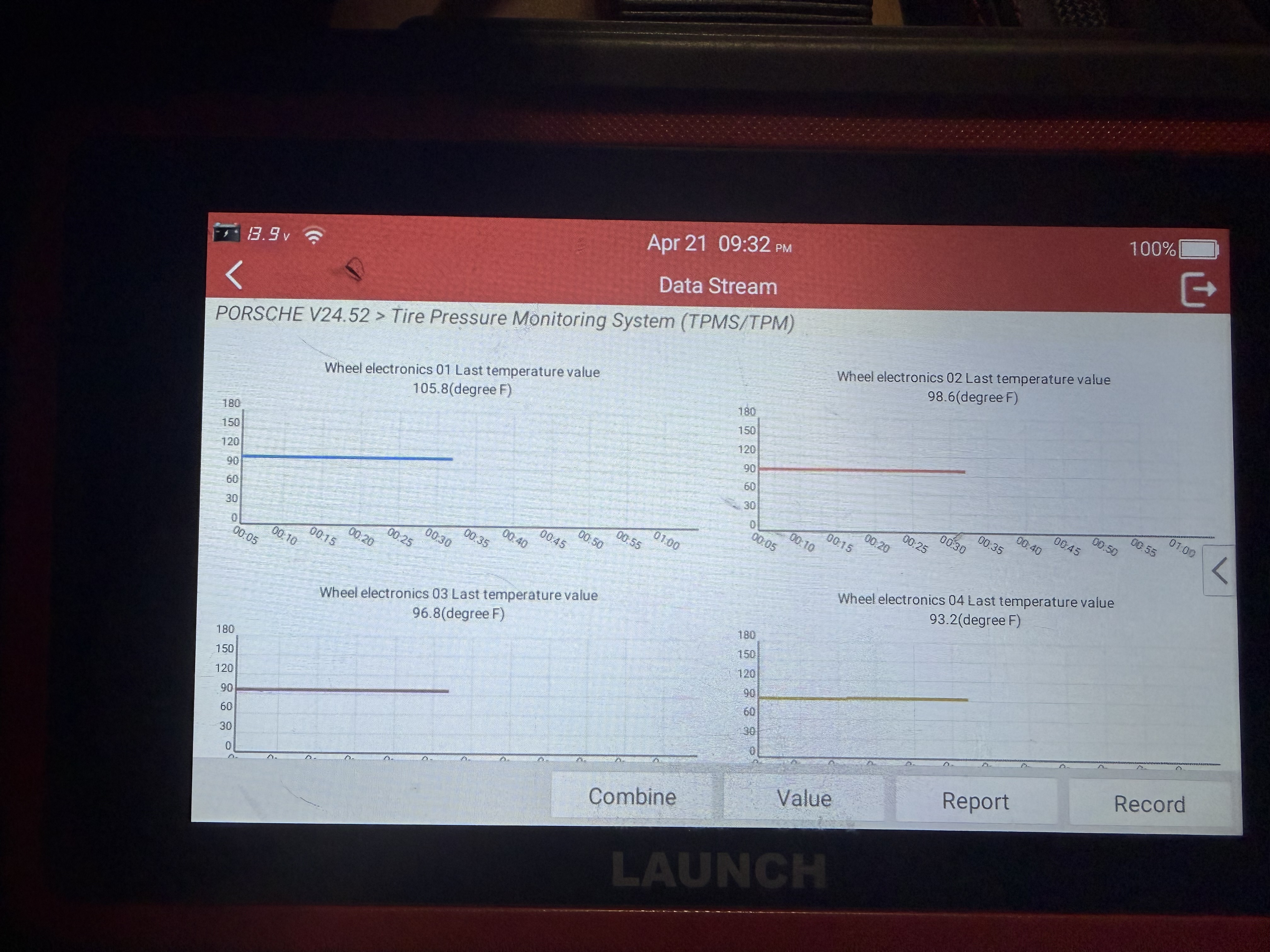

I was looking around in my Launch X431 to test something for another user and then thought I would check out these new TPMS sensors.
I have long wanted to have the car show tire temperature as well as pressures and had a look and what do you know the sensors do show temperature as well as other things.
I am now on the hunt to see if I can add tire temperature to my dash display. Asked AI and though it gave me instructions for enabling it, the place AI said to change does not exist.
Here is a graph of my tire temps as proof it is there

Rotated the image for ya.J-Dub wrote: Wed Apr 22, 2026 6:42 pm I was looking around in my Launch X431 to test something for another user and then thought I would check out these new TPMS sensors.
