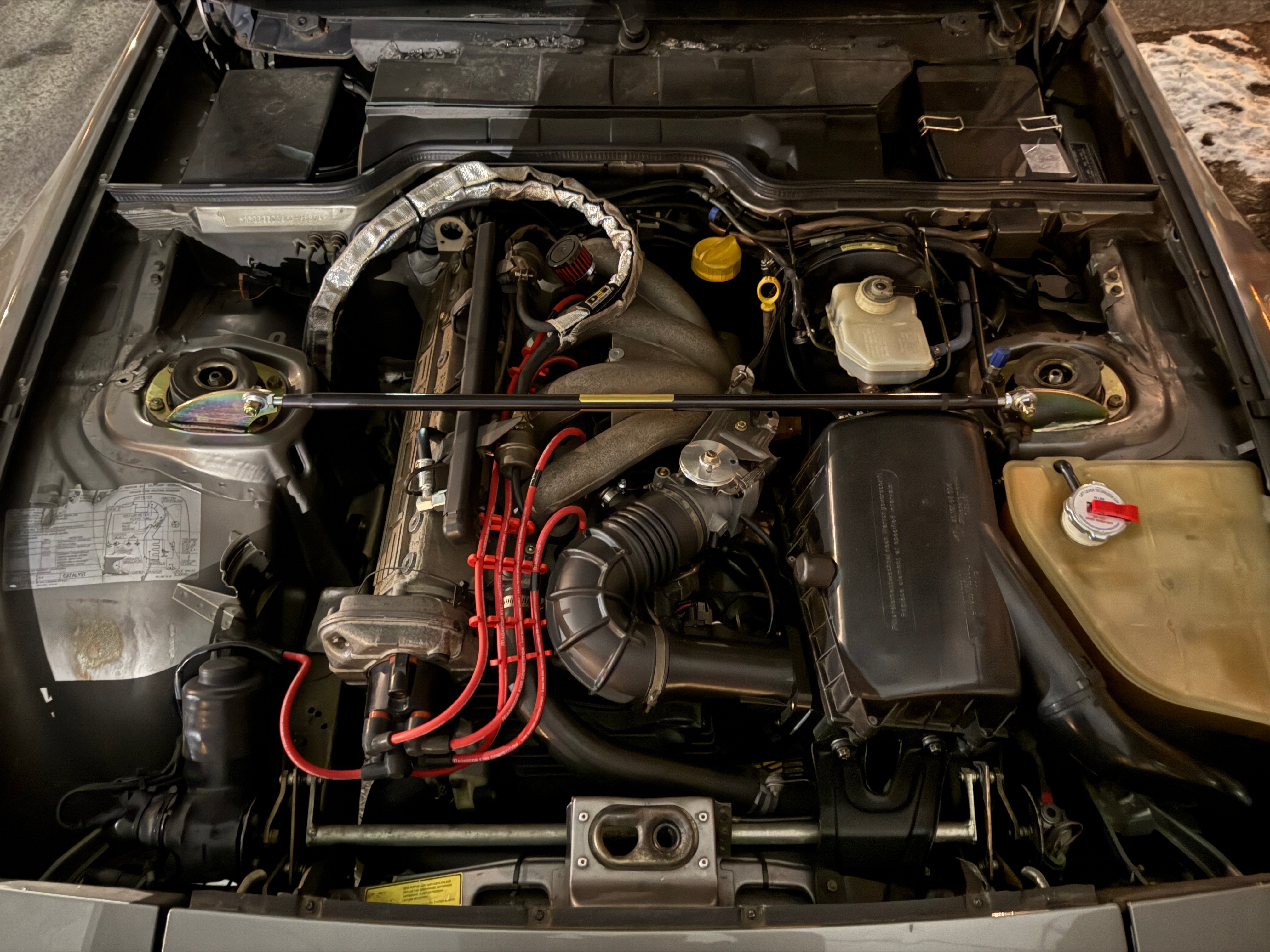

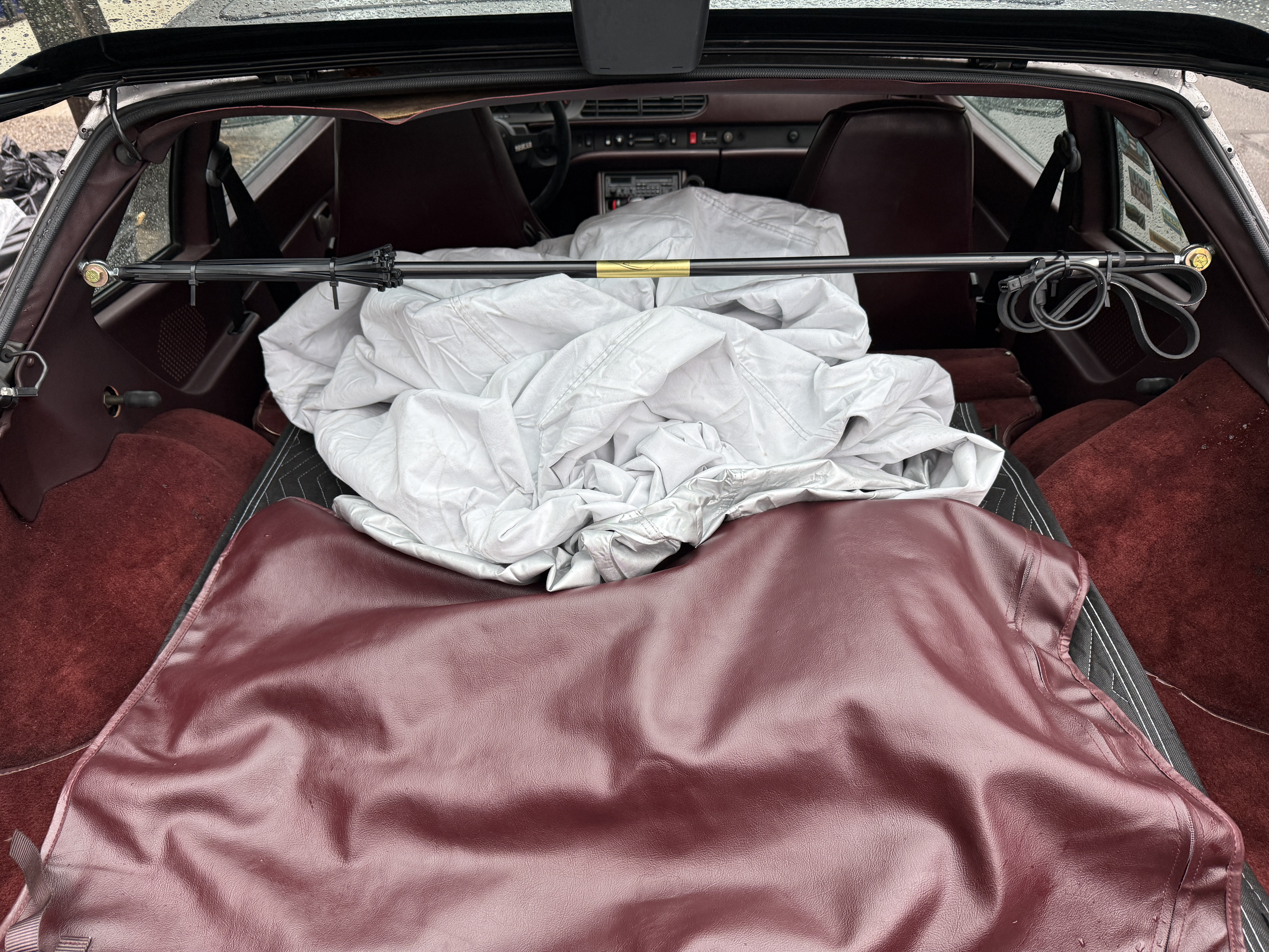

I have the KLA Apex strut tower and interior brace, love both. Very well made.
I had the strut bar on the wrong side, so just note that doesn't have that poor of clearence.

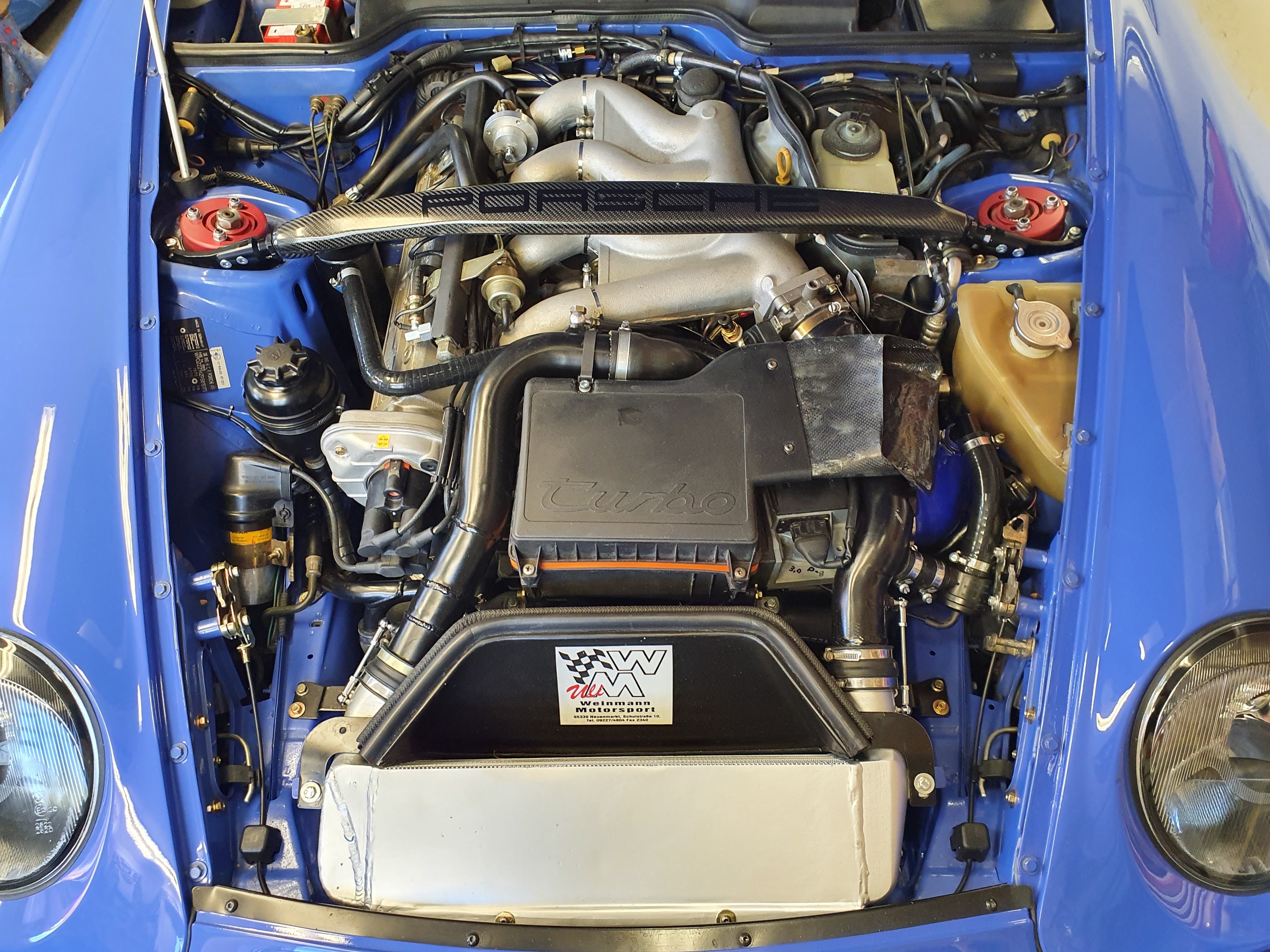

I have the CF 968 TRS replica strutbrace from Patrick (Tielecar) on my 968 TRS replica.
Great product.

One side note, though the rear strut brace is helpful in stiffening the rear body to a degree please do not decide to use as a mount for harness belts as it is not strong enough and would not offer additional safety --- in fact it could be a detriment.

Looks to be mounted too high to stiffen anything but the roof. Mounting on the rear seat catches makes more sense to me, that means losing use of the rear seat though.
