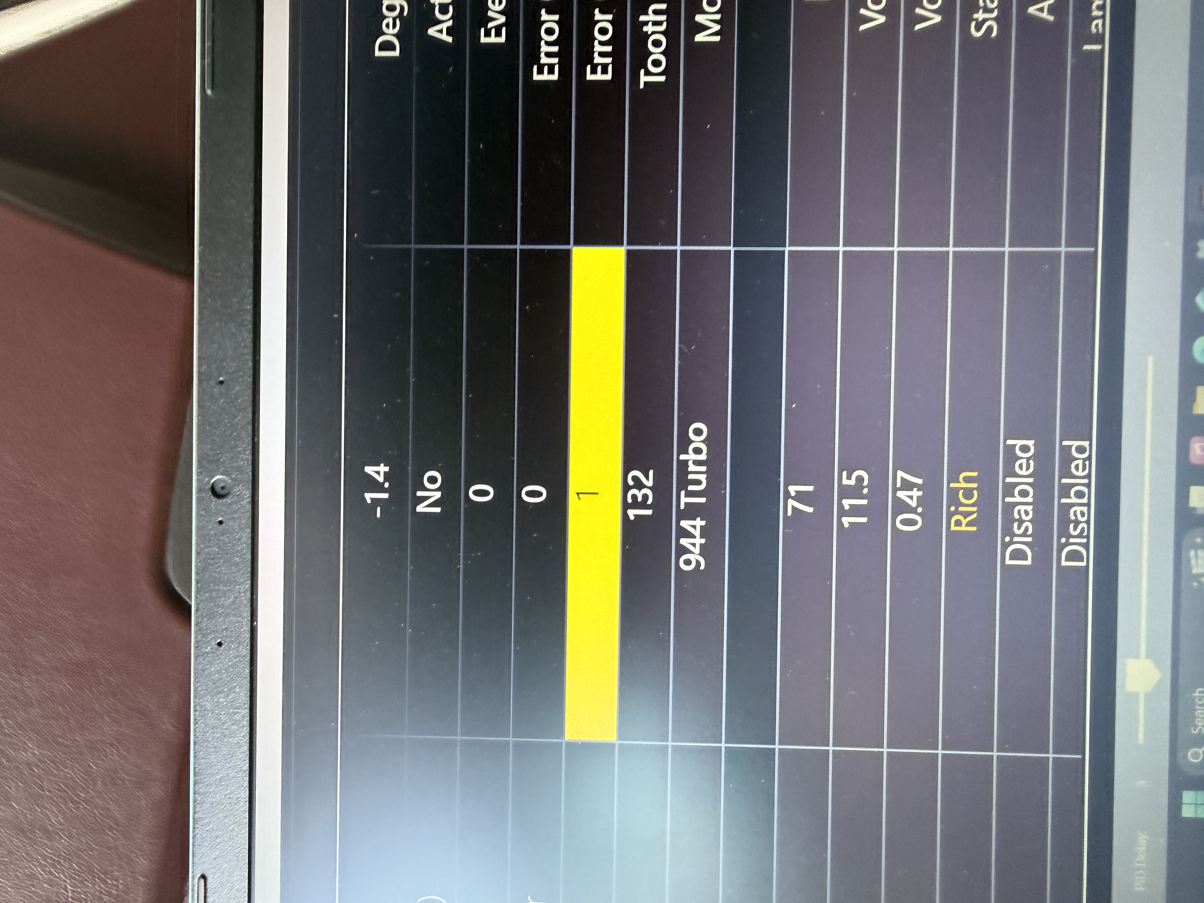

If this helps any the 1 value on the fly wheel rpm error in the F9T software was highlighted yellow while trying to start. Im not savvy on all this data yet, but a 1 in a fly wheel rpm error column that is yellow doesn’t seem good to me.

I agree, that doesn't seem good.
After downloading the FocusOBD software, I can't figure out how to open a datalog to take a look. Having a tooth/trigger log would be ideal, if that exists ... again, F9 noob, but I'm learning :)

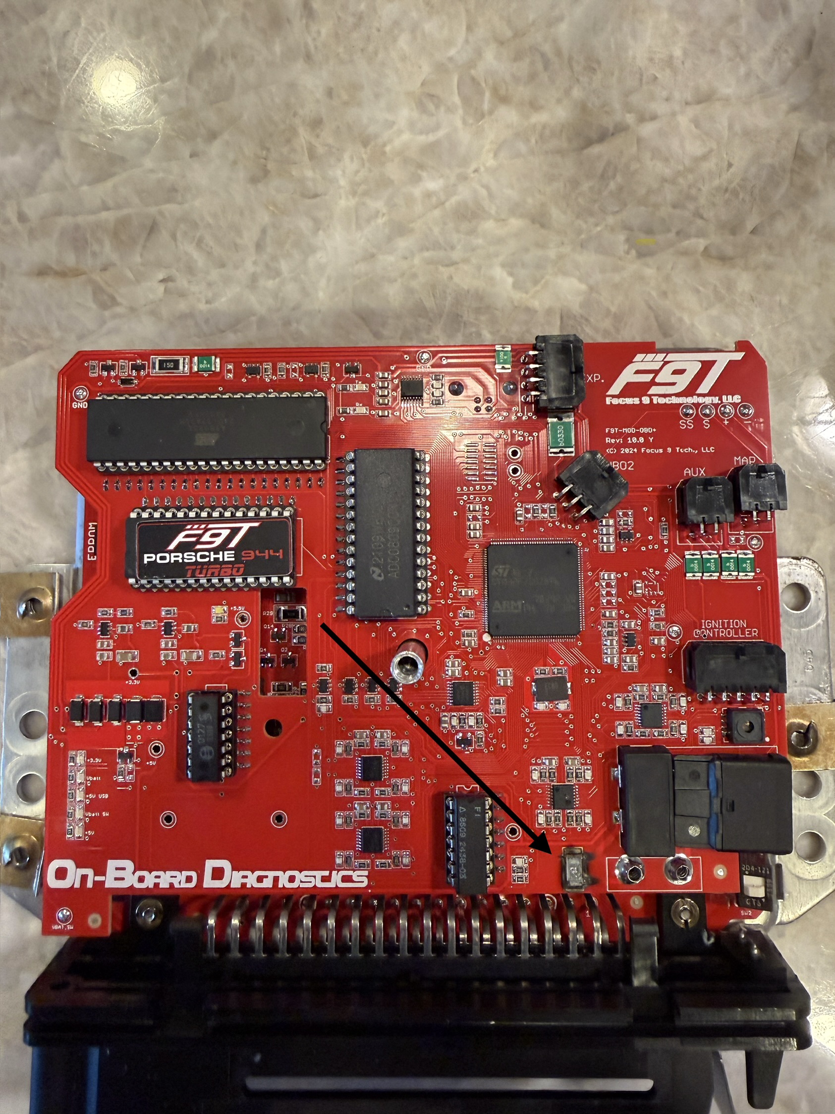

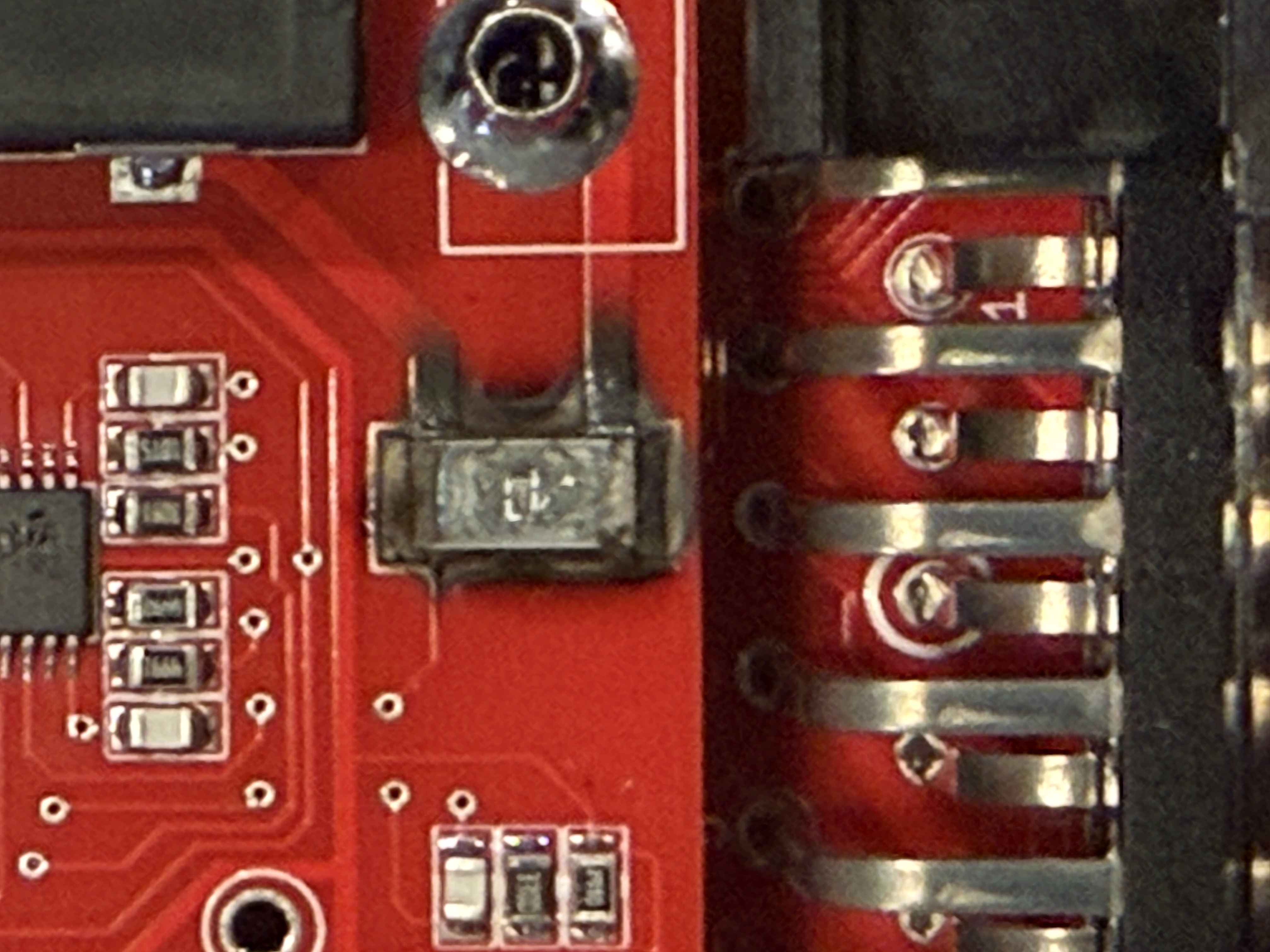

After following everything Tom wrote and everything checking out good I took the DME out and opened it up and found something burnt. Going to send it back to F9T and have him fix it and see if he can tell me how this could have happened. Was it something on the new Kroon harness that I need to check before plugging in the repaired DME

Can you post a close up of the burned component? Might be able to see what it is/was... I'd be surprised if the Kroon harness weren't perfect, but I would check that bulkhead connector over the brake booster to make sure all the pins and wires seem right. If I get a chance I'll pull my F9 DME and see if I can figure out what burned on yours -- that may narrow down the hunt for what caused that.... Sorry this happened but at least you found it and can get back on track to fire up that motor. (Gives you plenty of time to ensure you've built oil pressure... :angel: )

Sorry I wasn’t clear on that. All wires ohmed out good and I did make sure none of the wires were going to ground. After all the checks still no pulse on the green coil wire so that when I opened up the DME
Something definitely shorted out on you. That looks like a surface mount resistor, although it's impossible to tell for sure now. Surprised they don't have components labeled in the PCB silk screen. Curious to hear what the Focus 9 guys have to say. Probably safe to say that's part of the ignition circuit.
My bets are on install error, unfortunately, not the harness. Power was on the F9 at some point and a wire was grounded (or powered) inadvertently. No shame in that. We have all been there.
