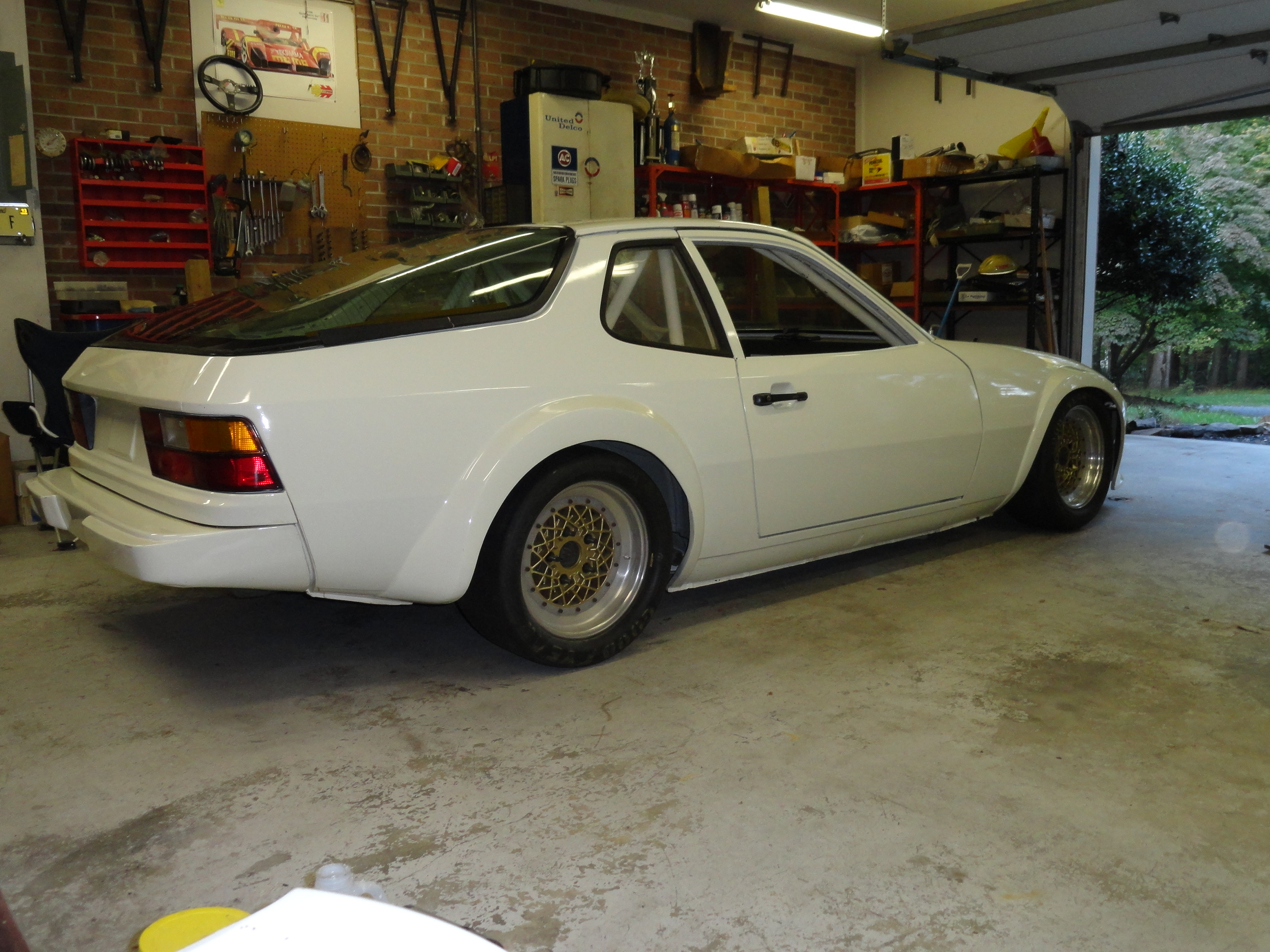

Here's a 933 assembled, but never run:

$150-$200k is some serious money right there! Are there vintage racing classes where these are still highly competitive? Otherwise that's 'real fan' money they're asking. Bet they were a ton of fun to drive. Very light and responsive with some decent power to weight ratio going on there.
