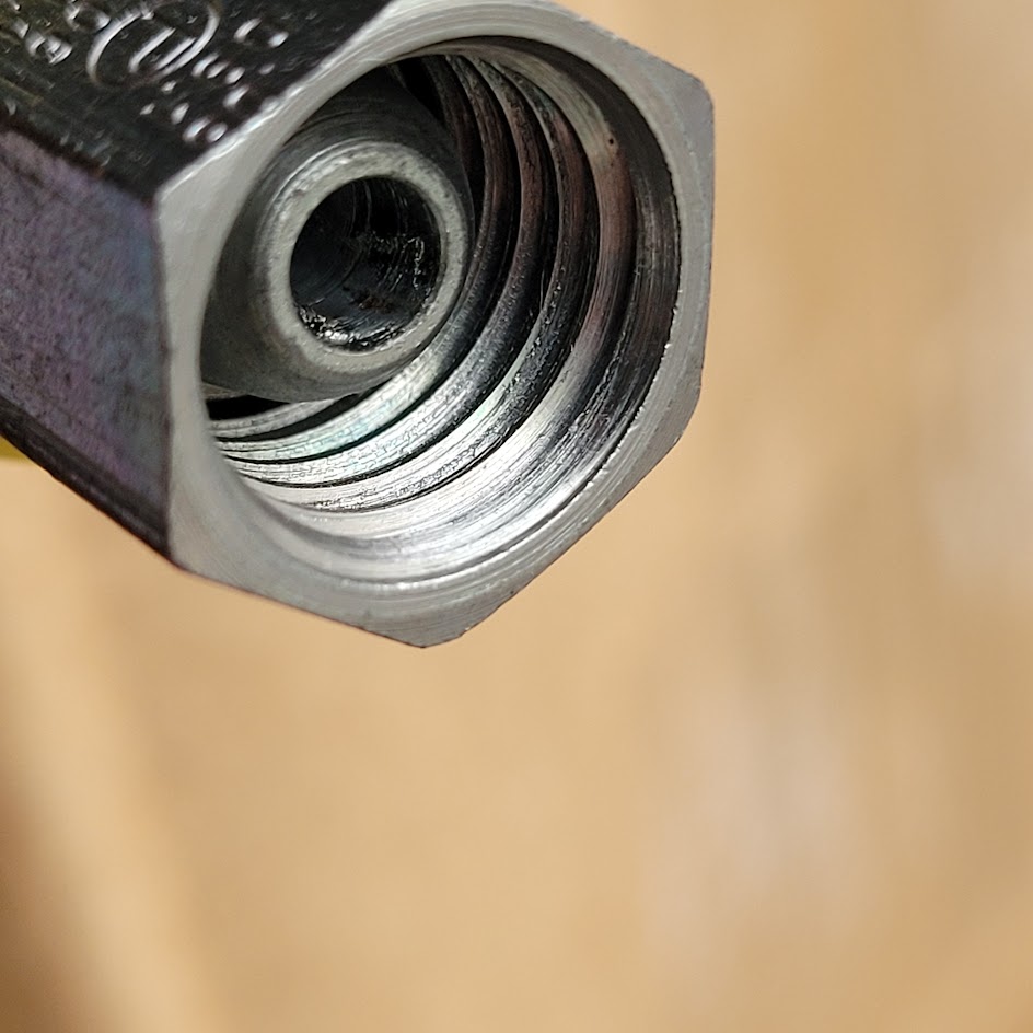

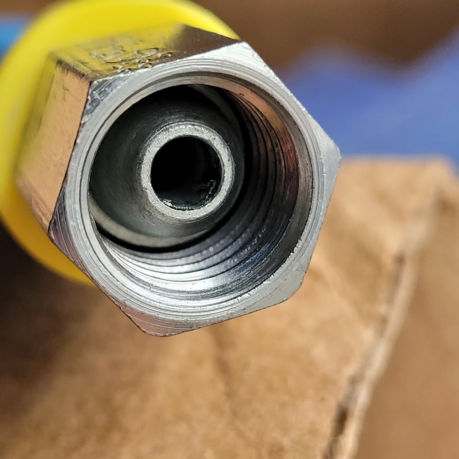

For what it's worth, the stock fuel rail is supposed to have a kind of spherical seal (like the ball bearing that's under the stock cap). I've heard it described as a "globe seal". The Arnnworx pressure tester I have has the perfect fitting but I don't think I've ever seen one anywhere else. I wouldn't trust anything else personally, although I am probably just paranoid.
I'll post a pic when I get a chance.

johnb
Posts: 320
Joined: Thu Jul 08, 2021 5:57 am
Has thanked: 110 times
Been thanked: 78 times
It's hard to get a clear pic but hopefully these will show it clearly - this is what you want to get a perfect seal on the stock fuel rail:
