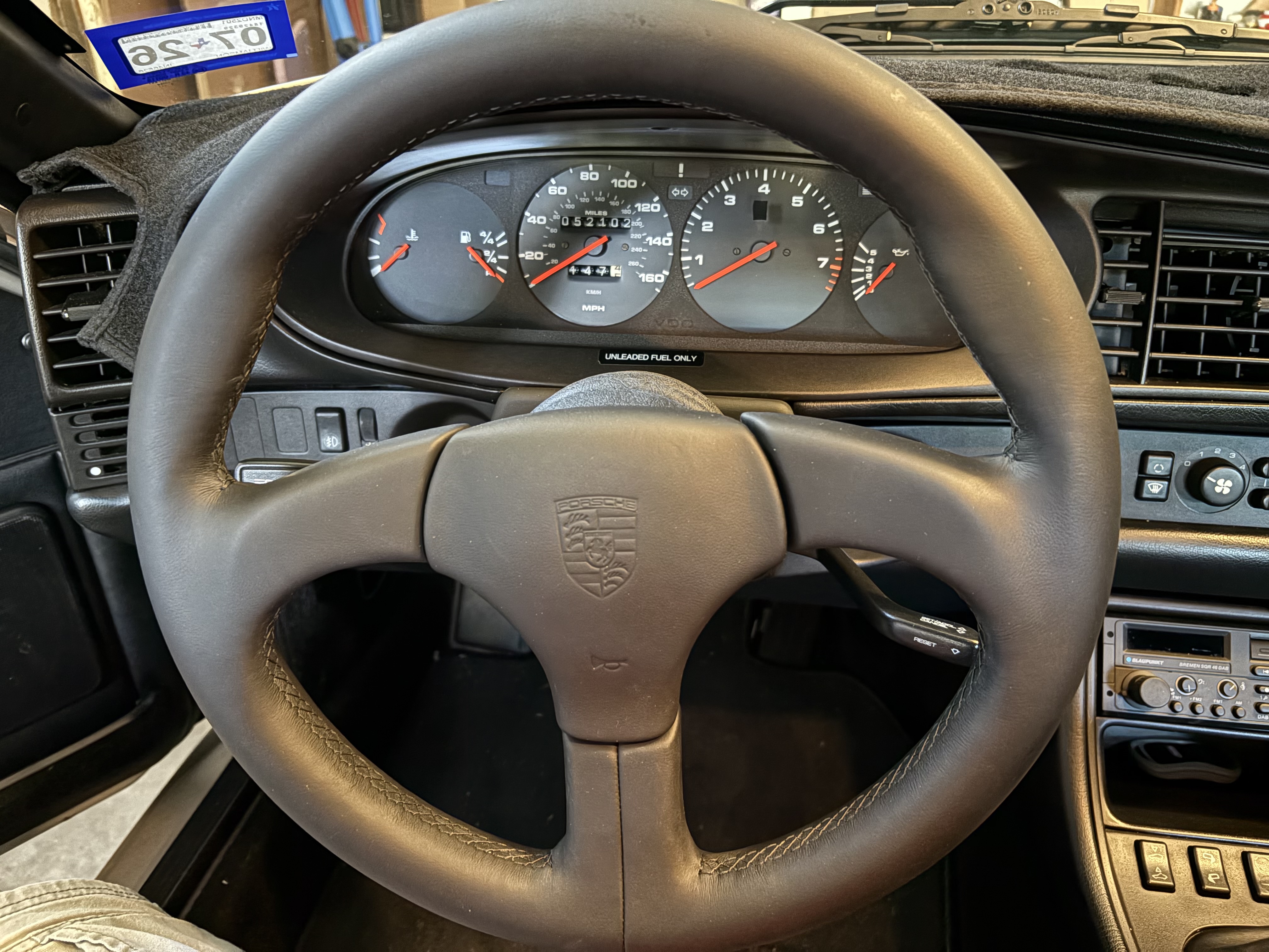

Yeah, if eliminating the airbag there are a ton of easy options, and I agree I like the esthetic of a fully padded wheel like the clubsport or the Nardi Gara. That's a pretty straightforward swap, but on a street driven car with a 3 point seat-belt it feels irresponsible to lose the airbag. The look and feel of my wheel aren't more important to me than my safety.
That's the entire point of this tutorial, because there are multiple threads across various websites talking about how to swap out a non-airbag wheel. This is one of only two or three that talks about putting in a newer airbag wheel into our airbag equipped cars and the only complete tutorial remaining for this particular wheel into our cars. I feel the same way about the Clubsport wheels. I like them, they look good, but I feel it's taking something away from my car if I go "backwards" in that regard. Not to mention if I ever move back to the US I don't know how they'll look at that issue.
