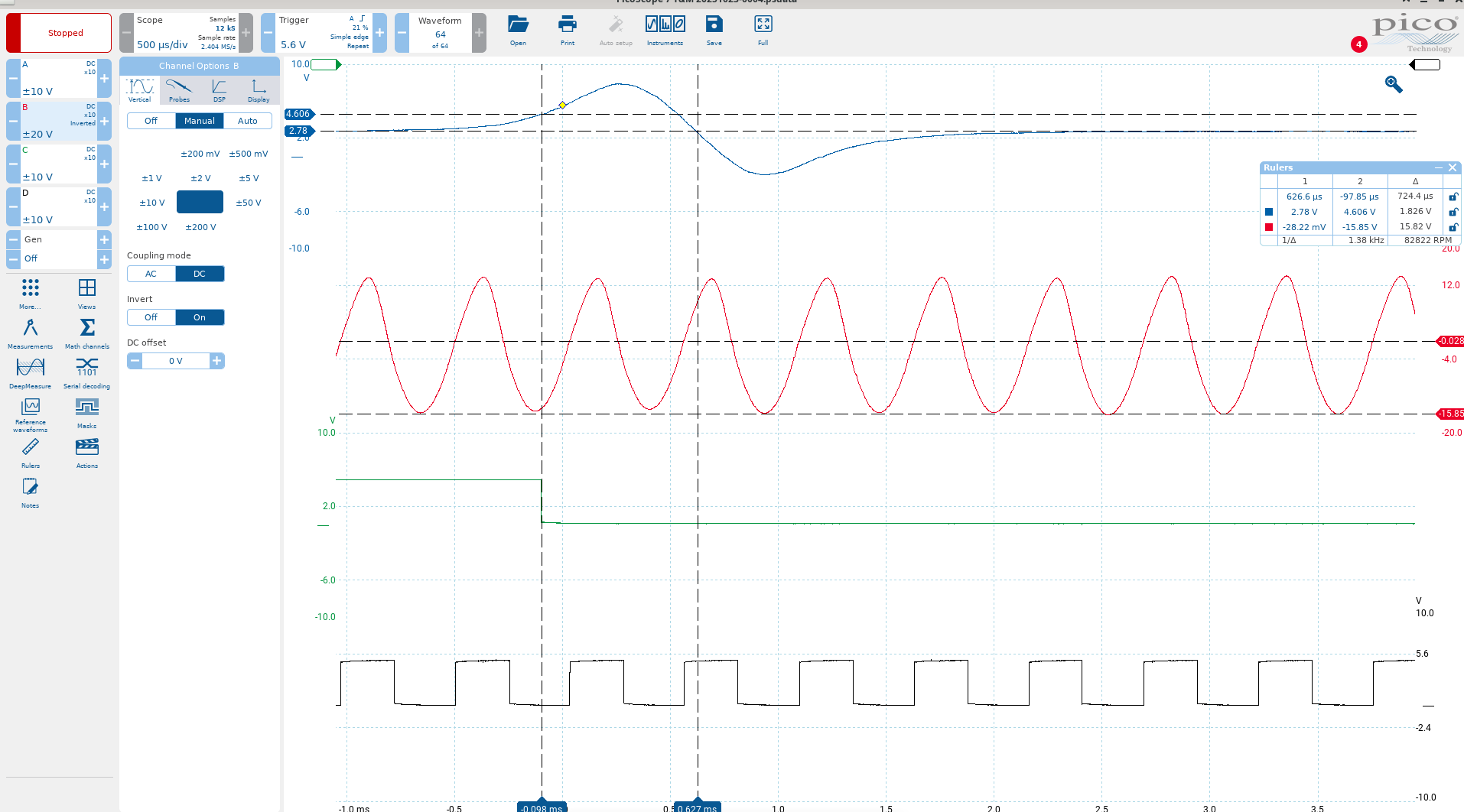

Do they both trigger at 40% of peak or just the ref sensor? Or is that what you mean about the phase relationship staying the same (i.e., both triggering at 40%)?
Good question - it's hard to tell! The speed sensor pulses are triggered at the 40% threshold on one side and exactly at the zero-crossing on the other side. But I can't tell which side is which because it's a differential signal and I'm not sure which side I should be looking at! With the ref sensor it's easy - if you probe one end and you see it going negative first, you're looking at the wrong end. But the speed sensor is there all the time so it's harder to tell if it went positive or negative first. In theory I might be able to catch it at the start with a slow time base, maybe I'll try that.Tom wrote: Sun Oct 26, 2025 1:08 pmThat old thread reminds me I still have the speed and ref sensor test board, with flywheel and ring gear, so will drag that out later this afternoon and take a look. Interesting to see way back then we had speculated about the trigger point not being at the zero crossing point...johnb wrote: Sun Oct 26, 2025 11:54 am After a little more digging, my tentative prediction is that it's possible to have the ring gear 2 different ways. That would make the code I'm looking at make the most sense.
With that said my best guess currently is that for the speed sensor, the rising edge of the digital pulse is the zero crossing and the falling edge uses the 40% threshold.
In these images the speed sensor (red channel) is inverted in the software, which is how I think it should be.
Green is the ref sensor digital pulse at the 8051 INT0 pin. It's inverted after the S100 before the 8051. Falling edges trigger the 8051 interrupts for both signals. Note how the ref sensor pulse is right in the middle of the low part of the speed sensor pulse - I verified that it stays like this as engine speed increases. But the code handles the case where the speed sensor signal is high at this moment, by delaying ignition for an extra half-tooth. So presumably such a condition is possible on some cars.

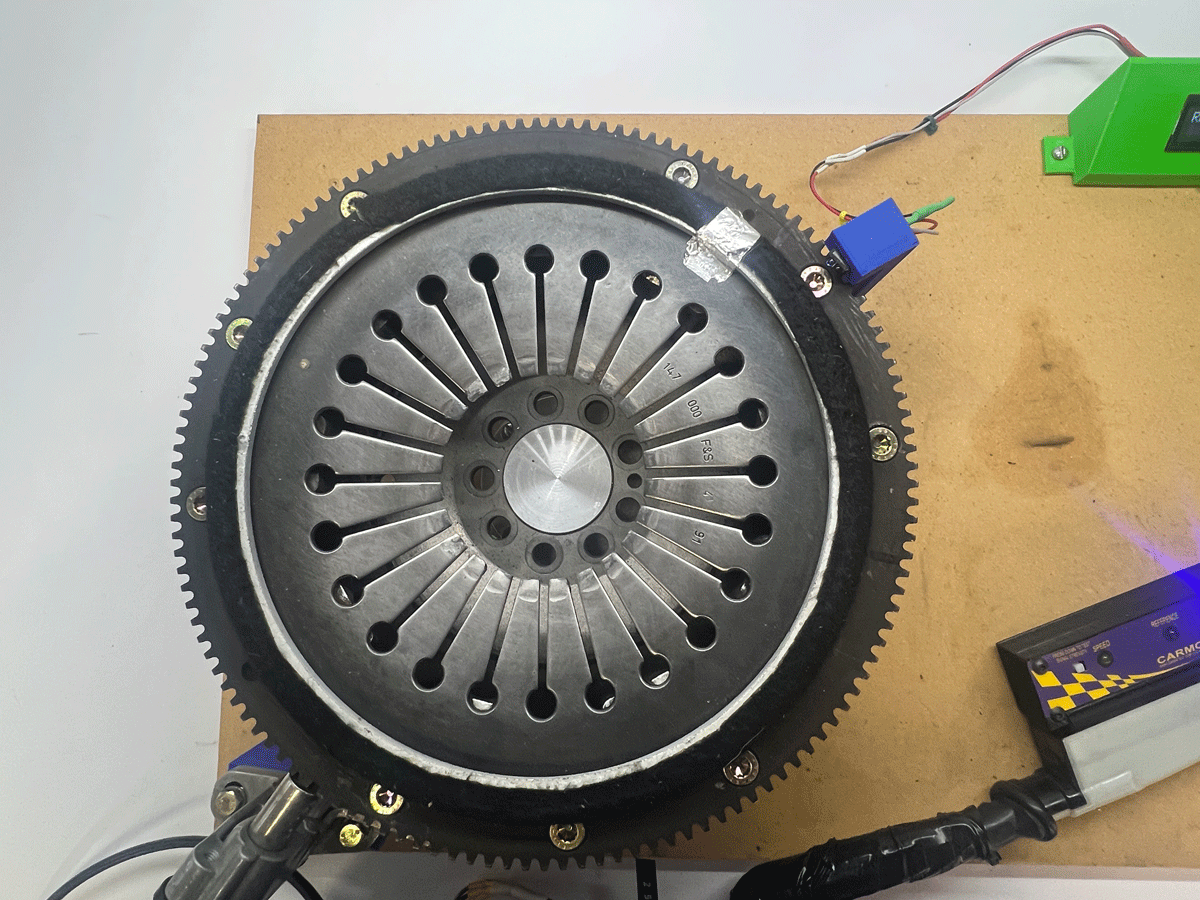

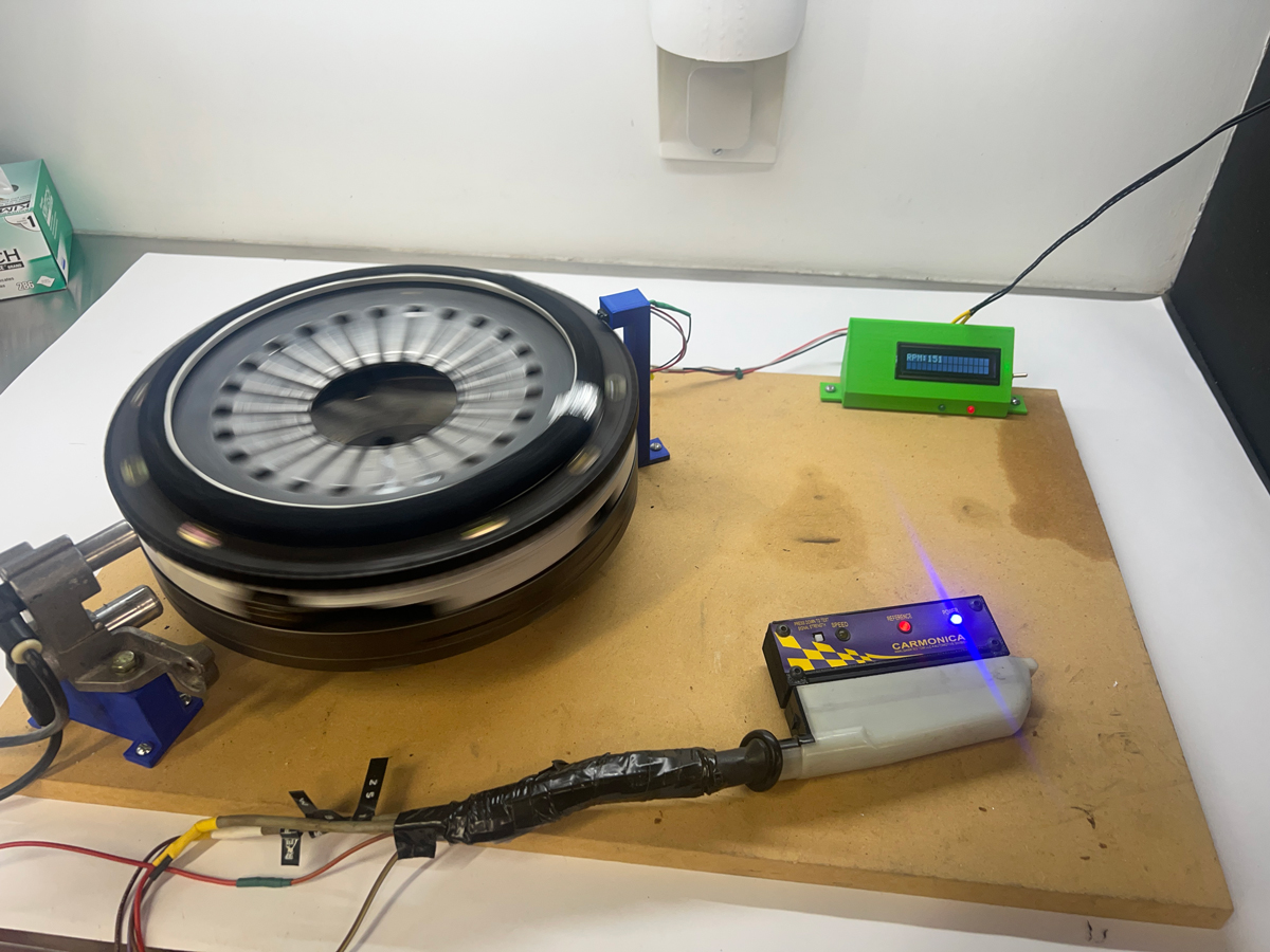

I got my test rig out and checked the ring gear. It has three sets of three identical bolt holes -- meaning the ring lines up with the holes in any of three positions. Looking closely, however, I think all the teeth still end up in the exact same place regardless. The turbo has 132 teeth, though, which is divisible by 3, so it's possible the teeth get shifted some on non-turbo cars depending on how its clocked (or they do more to key it)? If I can do anything helpful with my test rig, let me know.

When you ask how the screw lines up -- you mean the relationship between the ref sensor pin and the ring gear teeth? Other than accommodating other models, nothing obvious comes to mind about the half-tooth delay. The phase seems to be fixed by the hardware, so I can't think up an scenario where it would change on a running car...? I'll have to read your write up to understand the other quirks you mention...
On the test rig, I was just trying to get a better handle on the speed and ref signals, and used it to help make the Carmonica (i.e., a little test light for the signals). But in the process I stumbled across a little phantom pulse generated by the diagnostic pin, which could explain some of the starter kick-back issues...
