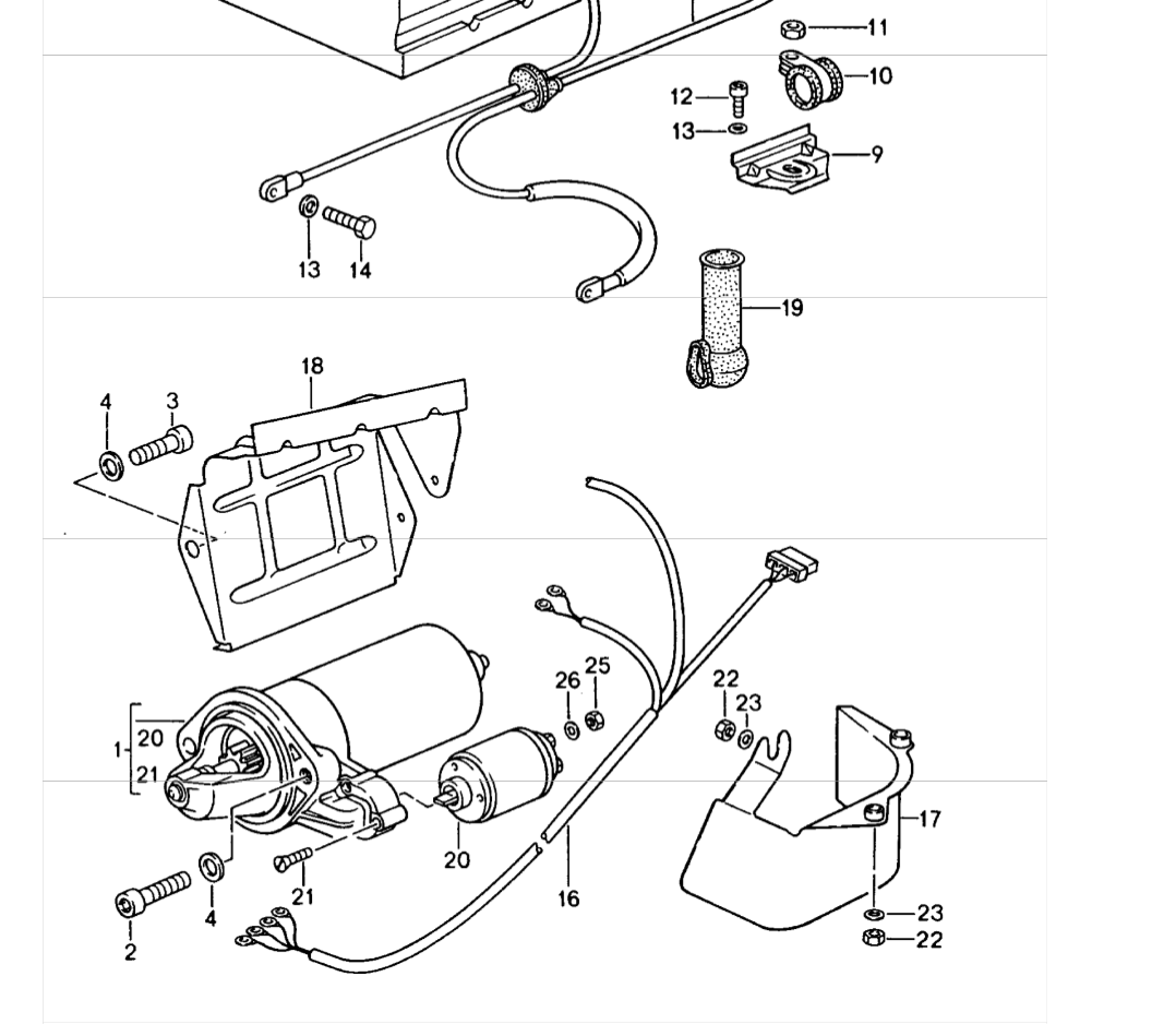

On some of the (later?) cars there is a rubber boot over the main feed to the starter, which may have been added to reduce the chance of a short.
Screenshot 2025-07-16 at 19.12.04.png (247.31 KiB) Viewed 191 times
item 19
part number 999 659 006 50
I'm planning to put one on my car when all that is connected up again.
