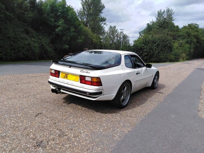

The hockey sticks can become detached along the way, so it's advisable to cable tie them on. It's actually a double spoiler, as there's a small flap on the bottom of the glass.
