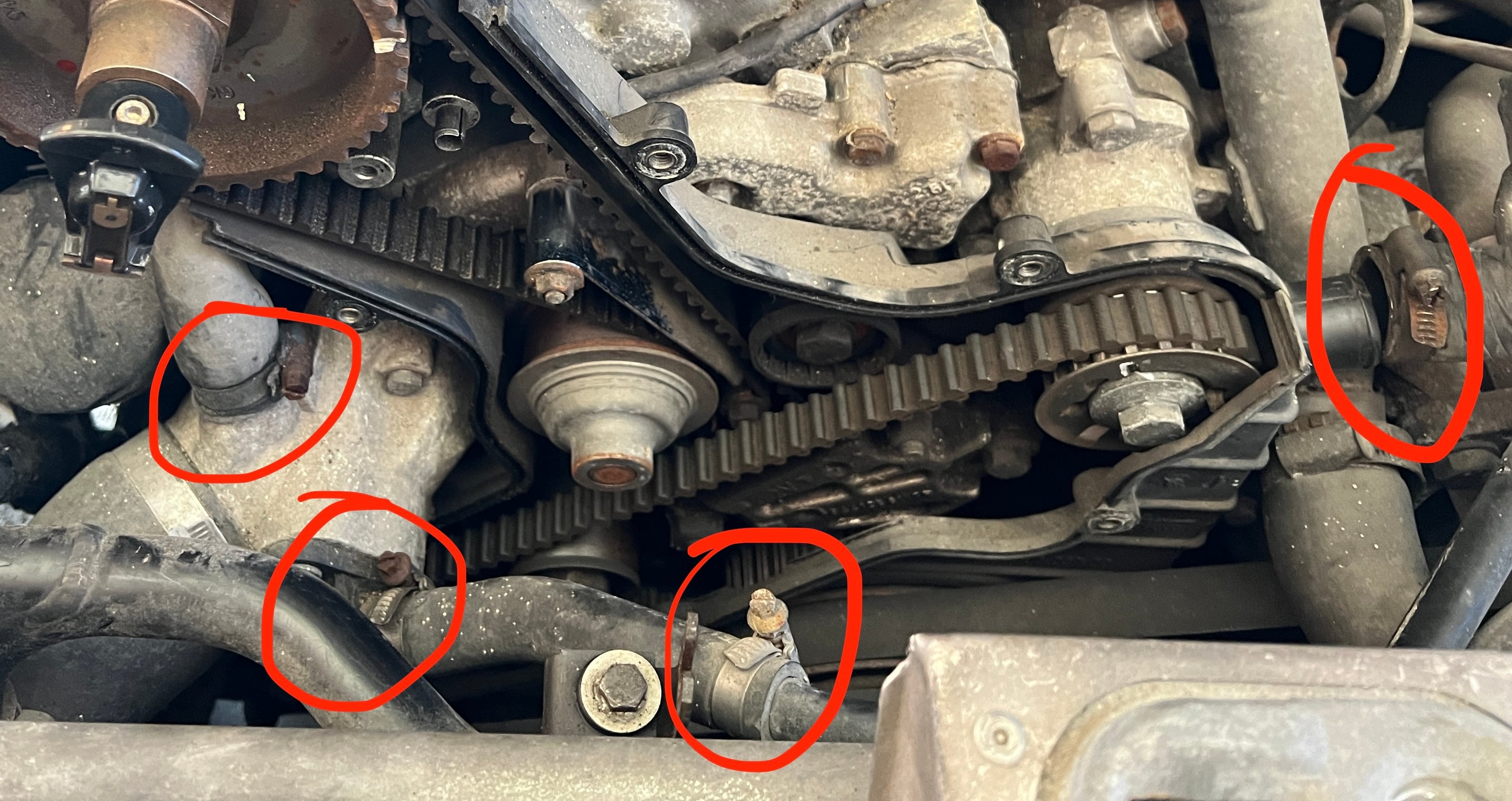

As I am sorting through the new-to-me car, I want to replace all the corroded-looking hose clamps (among many bits!) in my engine bay.
Bel-Metric seems like a good site for good prices and quality with the OEM looking yellow-zinc.
The 944 parts catalog just lists the part number and "Hose clamp". No sizing.
Can anyone give me an easy method of measurement of each hose-clamp so I can make a list of the correct sizes before ordering?
Thanks.
See examples of condition.

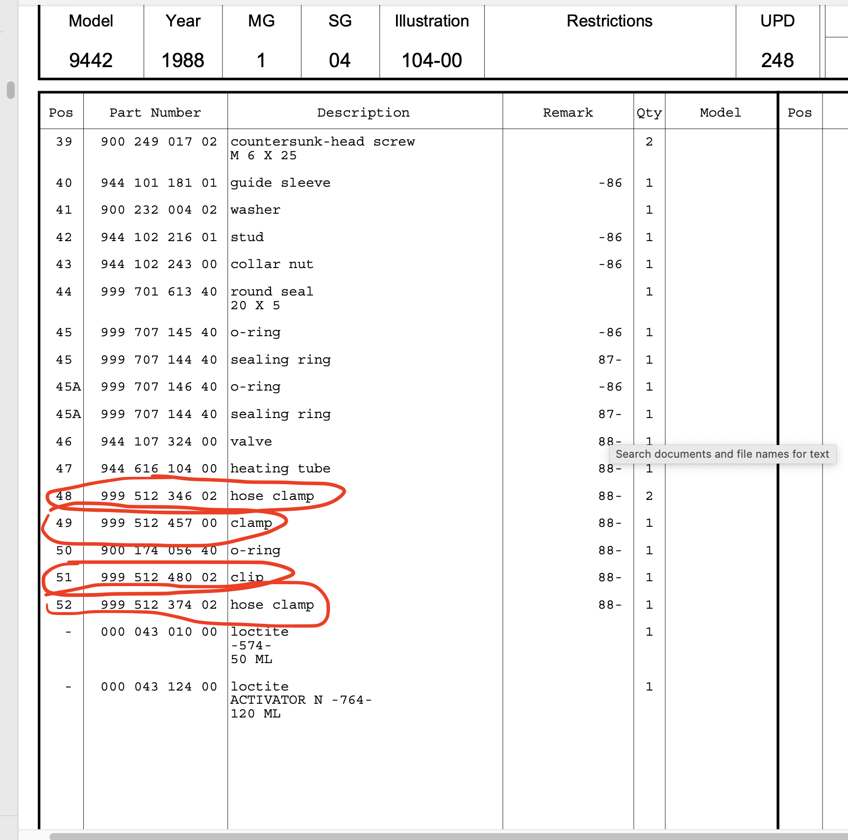

Ajay213 wrote: Sun Mar 03, 2024 10:47 am The Porsche PET for the car has a list of every (replaceable) part in the car. So every bolt size, washer size, nut size, clamp size, etc. Includes the original part number, so if you ever have a hard-to-find part you can look it up as well - quite a lot of the small parts are still available from Porsche (but you pay for it compared to Bel Metric and others). I'm not sure if that is what you meant by the '944 parts catalog'?
This has a few of the PET catalogs, you need it for your year of car, and it will have all 944 types for the model year.
https://www.9xxteile.com/en/pet (hope it's ok to post a link like this). You can find them still on Porsche's website, but it takes 900 clicks in order to find them.
For instance, the clamp on my car (which isn't a turbo, different year, etc) from the heater core to the water pump says;
Hose clamp 23 - 35 - Qty 4
Yes, I have a PET. (And thanks for the link!)
But for example, the hose clamps on this page (# 48, 49, 51, 52) are all listed as "hose clamp", or "clamp" in the PET with no sizes.
I have tried to cross-reference the part number online and found some links with sizes, but was hoping for a faster more efficient method to do a bulk order from Bel-Metric. (The dealer web-pages for the parts do not list sizes unfortunately.)
