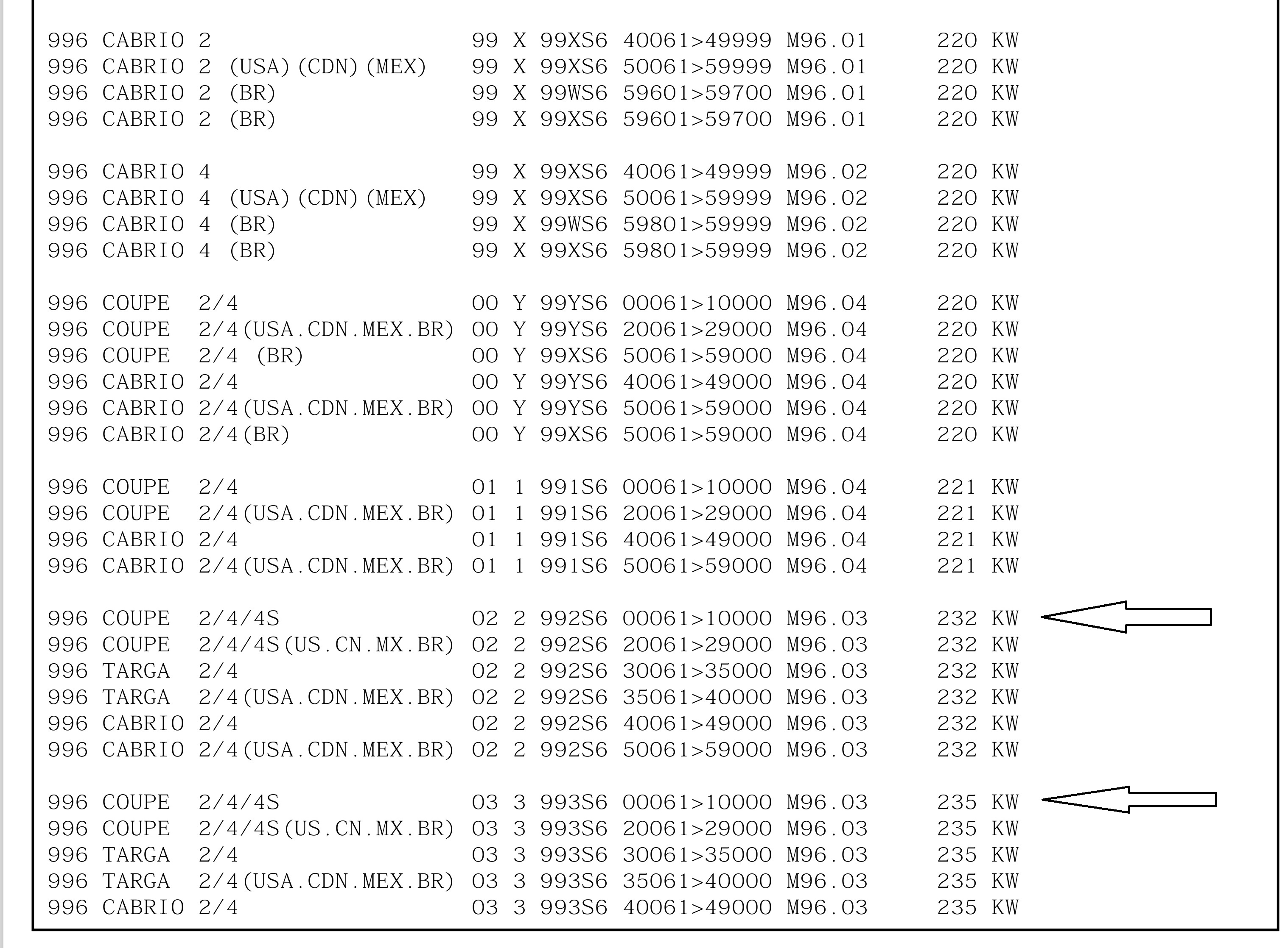

Ok, I see the discrepancies now. Can't really explain why some sites list it as 315 (or 316) rather than 320, but suspect it is not a coincidence that 320 metric horsepower (PS) is equal to 315.52 imperial horsepower (HP). Porsche itself just says 320PS for '02 - '4 on its site (at least for models where it lists a horsepower rating -- targa, C4, etc.). So, I'd be all ready to chalk it up to metric vs. imperial HP, but Porsche itself adds to the confusion by listing the M96.03 motor with slightly different KW levels in its parts catalog (232KW for the '02, and 235KW for the '03, which translates to 315.4 metric horsepower, and 319.5 metric horsepower, respectively). Since the sales brochures and Porsche's current website list 320PS for all '02 to '04 (as far as I could see anyway), my pure guess would be that the engineering department and marketing department didn't compare memos and created the confusion. Rated horsepower numbers are as much art as science, so again just a guess but this could be just a rating update by the engineers for the same M96.03 motor, whereas the official (advertised) rating was always 320PS. But that's just speculation.
From PET....
pet hp ratings.jpg (1.17 MiB) Viewed 1005 times

Tom wrote: Sun Feb 18, 2024 10:10 am Ok, I see the discrepancies now. Can't really explain why some sites list it as 315 (or 316) rather than 320, but suspect it is not a coincidence that 320 metric horsepower (PS) is equal to 315.52 imperial horsepower (HP). Porsche itself just says 320PS for '02 - '4 on its site (at least for models where it lists a horsepower rating -- targa, C4, etc.). So, I'd be all ready to chalk it up to metric vs. imperial HP, but Porsche itself adds to the confusion by listing the M96.03 motor with slightly different KW levels in its parts catalog (232KW for the '02, and 235KW for the '03, which translates to 315.4 metric horsepower, and 319.5 metric horsepower, respectively). Since the sales brochures and Porsche's current website list 320PS for all '02 to '04 (as far as I could see anyway), my pure guess would be that the engineering department and marketing department didn't compare memos and created the confusion. Rated horsepower numbers are as much art as science, so again just a guess but this could be just a rating update by the engineers for the same M96.03 motor, whereas the official (advertised) rating was always 320PS. But that's just speculation.
From PET....
