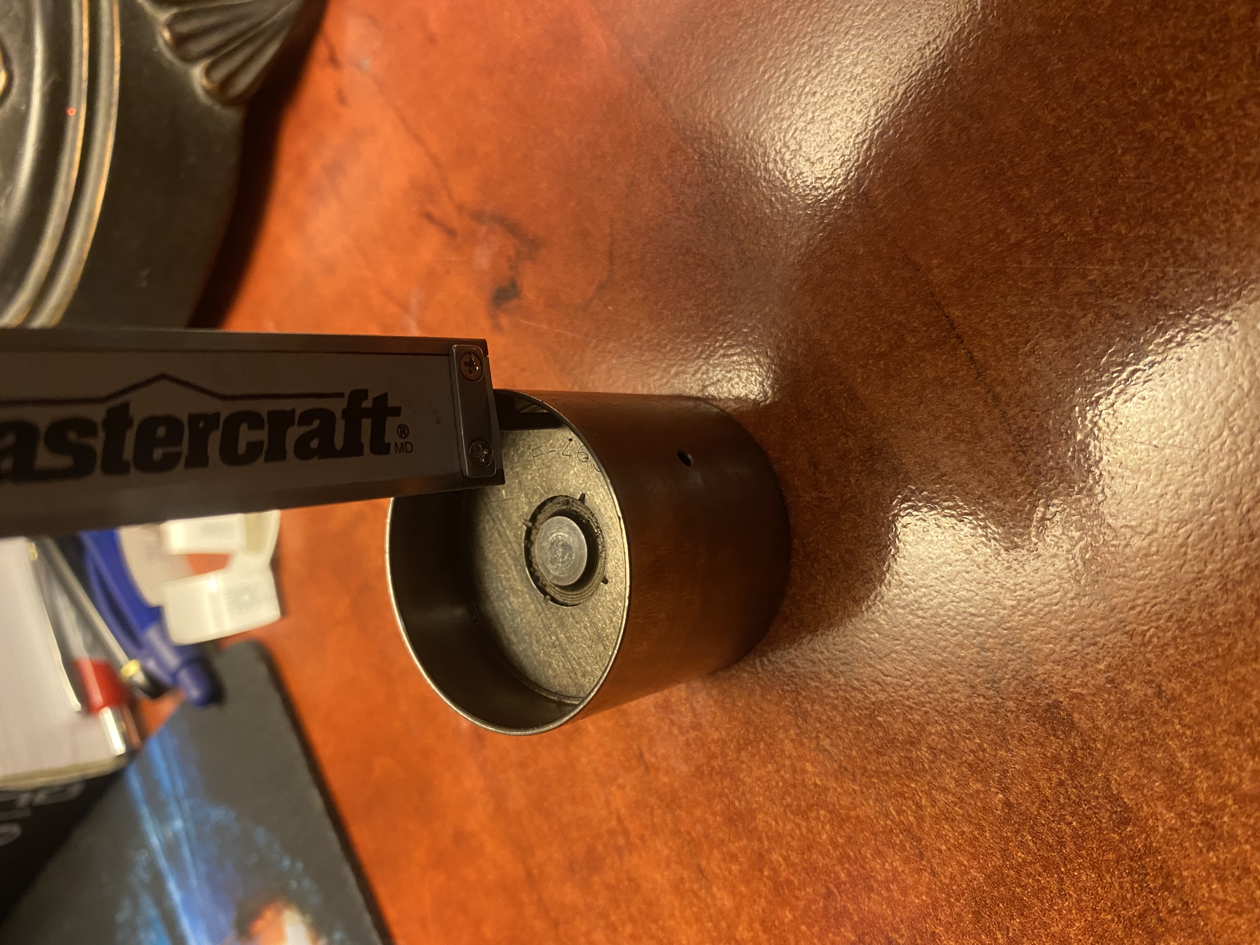

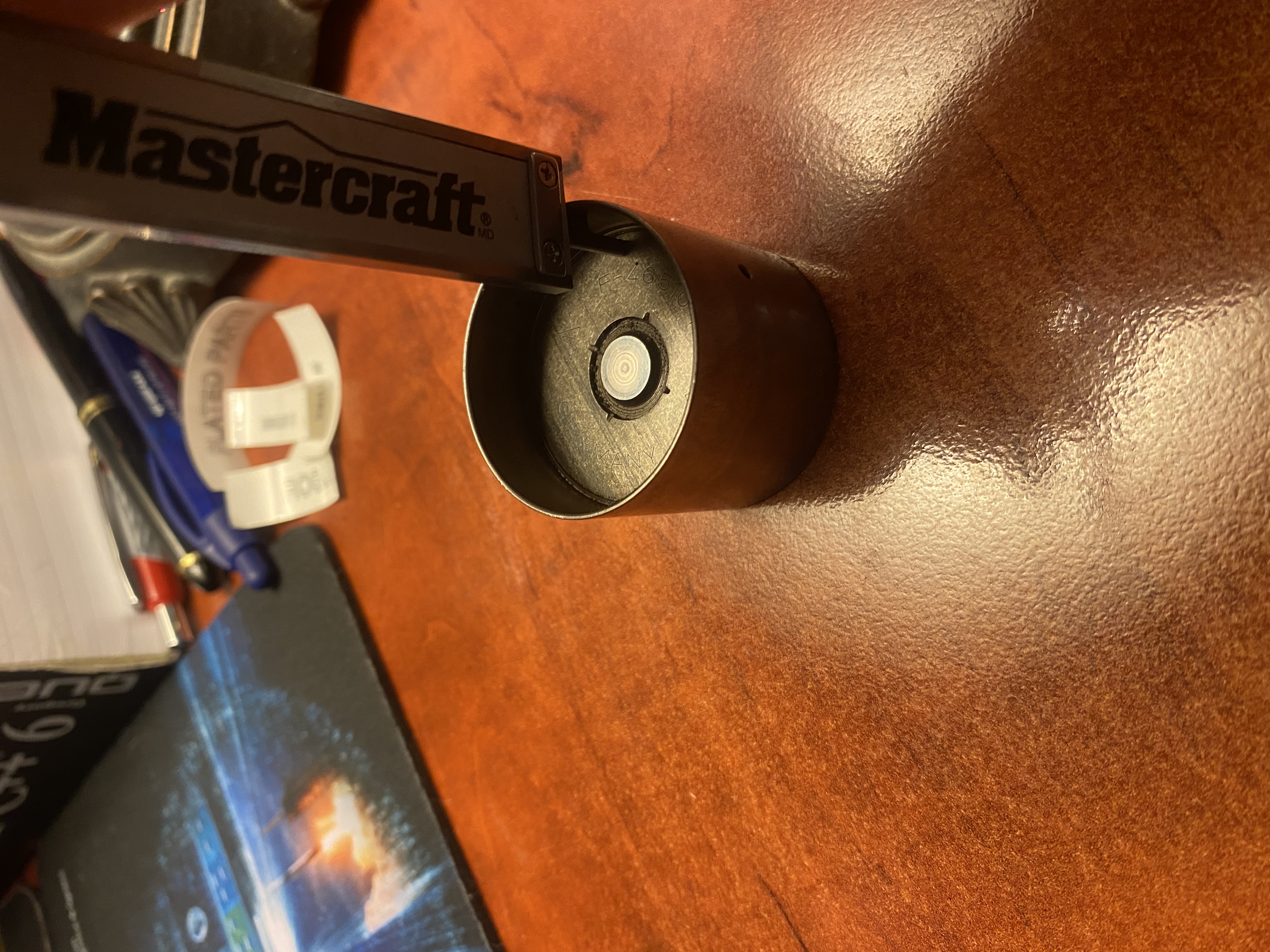

I measured my lifters today.
I know they are 38mm diameter.
I also measured 32mm height
Inside wall 11.40mm
Button height 0.55mm
Thickness. 32mm - 11.40mm + 0.55mm
Can everyone who can measure to see what you get?
Thanks

Just regular old 8-valve lifters you mean? I can measure those in the morning if so.... What are you trying to figure out?
