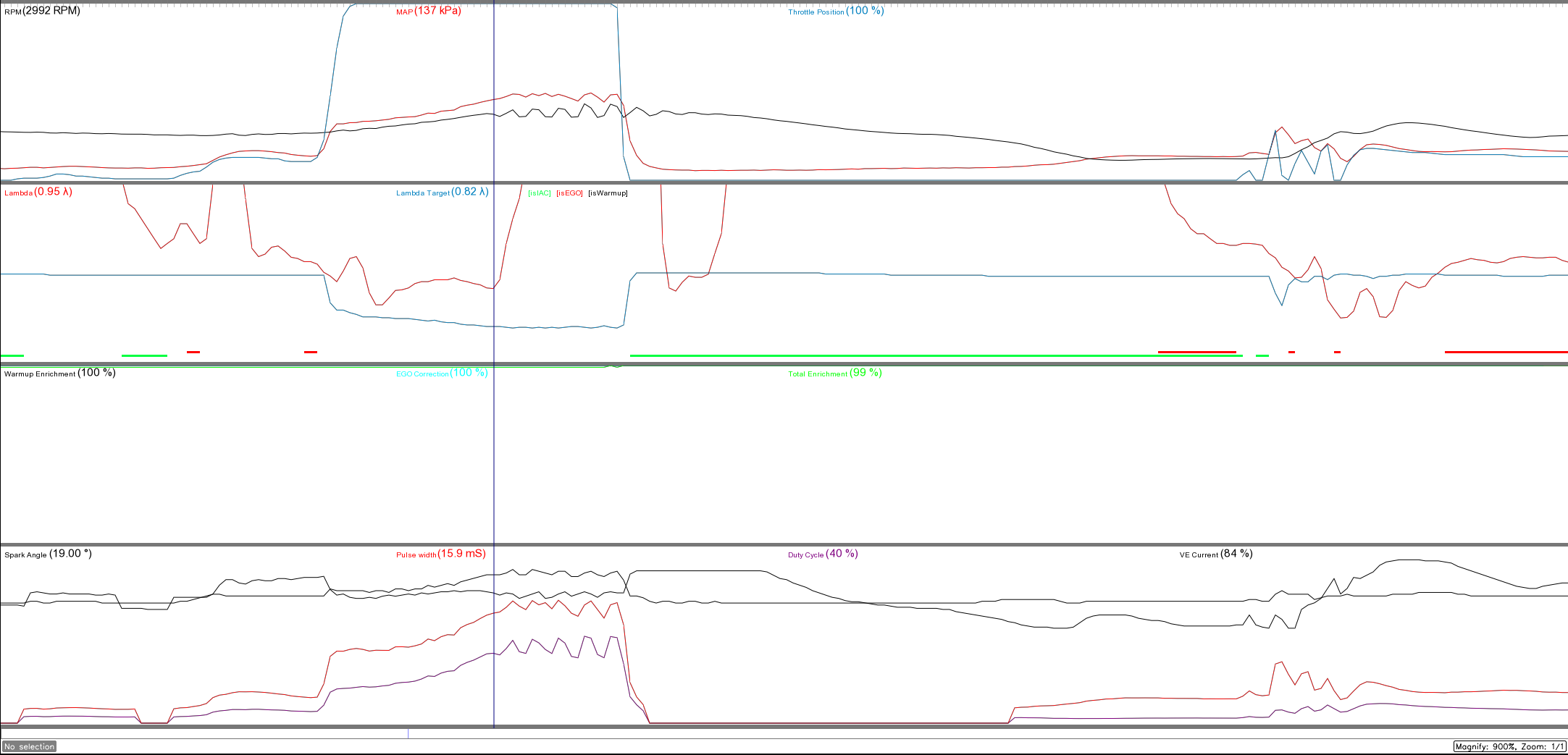

That sounded plausible, but logging shows that it goes completely lean - I should've mentioned that it doesn't just feel like a fuel cut, it looks like one too! The event starts at the cursor in this picture:

Thanks for attaching the log graph. If it were actual fuel cut, the injector PW would drop to zero.
The odd thing about misfires is that it leaves unburned oxygen in the exhaust, so the O2 sensor reads a lean condition.
Another sign that it might be a rich misfire is that the AFR is trending downward (richer), then it spikes lean while the injector PW keeps increasing, and kpa is relatively level. Your target lambda looks good, it's not too rich, so there might be something else going on, such as a weak spark due to a weak coil, overly large plug gap, bad wires, worn cap/rotor. Or not enough dwell time in the settings.

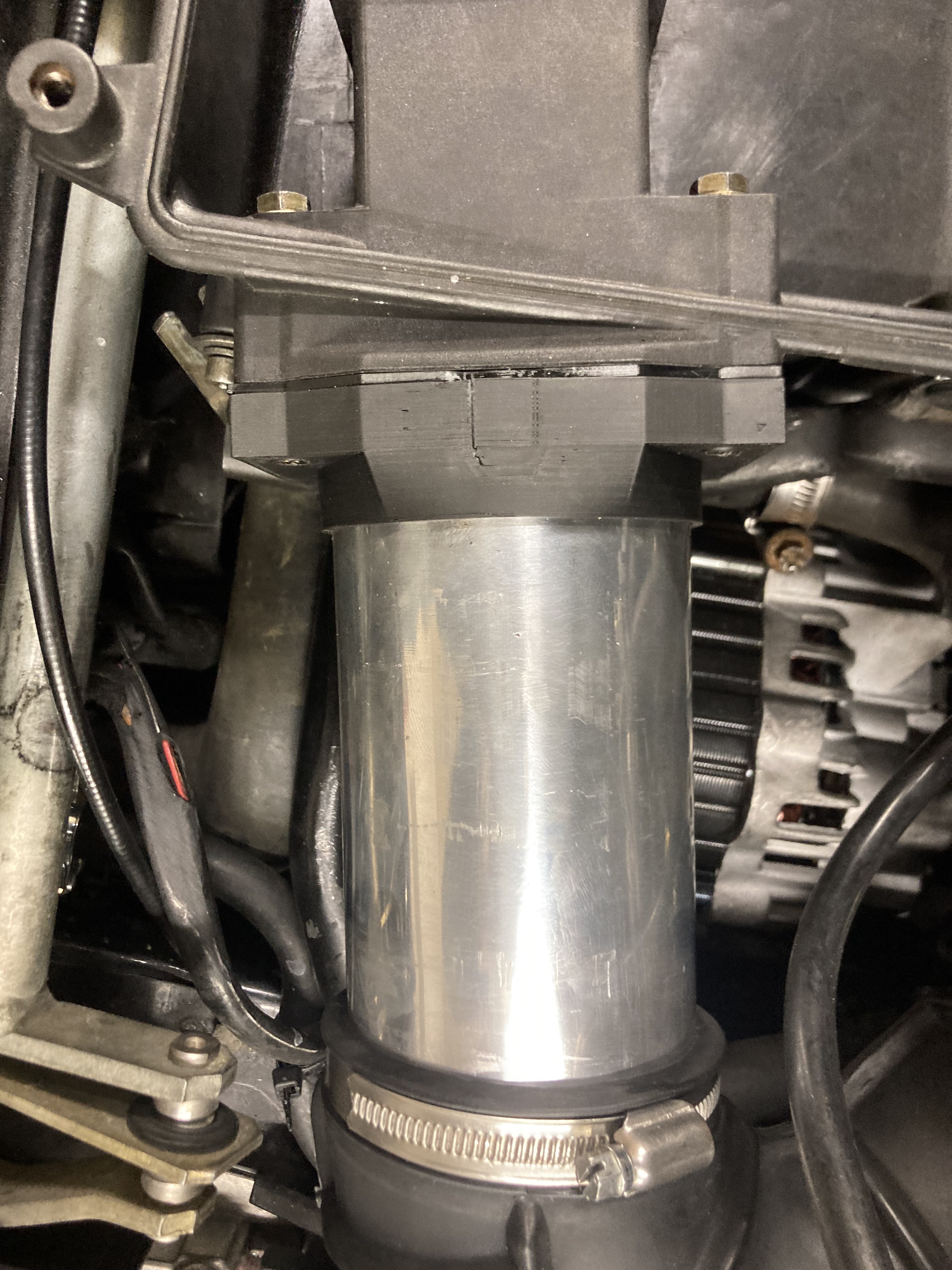

Also redesigned by AFM delete such that no printed plastic is in the airflow (not that I think it was a risk): The 3" tube bottoms out against the airbox opening, and is just held in place by this printed adapter. Found 12" of bead-rolled 3" tubing on Amazon and cut it in about half. TPU forms the gasket. One remaining concern is the bolts loosening over time (they go into brass heat inserts) - I'll fix that by adding maybe 5mm longer bolts drilled for safety wire.
I'm happy to leave this for now though - the next sendcutsend order will probably contain an aluminum version meant for the other half of that 3" pipe, plus a bracket to mount the coils and boost control solenoid where the cruise control was.

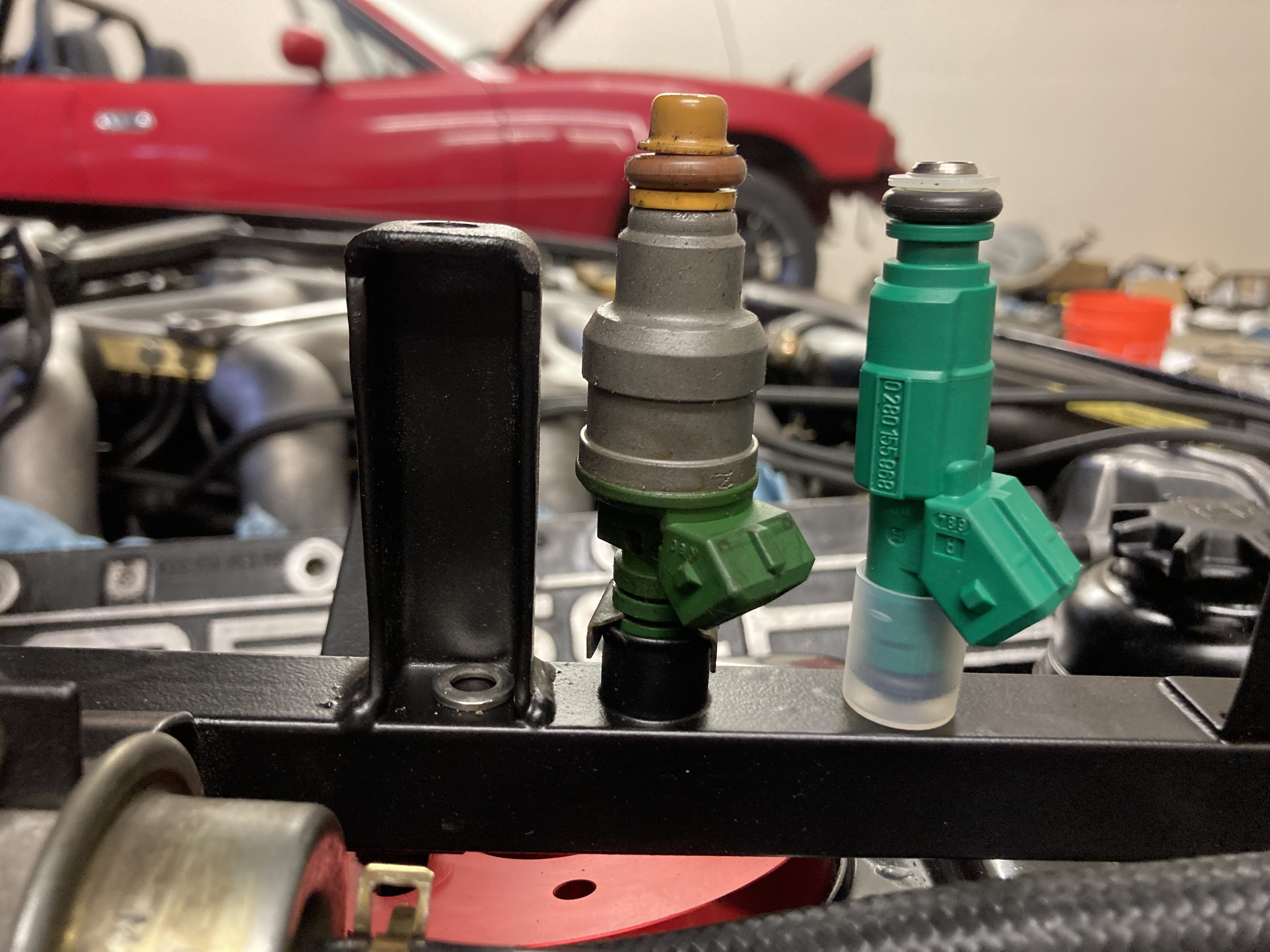

Edit the second: threw new NGK plugs (such a cargo cult!) in and a 3 bar FPR I had sitting around along with some new Bosch 0280155968 ("Green Giant"?) injectors:

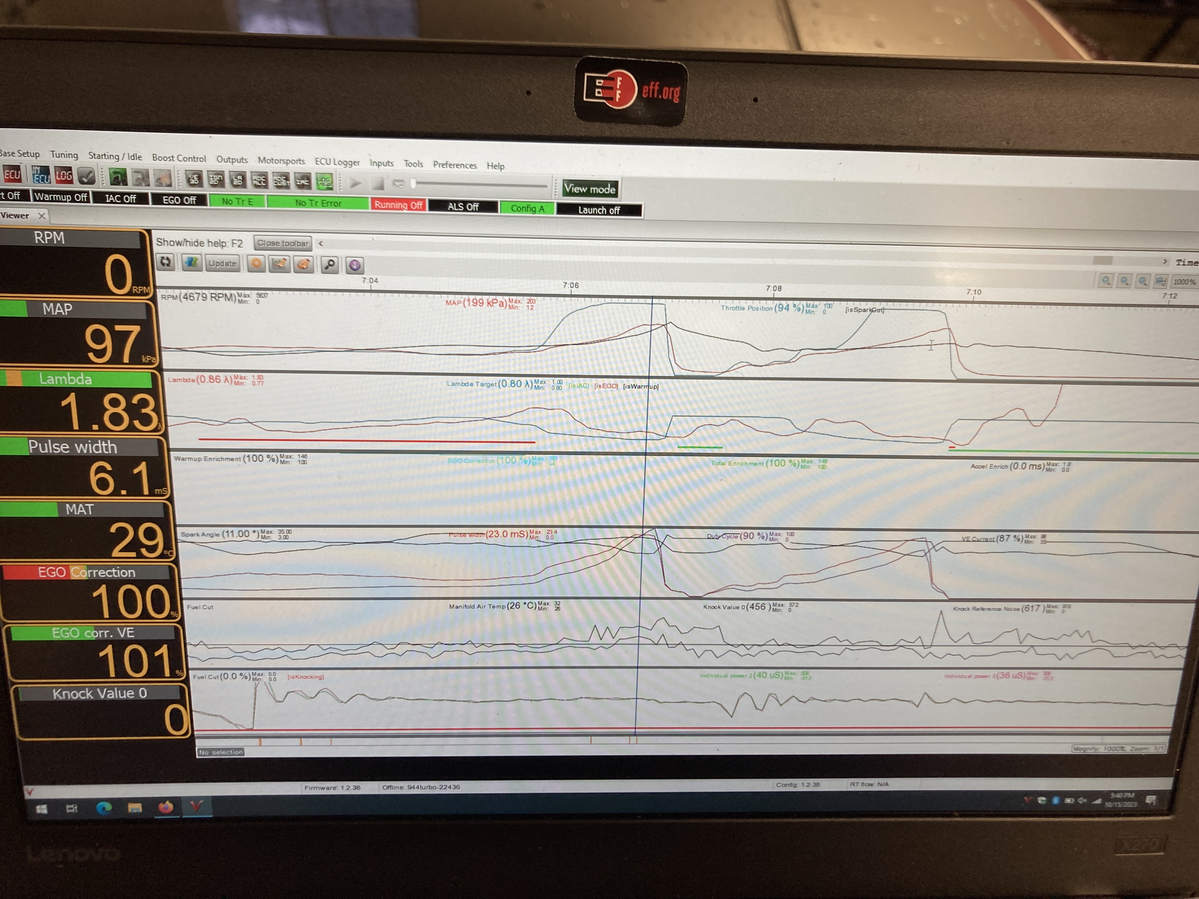

I was lazy and didn't bother to try just the plugs or just the high-Z injectors, but VEMS runs awesome now. Low/no throttle manners are just ridiculously good:
