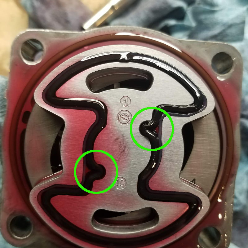

While I had the reservoir removed (and the fluid drained), I took the opportunity to inspect the internals of the PS pump. I had replaced the seals in 2018 and posted about a "groan after rebuild" on RL. At that time I discovered that the new hourglass-shaped seal had been sucked toward the little openings.
The same was true now in 2023 (circled here in green)...

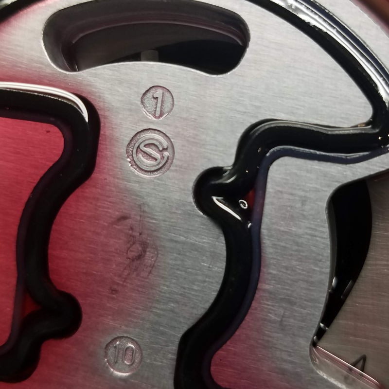

This is how it's supposed to sit.

The PS pump is currently quiet and operating normally. No leaks. No noise. Nothing unusual.
My working theory as to how this happened is this...
  • PS Reservoir has restricted flow due to gunk in the 250k mile filter
  • In lieu of a constant supply of fresh fluid, PS pump sucks the hourglass seal into the ports
  • Ports get blocked by seal further starving pump of fresh fluid
  • PS Pump groans
Anyone else have ideas?
and Wrench Warrior
Seattle, Washington, USA
Posts: 9091
Been thanked: 4078 times
Did you confirm the old reservoir was blocked/clogged? Pour a little fluid in and see if it flows out normally? If it was clogged, your theory sounds good to me...

Tom what do you think about a small 3D printed piece in there to keep the seal from doing that?
Make it shorter than the height of the channel, and fit in between that. Could keep the seal from collapsing.

stitch2k1 wrote: Sat Jul 29, 2023 7:40 am Make it shorter than the height of the channel, and fit in between that. Could keep the seal from collapsing.
I'm gonna try this. After a couple days of working properly and maybe 50 miles total, my pump started groaning again as I pulled into my driveway.
I'm gonna take the pump off the car again. I'm sure I'll find the hourglass seal sucked into the ports again.
I think there is enough clearance along the inside edge of that seal to slip a thin plastic strip, like the tail of a zip tie, in the areas adjacent to the two ports. I'm gonna try that.
