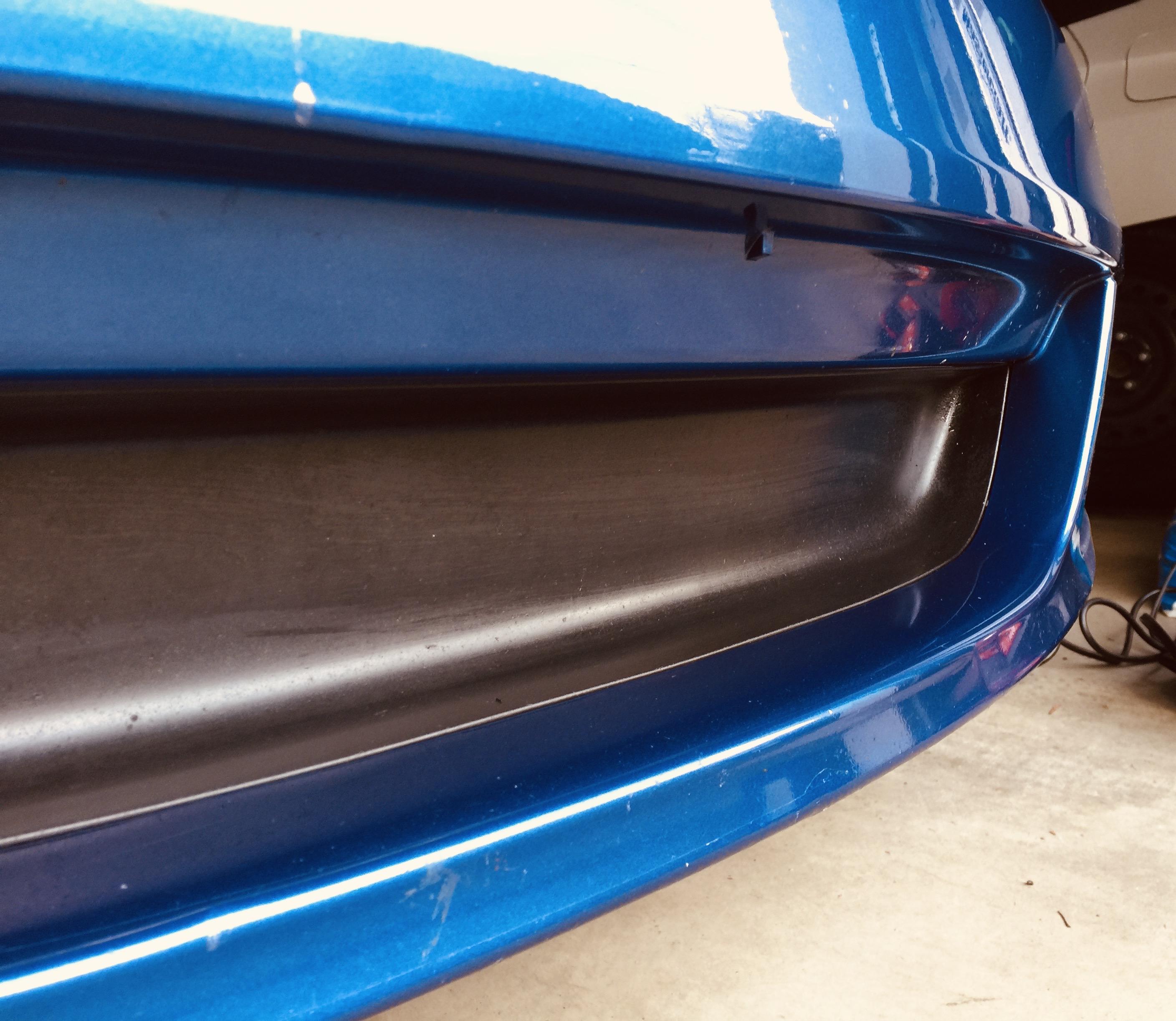

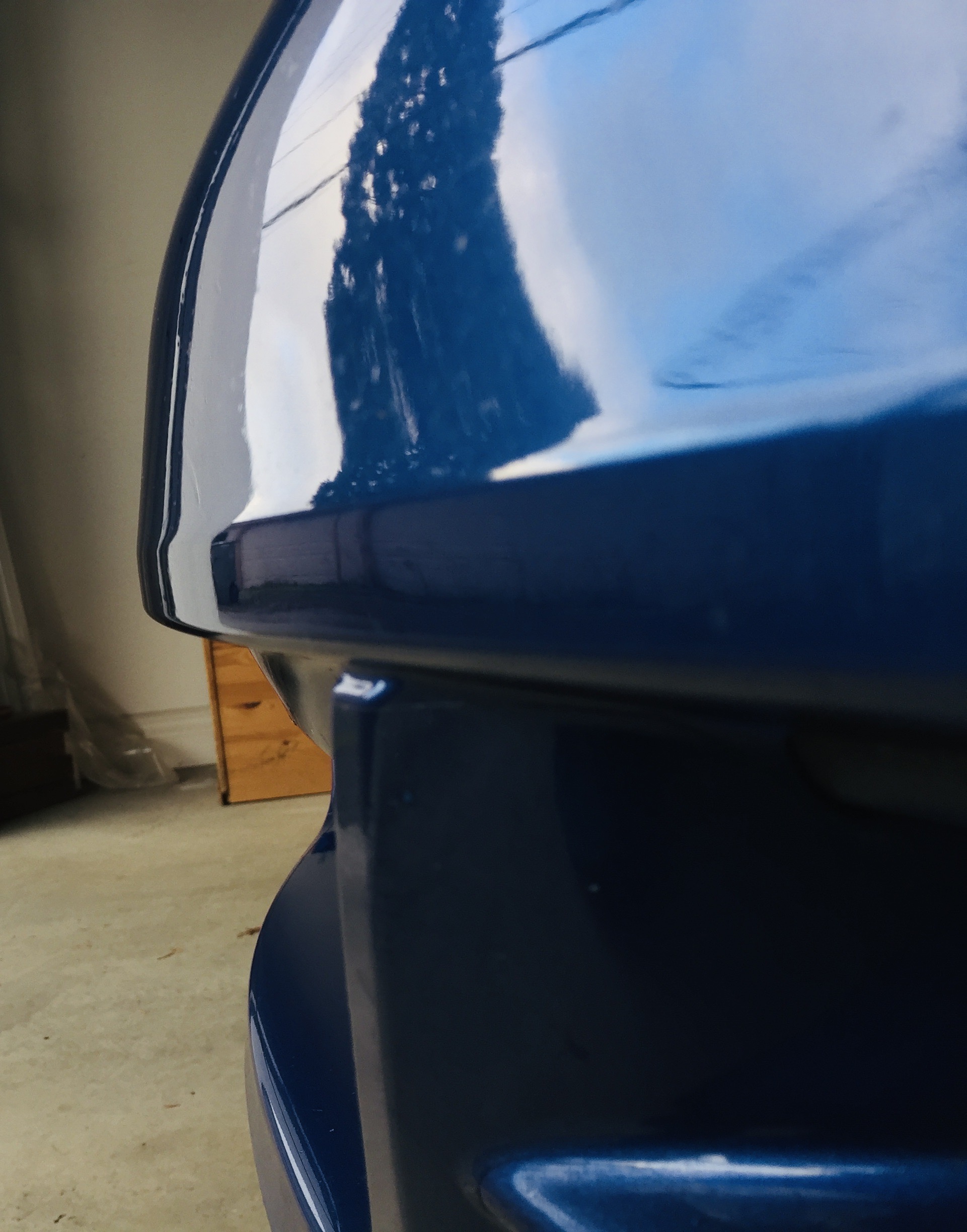

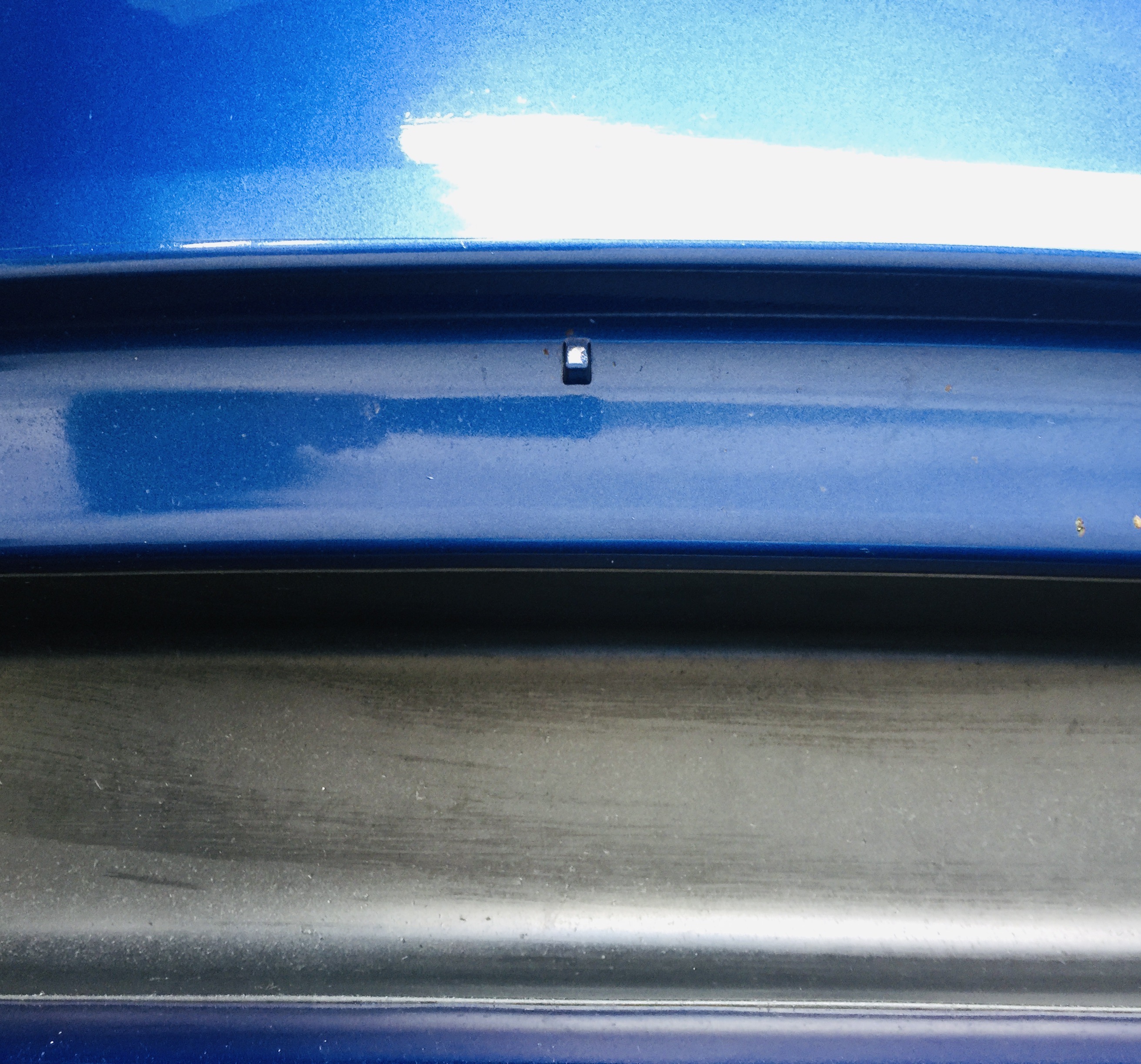

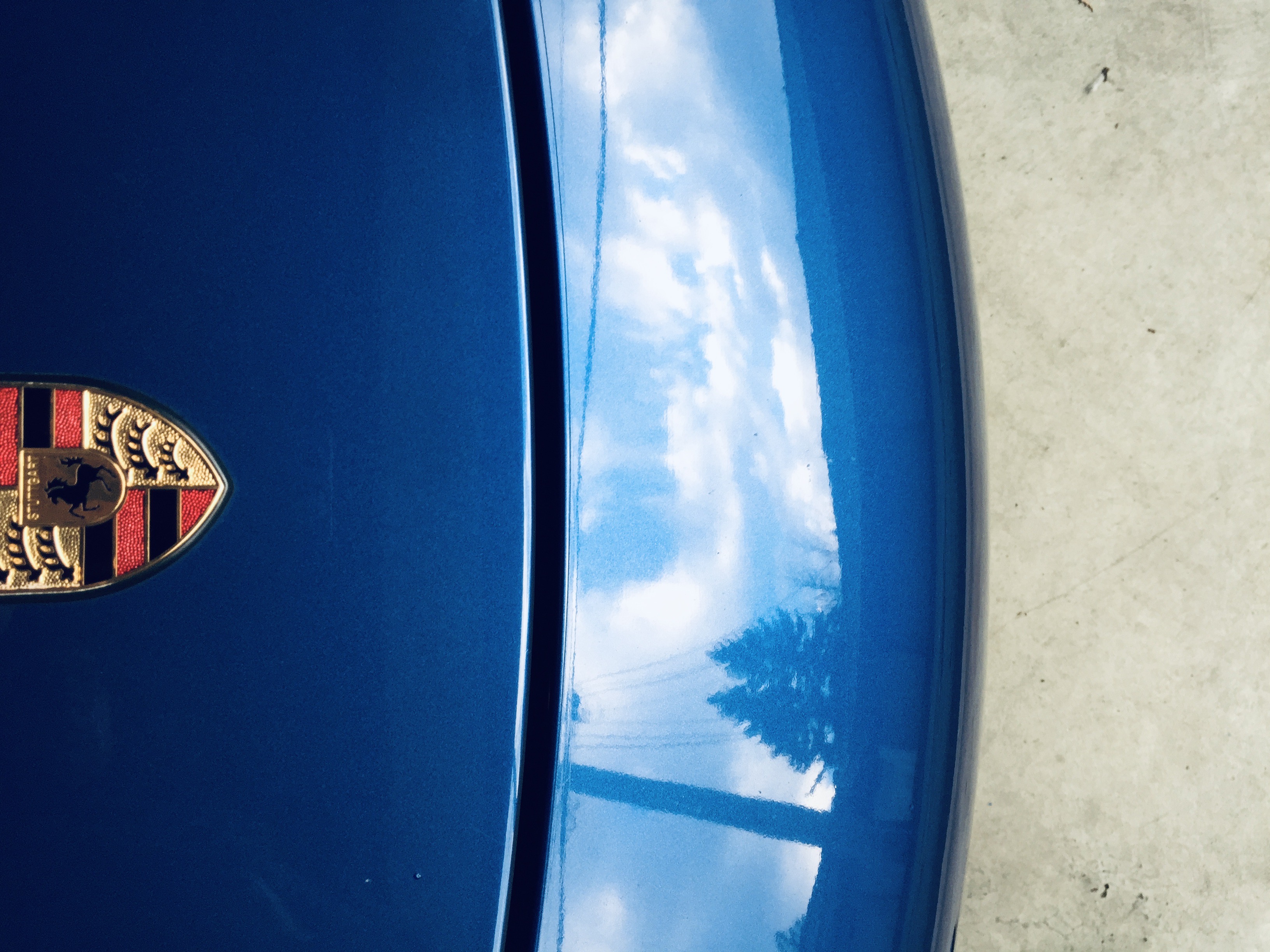

I think you are right though Tom. Having another look at it this morning, I see several problems with using the brackets to mount a front plate on my car. As you mentioned, there is not a flat surface both in the vertical plane as well as the horizontal. I was hoping that the curve of the horizontal part of the bumper was "flat" enough to allow for the tape thickness of the 3M to conform to the shape but it looks like the 3M tape is only about 1mm thick. Second, the vertical plane of the bumper looks to be a little flatter than the horizontal but the part that is relatively flat is not that high which means I could only mount the top part of the plate with the bottom holes hanging below that surface.
In the pictures of my car, that small tab just under the leading edge of the bumper marks the centre of the bumper. Below that surface the bumper drops away again into the black grill cover. Most of the drill-less mounts that I have come across tend of use the under facing top part of the black grill cover to attach the adhesive mount. Then brackets are attached to that in order to mount a plate on a vertical plane. The most promising part I've found that you can still buy is sold by carbonio.ca. I might just go for that option and give it a try.

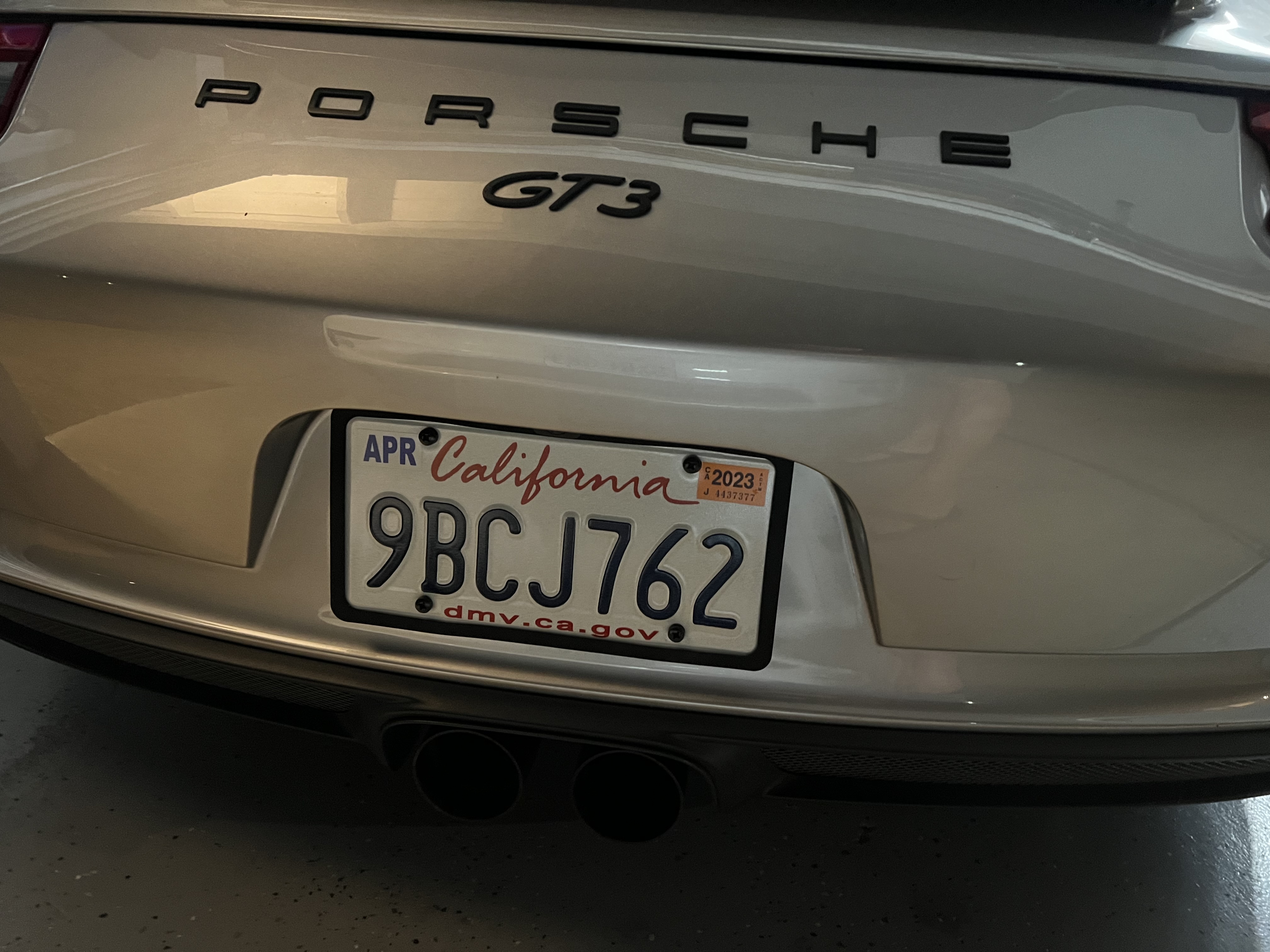

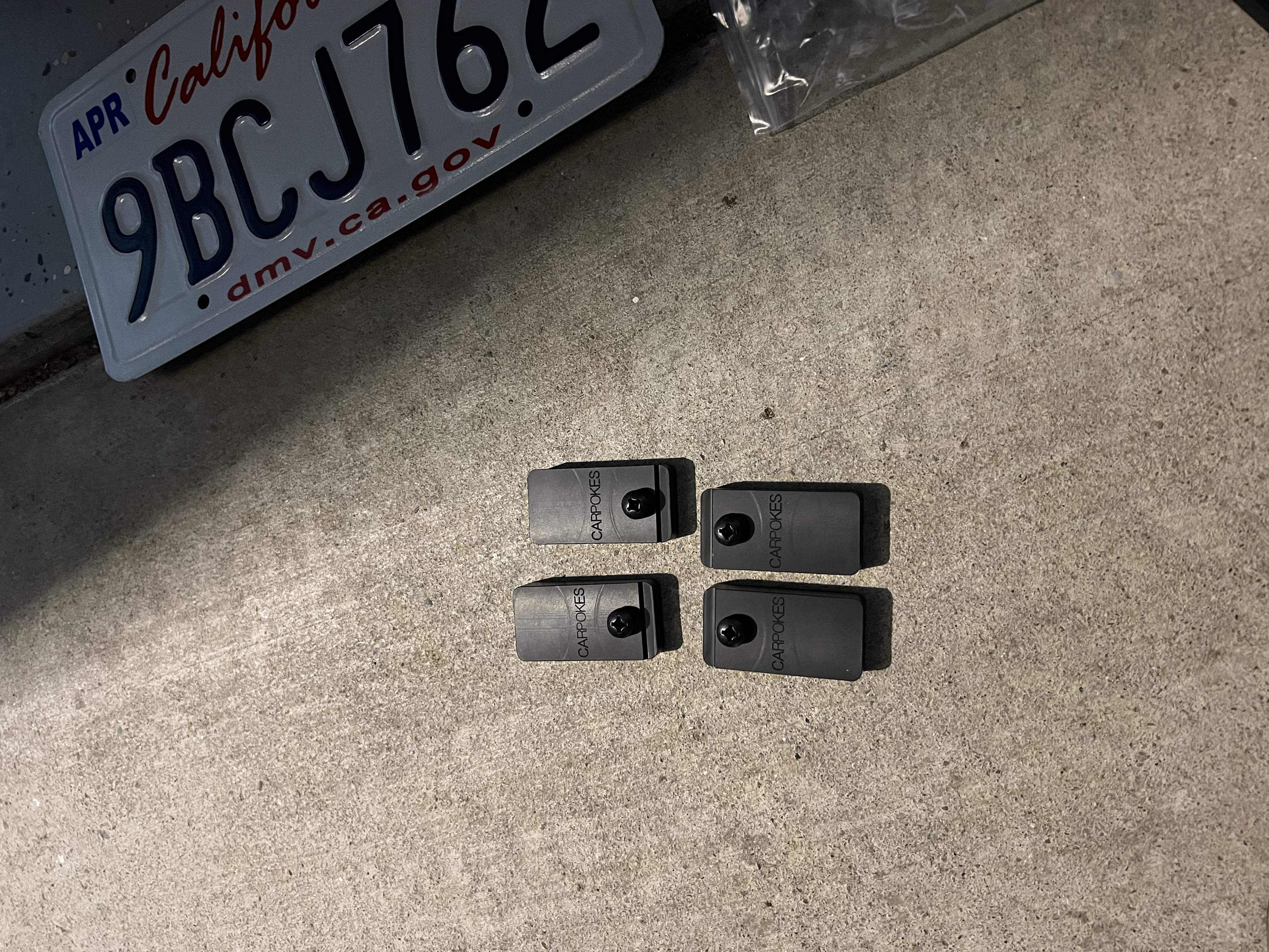

Just installed my mounts on my 991 GT3 - thanks Tom!! Hardest part was peeling the backing off the 3m tape
