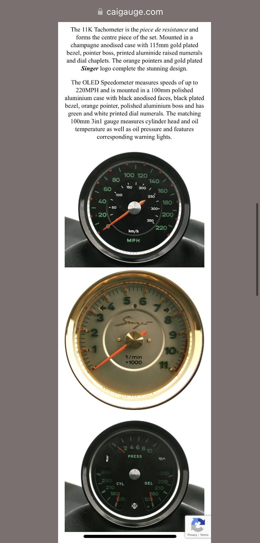

Thanks for considering. I’m looking for ideas and found this. This is next level stuff. I would be so happy looking at this each time I sit in the car.
