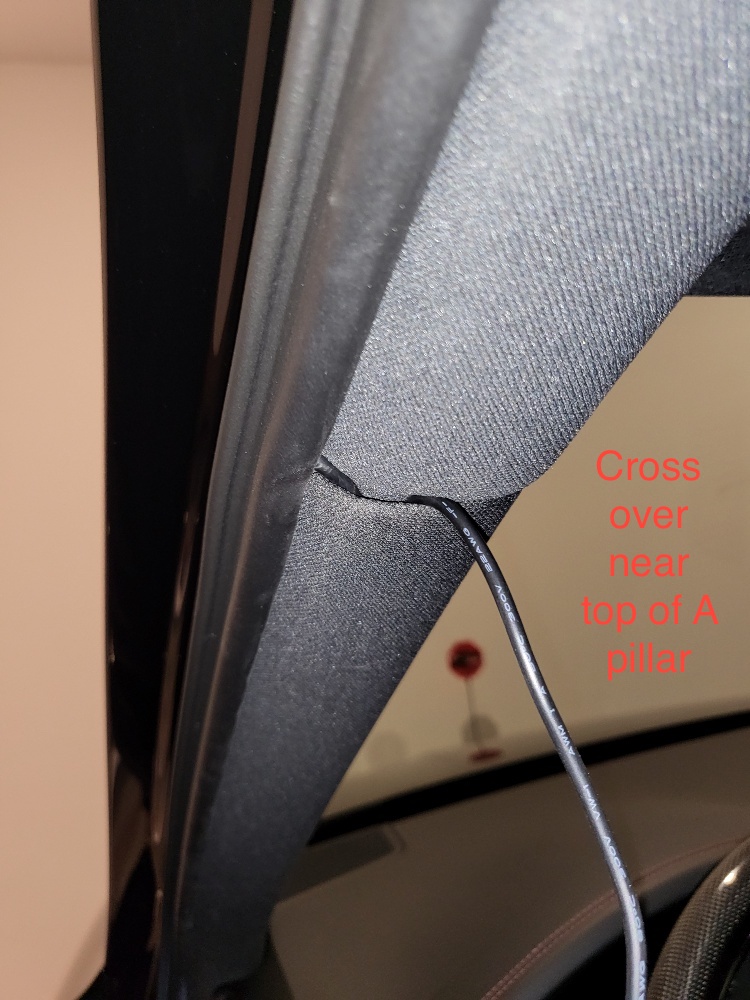

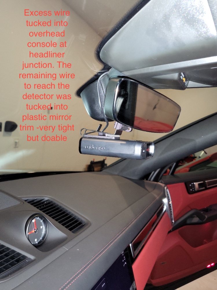

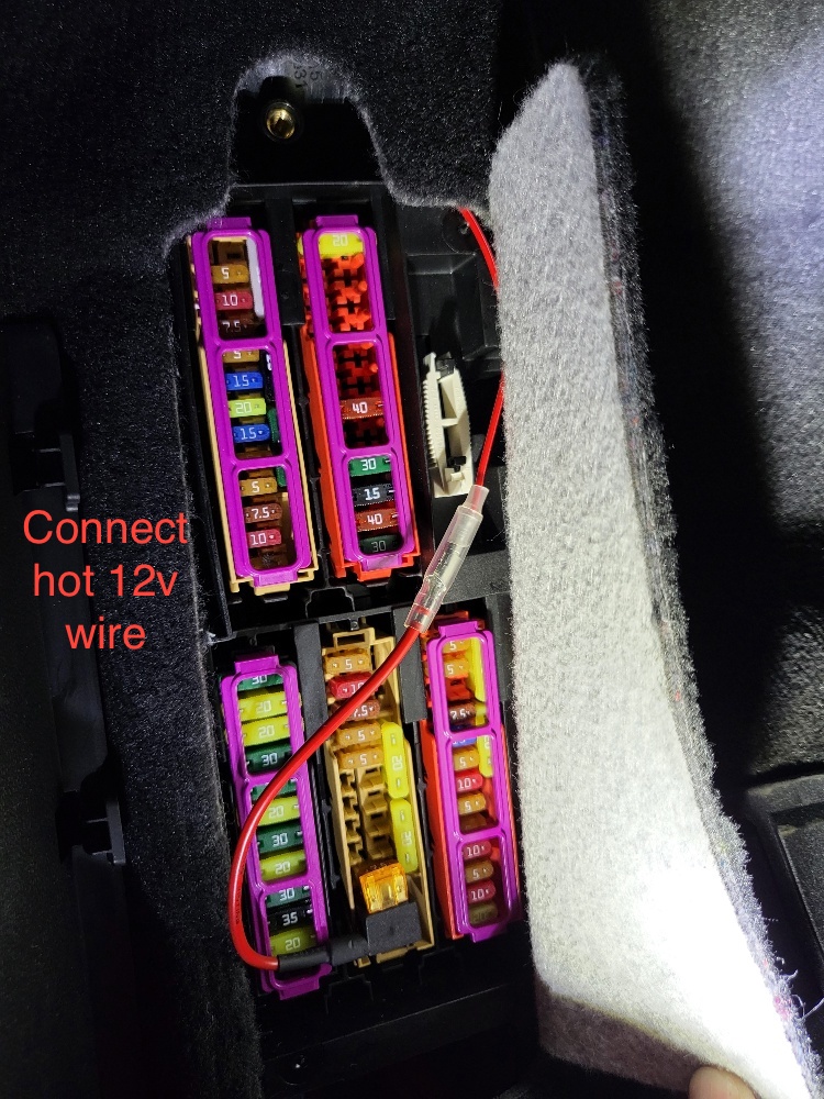

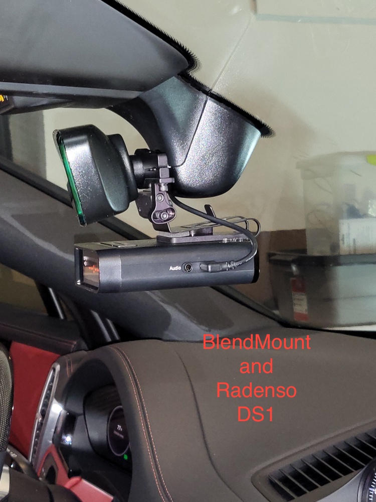

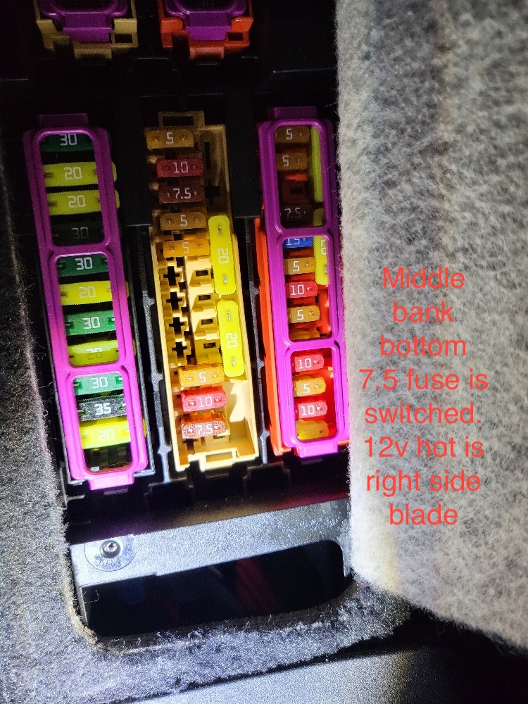

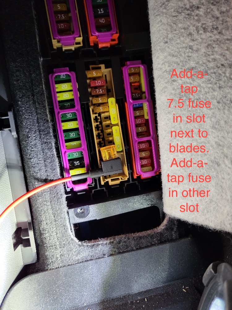

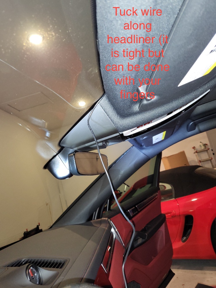

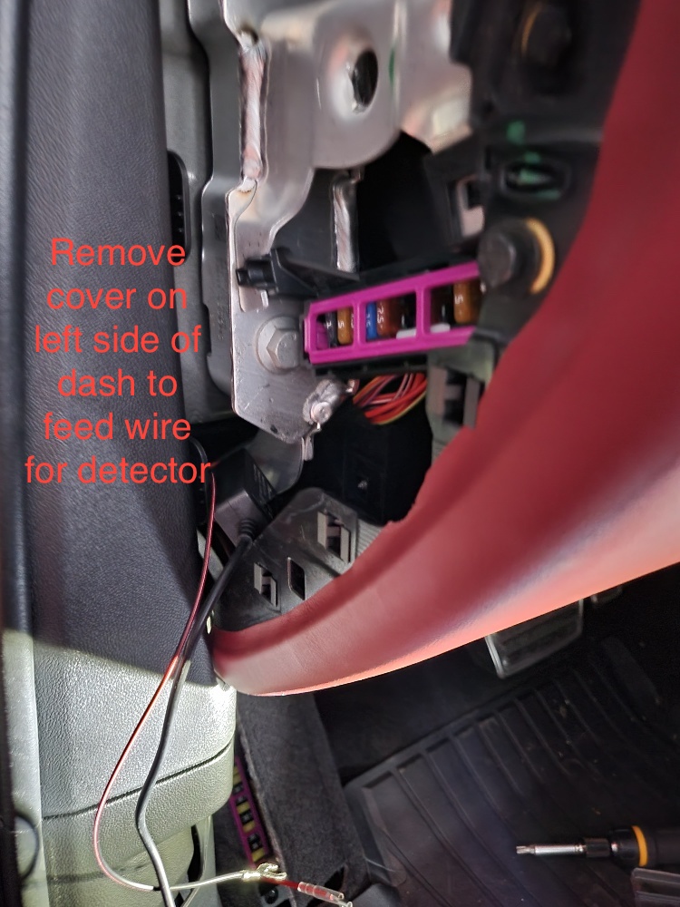

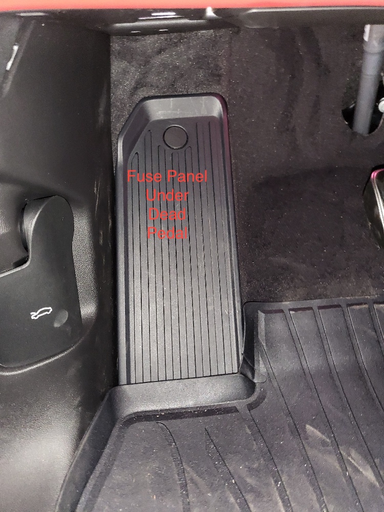

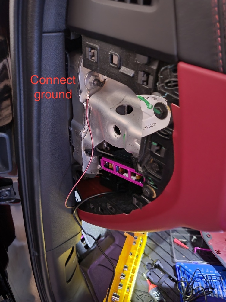

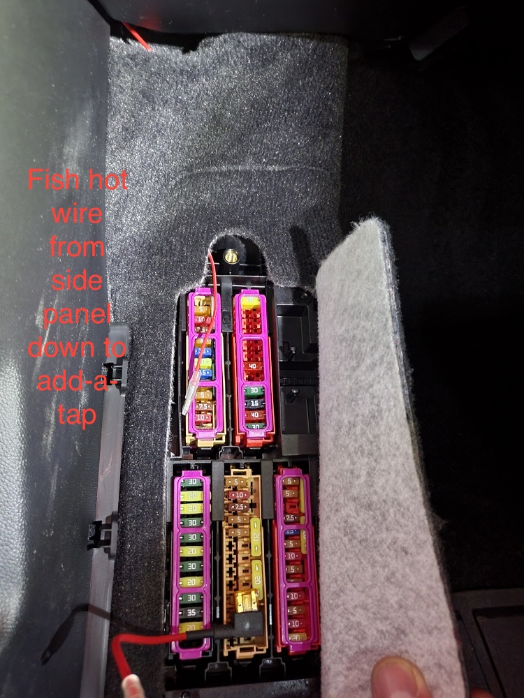

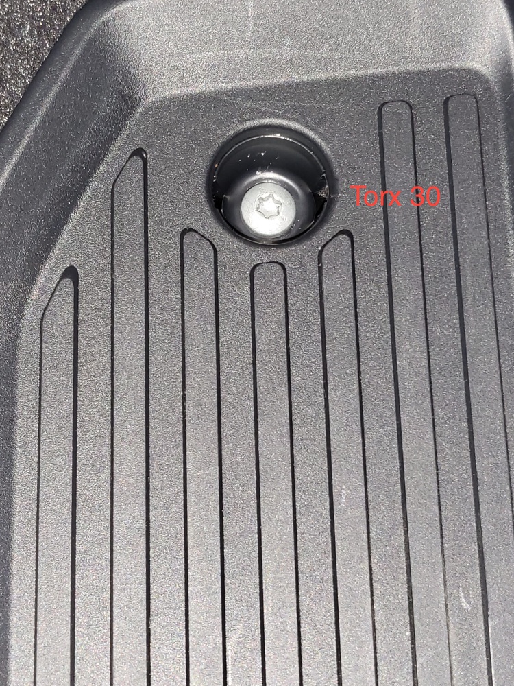

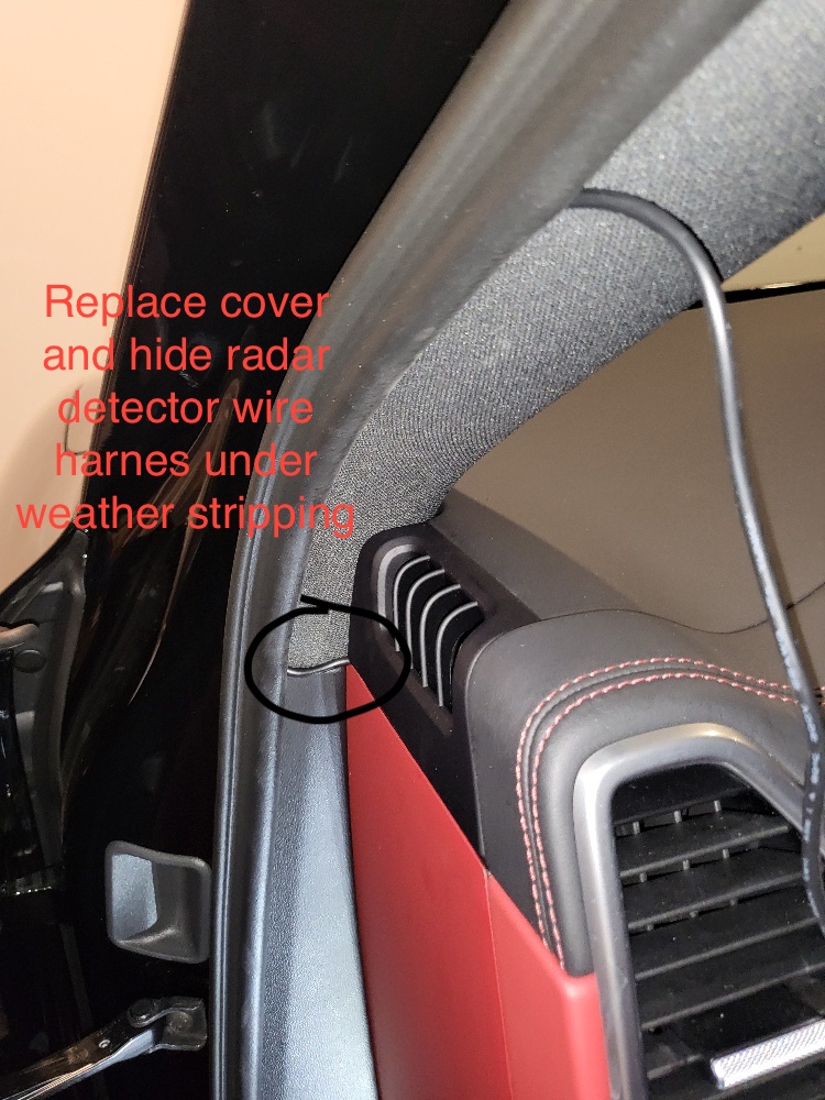

Earlier tonight I installed a new radar detector in my wife's brand new 2023 Cayenne S Coupe. The one annoying thing about using a switched fuse is that when the start/stop is enabled, the detector restarts when the engine restarts. It will soon be a non-issue after the car's break in period is over. The car will always be driven in at least Sport mode (no start/stop), and the Individual setting will be programmed to disable start/stop. For now I have the diamond short cut button on the steering wheel programmed to disable start/stop.
EDIT:
For Radenso DS-1 radar detector owners use the Radenso branded direct wire kit. I ordered and installed it to replace the aftermarket hardwire kit I originally used in the post. The Radenso branded kit does not reboot the radar detector with the Cayenne's start/stop engine cycle. The Radenso kit also has a remote mute button.
As far as the hardware, I usually run a Valentine 1 Gen 2 with the JBV1 app in my car. However, my wife doesn't want anything that requires additional steps. Based on her satisfaction with the Radenso Pro-M in her prior car, I decided to purchase the new Radenso DS-1 for the Cayenne. Since she likes to use her sun visors, instead of the windshield mount, I used a BlendMount.
2023 Cayenne Radar Detector Hardwire Install

- 20230331_1.jpg (332.19 KiB) Viewed 3059 times
- 20230331_2.jpg (473.46 KiB) Viewed 3059 times
- 20230331_3.jpg (399.04 KiB) Viewed 3059 times
- 20230331_4.jpg (377.98 KiB) Viewed 3059 times
- 20230331_5.jpg (231.39 KiB) Viewed 3059 times
- 20230331_6.jpg (306.21 KiB) Viewed 3059 times
- 20230331_7.jpg (343.89 KiB) Viewed 3059 times
- 20230331_8.jpg (216.62 KiB) Viewed 3059 times

Part 2 of install
- 20230331_9.jpg (282.58 KiB) Viewed 3058 times
- 20230331_10.jpg (225.85 KiB) Viewed 3058 times
- 20230331_11.jpg (260.77 KiB) Viewed 3058 times
- 20230331_12.jpg (239.2 KiB) Viewed 3058 times
- 20230331_13.jpg (217.94 KiB) Viewed 3058 times

Lately, there have been more than the usual number of local police doing speed enforcement. Perhaps it was because it was month end. Hopefully, the boss lady pays attention to the alerts on her new detector when they go off. I programmed different colors and tones for the various bands.

I remembered now that when I ordered the new detector, the Radenso branded direct wire kit was out of stock everywhere, so I bought an aftermarket hard wire kit. Perhaps the aftermarket kit is too sensitive to current fluctuations. This morning I found the Radenso kit on the BlendMount site. I ordered it. I will see if the Radenso kit makes any difference. Years ago the V1 Gen 1 had some issues. Valentine used to sell an add on called the brown out buster, which maintained a constant current during the start/stop cycles.

I received the Radenso branded direct wire kit. I installed it today. Good news -- the Radenso branded kit does not reboot the radar detector with the Cayenne's start/stop engine cycle. The additional benefit is the Radenso kit has a remote mute button.wem wrote: Sat Apr 01, 2023 9:15 am I remembered now that when I ordered the new detector, the Radenso branded direct wire kit was out of stock everywhere, so I bought an aftermarket hard wire kit. Perhaps the aftermarket kit is too sensitive to current fluctuations. This morning I found the Radenso kit on the BlendMount site. I ordered it. I will see if the Radenso kit makes any difference. Years ago the V1 Gen 1 had some issues. Valentine used to sell an add on called the brown out buster, which maintained a constant current during the start/stop cycles.
