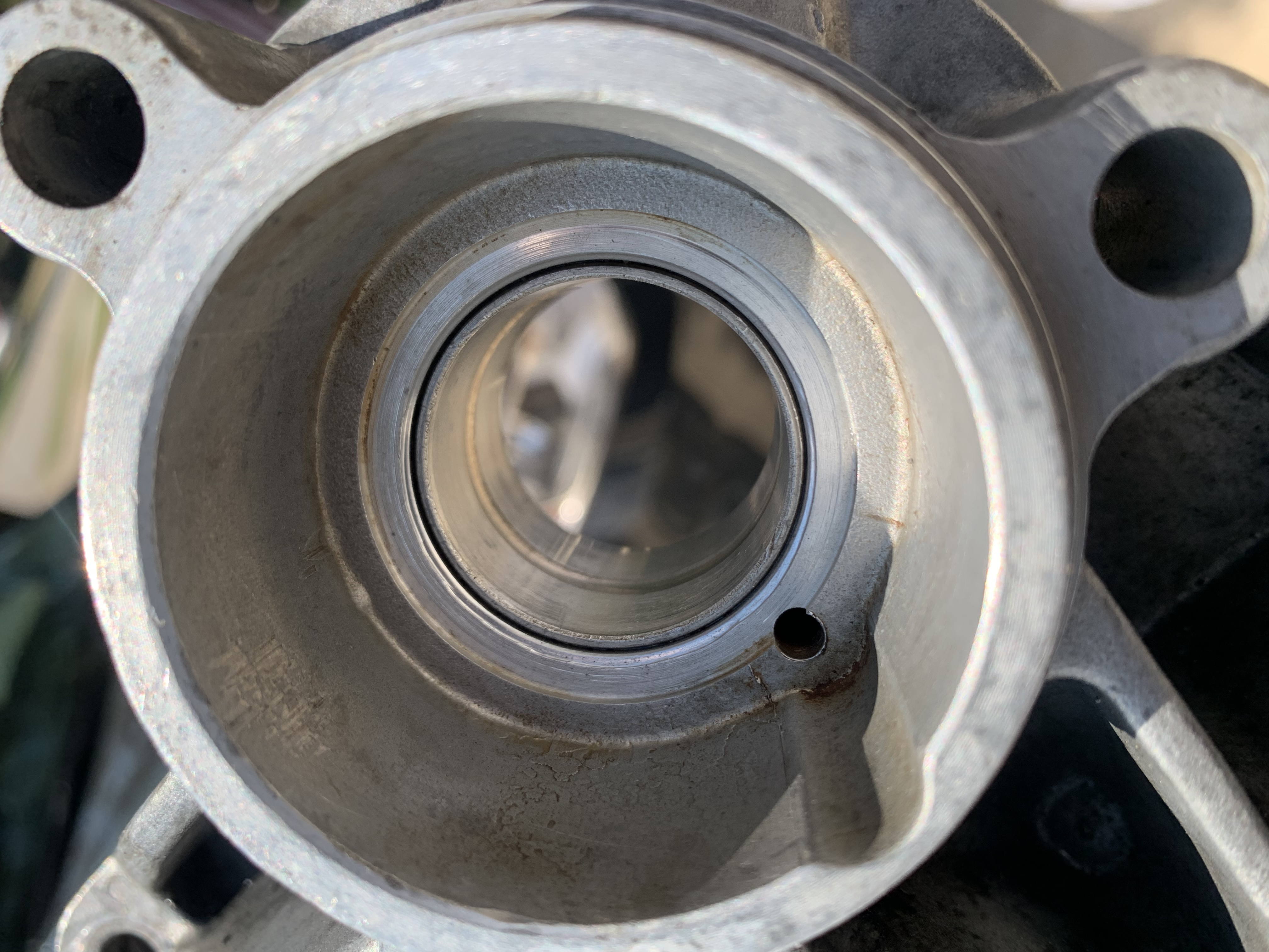

I removed my lower balance shaft support to clean and replace seals today and found it in this condition. Is this something I should be concerned about with respect to leaking? Is the race suppose to have that kind of grove?

Not entirely sure what you are focused on in those pics, but it looks like the area where the seal goes got scraped/gouged a bit, so I would dress that so that no metal is sitting proud. As for the bearing inside that the b/s spins in, that wouldn't be the source of a leak. That bearing will have a cushion of oil when the engine is running, much like a crank journal or the like, and that oil is kept inside via the seal. If you see defects that bearing (hard to say from those pictures...), then I'd just replace it. It's a very low-load bearing that last a very long time, but it's also cheap and easy enough to replace.....

Thanks Tom. I was mainly showing over all condition because I did see the gouge in the outer wall where the oil seal goes. I swear that was not me! I was also inquiring about the large furrow in the middle of the race. I’m pretty tired from working all night and didn’t even click to that being an oil passage for cushion. I think it’s time to call it quits for the day and get some shuteye. I’ll address the gouge in the outer wall and get it lightly sanded before I put things back together….another day. 😴😴
