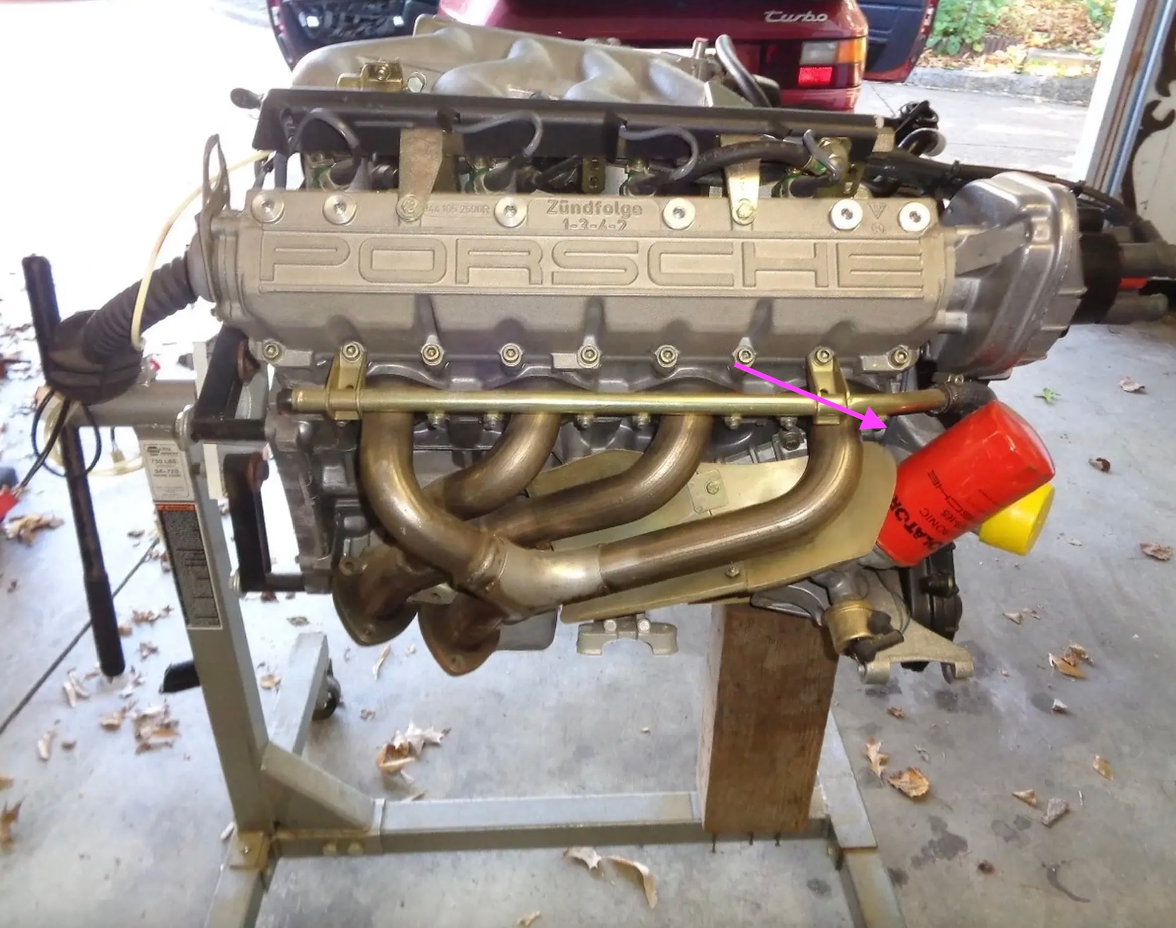

Though this picture has it going under the thermostat housing:

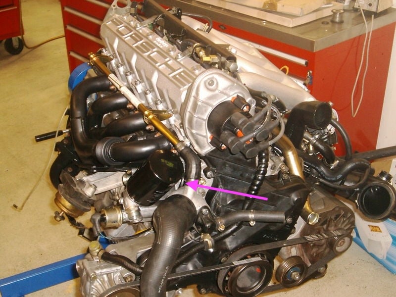

Another example with the wire behind the thermostat housing:

Balance of opinion appears to be behind the thermostat housing:

Thanks for finding all those images!
Behind it will be. It does make slightly more sense, as it will be more out in the air rather than pushed against the thermostat housing.
