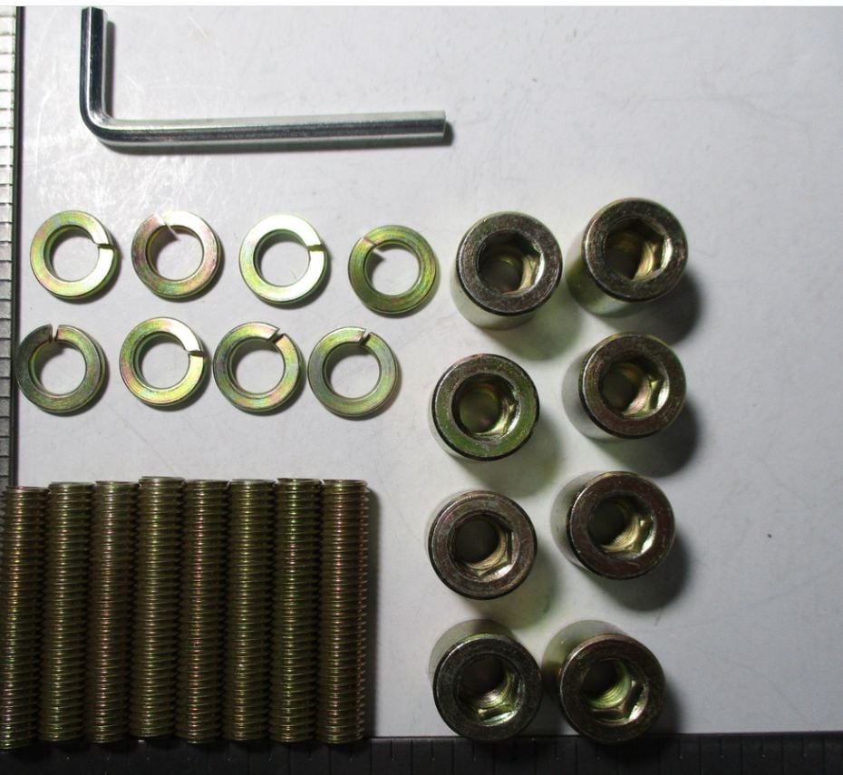

I may as well do intake manifold gaskets as well. I think it would be a good idea to pull the intake and clean the top of the engine as part of this overhaul.
Has anyone had any experience with the intake manifold stud conversion kits?
Not sure they are that much more convenient than just using the OEM intake manifold hardware.

Well, they reduce the risk of stripping out the threads and keep the gasket in place when installing the manifold, so that's the upside. They can make getting the manifold on and off a bit more cumbersome (and risk scratching the mating surface), and one of them needs to be removed to get to a head stud nut. I just use the factory bolts -- and lots of helicoils over the years.
I've had good luck with sliding the bolts through the manifold and placing the gaskets on that way before dropping the "sub-assembly" down onto the intake. Keeps the gaskets in place for the most part but it is a little cumbersome.
I would rather use factory hardware and *hope* to not need helicoils rather than risk damage to the mating surface. Seems like more of a hassle.
