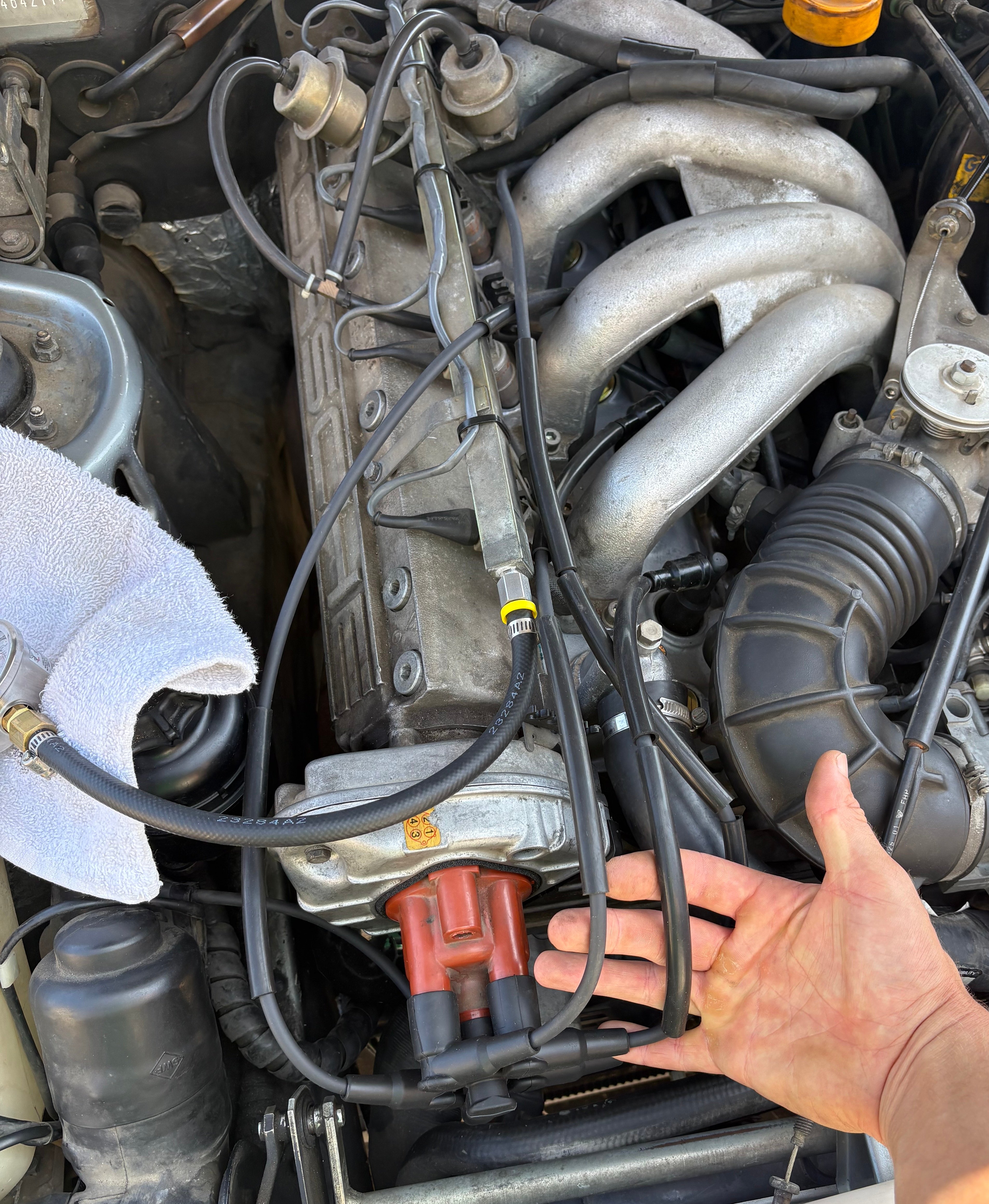

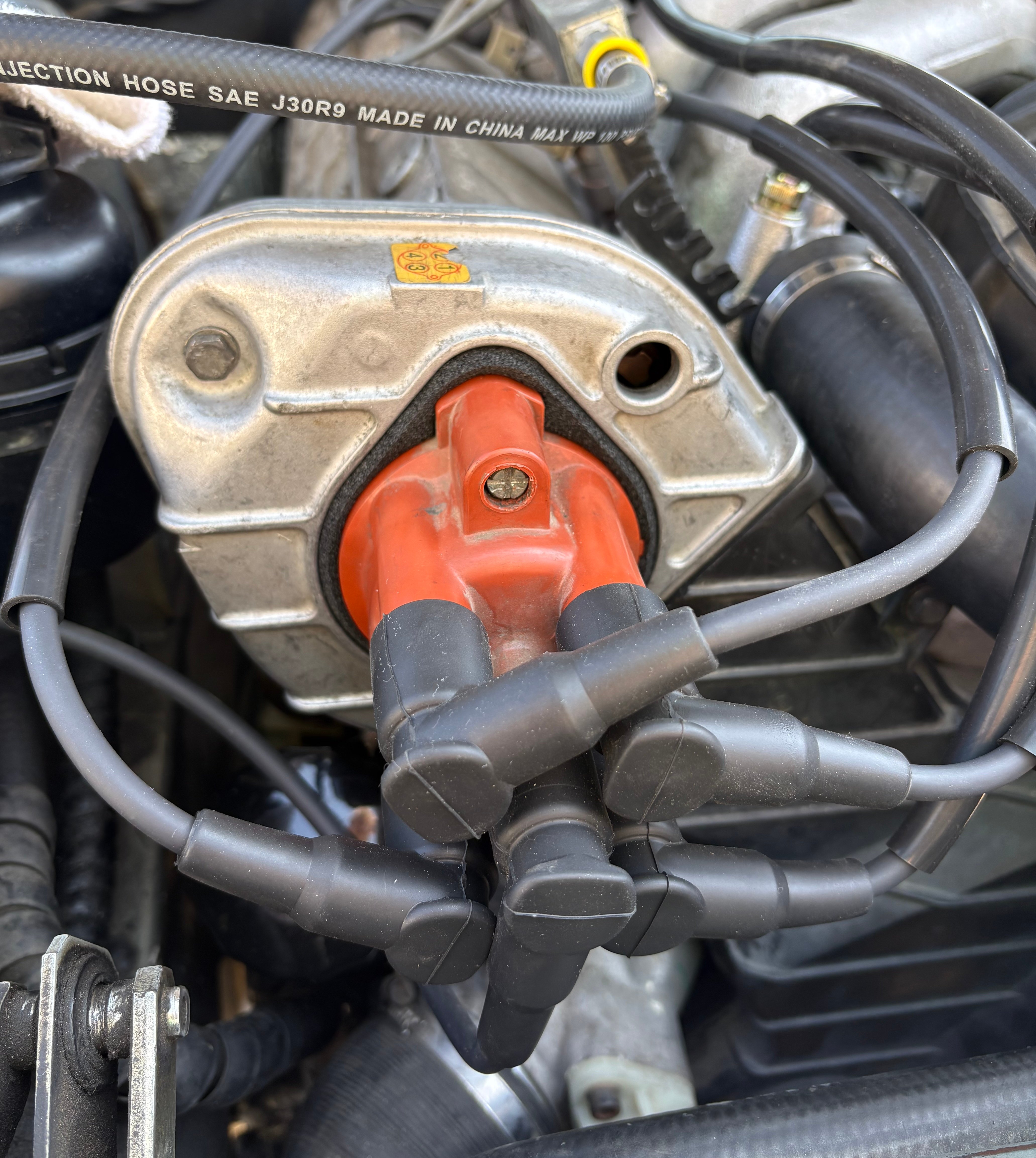

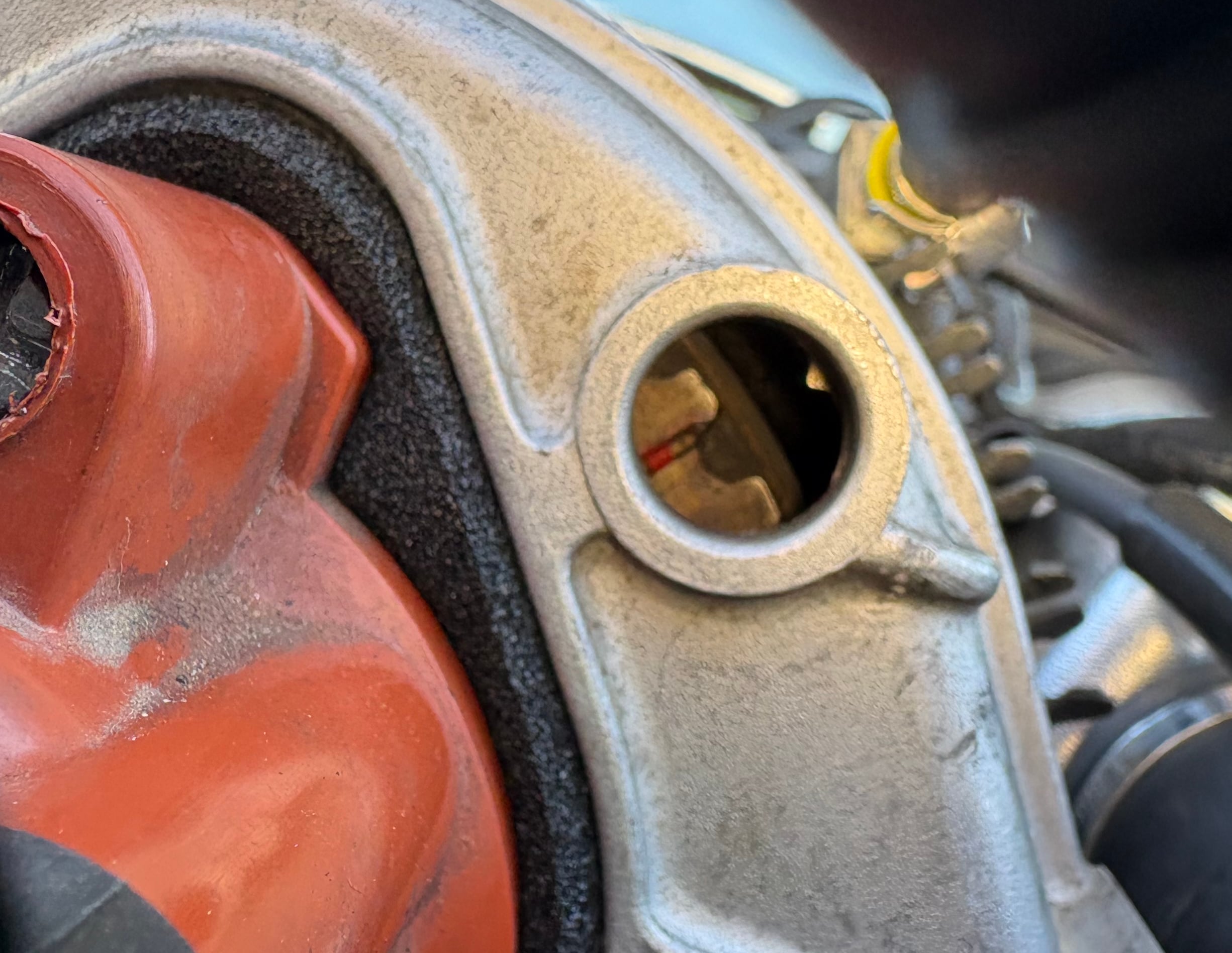

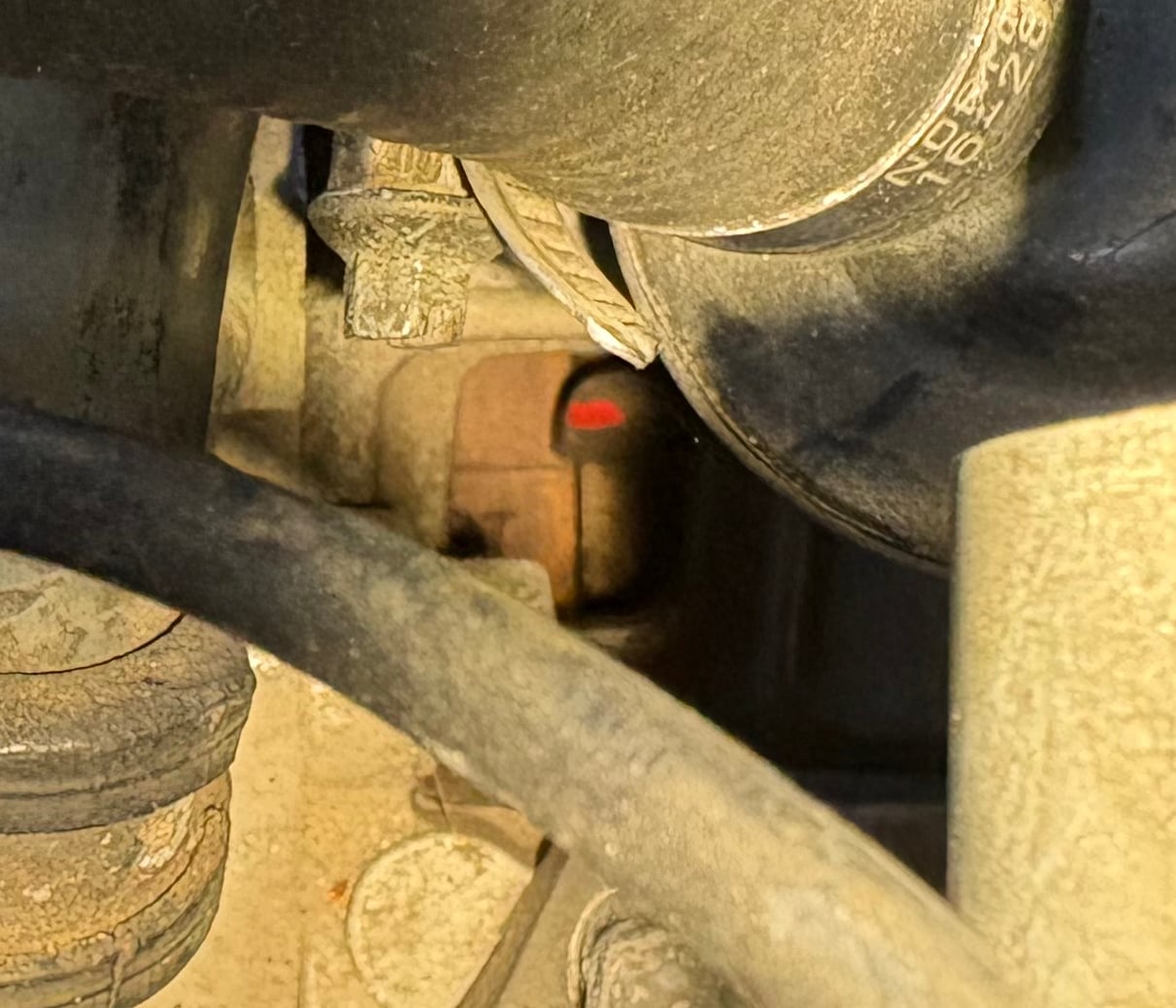

I've attached a few pictures of the timing marks and plug wires. As far as I can tell everything is correct, but maybe someone will spot a problem. I also verified that cylinder 1 was at TDC with the marks aligned as in the photos. The cam mark is slightly off (~1/2 tooth) relative to the mark on the front cover, but lines up perfectly with the rear cover.

- Flywheel Mark.jpg (706.34 KiB) Viewed 21 times
- Plug Wiring.jpg (4.1 MiB) Viewed 21 times
- Distributor Wiring.jpg (3.26 MiB) Viewed 21 times
- Cam Alignment.jpg (2.32 MiB) Viewed 21 times

Good eye, it does indeed. That yellow sticker is confusing in that the numbers are rotated 90 degrees within their little circles. So it's natural to mentally rotate the whole sticker in your head and think #1 is the 1:30 position, #3 is in the 4:30 position, etc. So, it looks like each wire is one post off. Each wire needs to be repositioned one post clockwise. #1 should be at 4:30 (i.e., the lower right post), #3 should be at 7:30 (I.e. lower left post), etc. That's probably the whole issue here, but even if the car has other issues, that's one you've got to fix.barnwerks wrote: Thu Jun 25, 2026 5:17 am It appears in the photo that #1 plug wire is connected to #2 tower of the distributor cap.
It appears #3 is connected correctly, #1, #2 and #4 need to be reconfigured. As a finer note, the #3 should be routed below the cap and should join in the loom from below with the other three wires at the coolant outlet.
