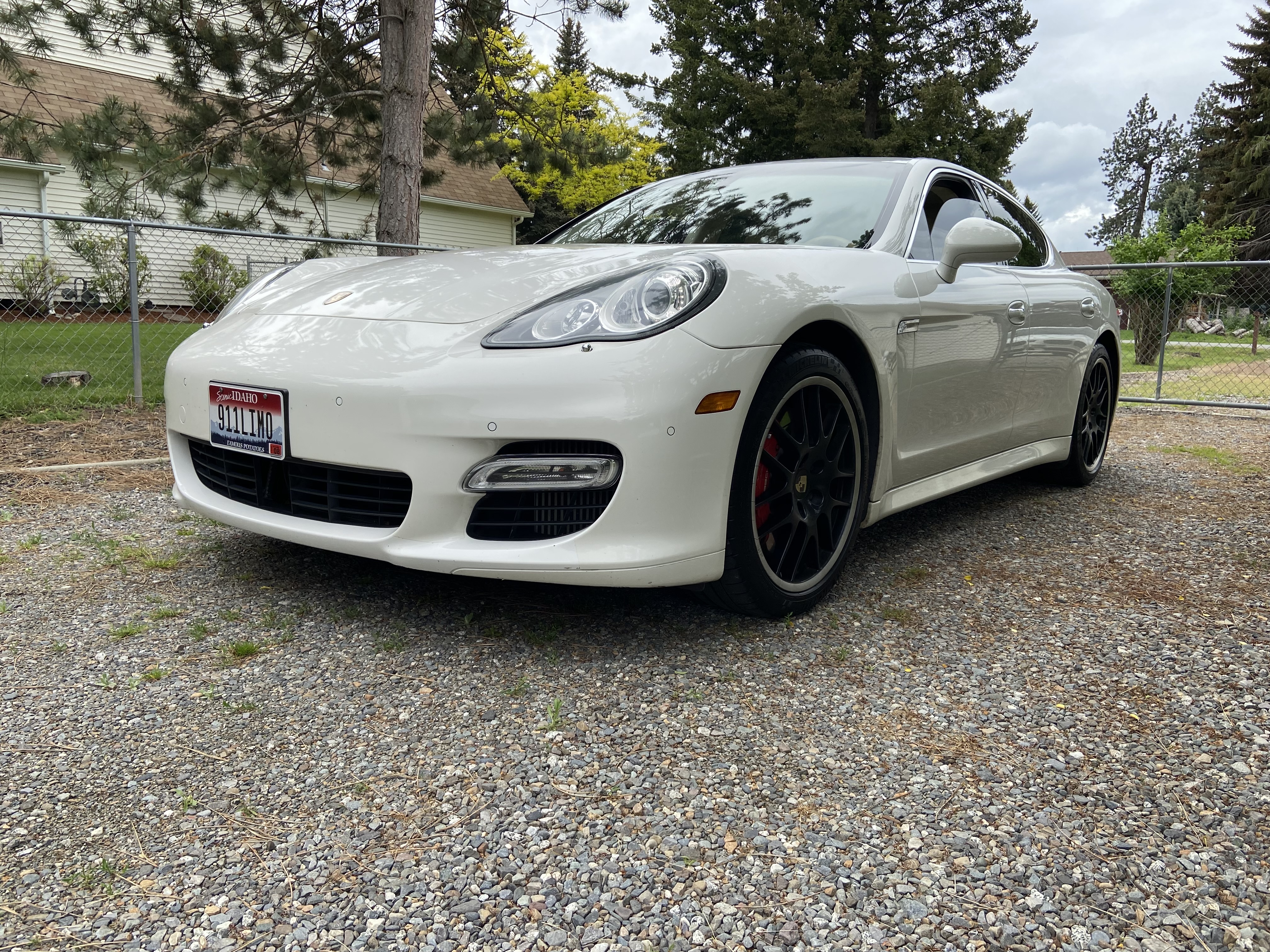

I would like to start a 970 Panamera Turbo Q&A, sharing modifications, pics, etc
2010 Turbo
Many Options on the build
vinanalytics is a fantastic site to see all your options if you don't have a window sticker/maroney label
https://vinanalytics.com/

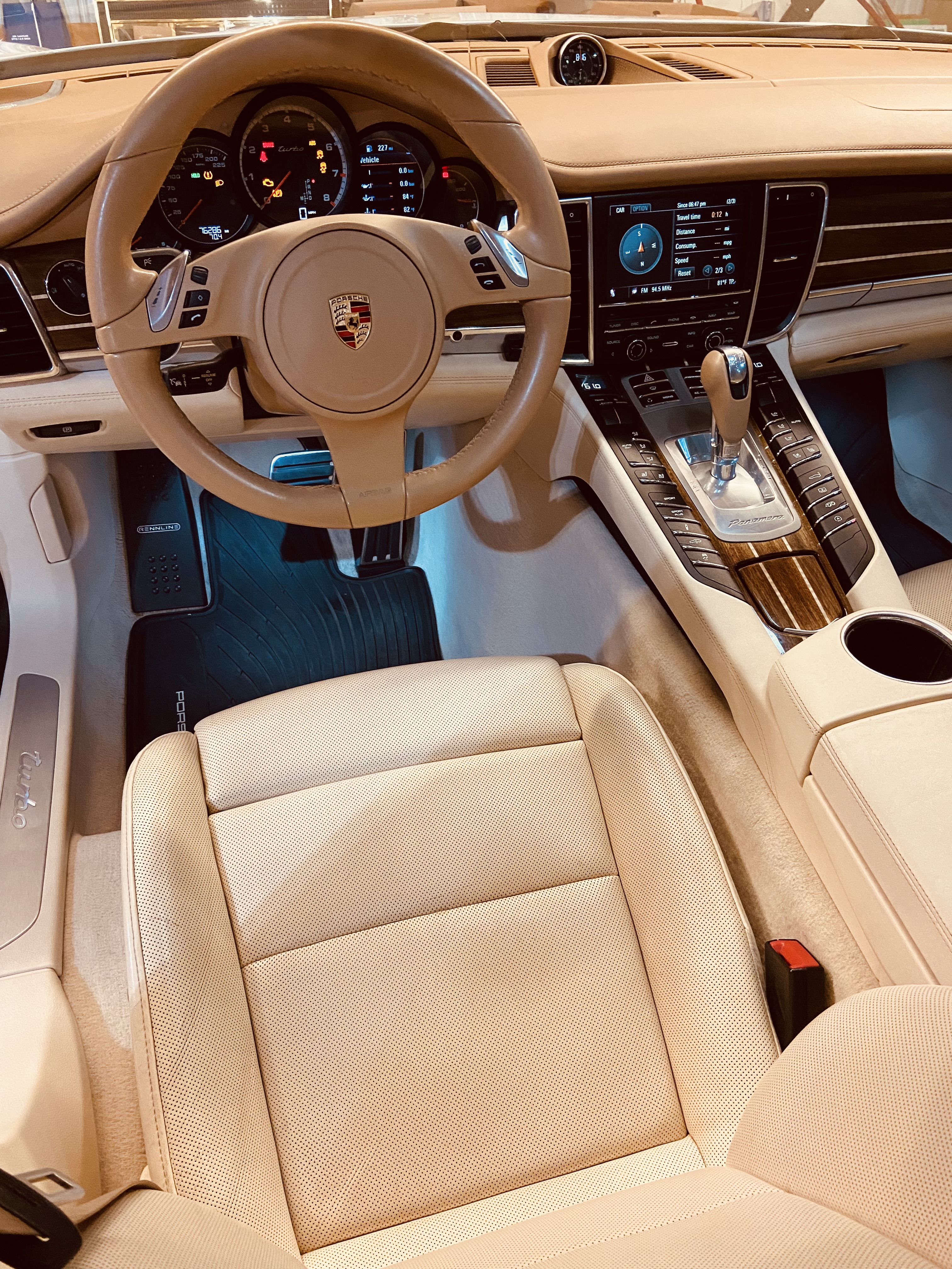

Fantastic Car-! The quality of the paint and interior are amazing for the period and now 12 years old still fantastic

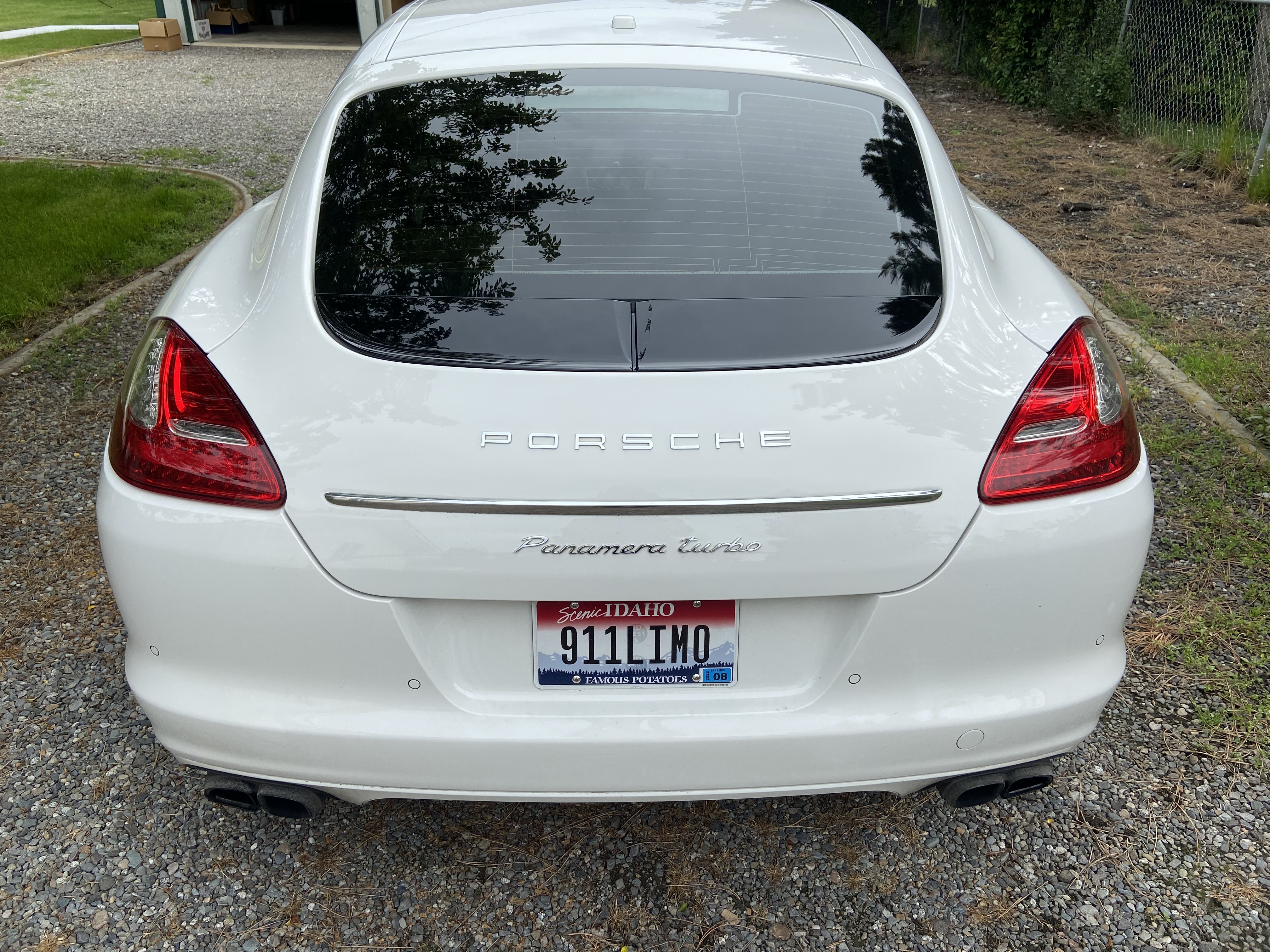

So far this year I have installed aluminum diverter valves
Rennline Spacers
TechArt paddle shifters
IPE 200 cell sport cats and IPE axle back exhaust
https://ipeofficial.com/products/porsch ... 70-exhaust
FVD tune
https://www.fvd.net/us-en/FVD97061890MG ... -tool.html
All of which of which have worked together fantastic-!
