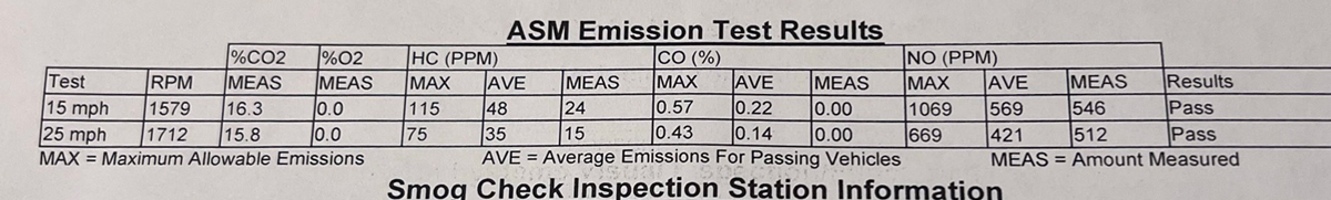

Well I passed my smog test today, which is always a huge relief. Looks like the NOx numbers are creeping up, so I may add a smidge more gas next time. Stock chips, AFM, injectors, etc. This is still with the DEC cat I bought in 2018, which is starting to get close to the end of its 5-year warranty period. But that's a worry for another year. Today, all is good.

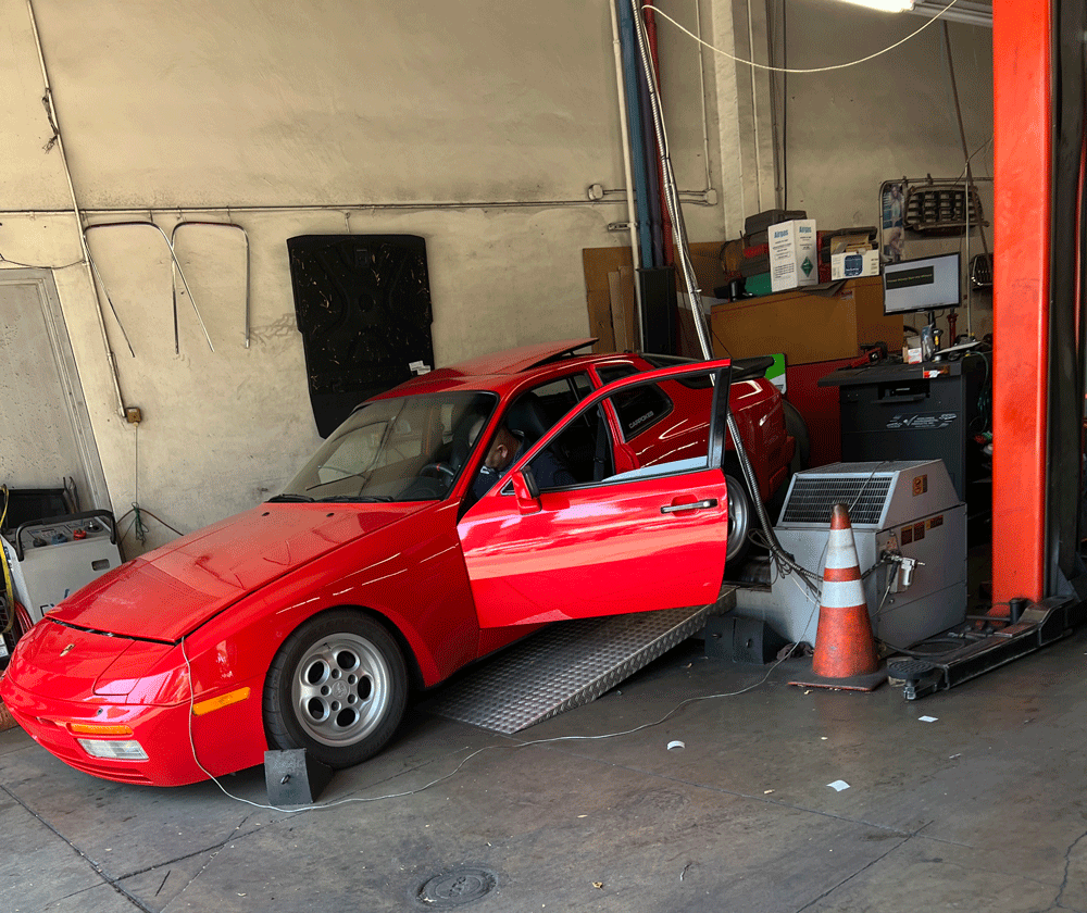

I went to SmogIt in Sunnyvale, on Evelyn. I've taken it there before. He's just a straight-up, honest smog tech. No special favors but no game playing or hyper nit-picking either. I've been going there for several years now after the last guy tried to shake me down for money to pass my car, claiming my 100% CA legal cat wasn't legal. When I argued that the cat was CARB approved for the car, he started pointing at other things like my j-hot coated factory headers -- basically letting me know he wanted $50 to pass the car (even it had already sailed through the tailpipe dyno test). Karma caught that guy though -- or should I say the state did. He was on the lamb for a while, then suspended, and now has resurfaced at another gas station smog shop in Mt. View.

Happy to report my car passed smog today. Yippee!! This was with the DEC cat I bought in 2018 -- so apparently it lasts longer than I feared. I was worried the NOx would keep creeping up like last time out, so in additional to my normal tune-up ritual, I added a little extra fuel this time (careful to stay in closed-loop); did the test in the morning before it got hot (~25 degrees cooler than last time); and ran the car on the freeway for a solid 45 minutes before the test to really heat-soak the cat. Results were fantastic -- probably the lowest overall numbers I've seen yet!

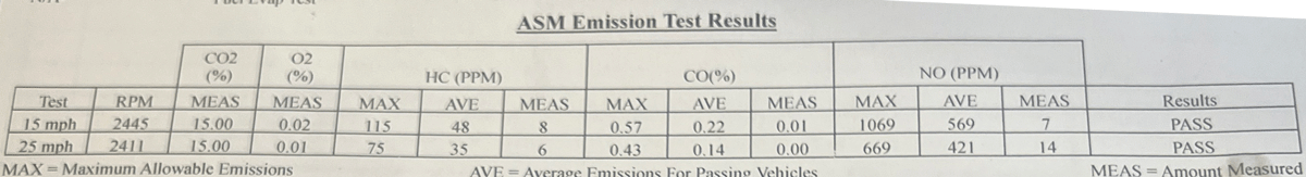

Nice, the additional factor of measuring for NOx while under light load is something we don't have to deal with in Santa Barbara. It is becoming more and more difficult to find quality CA/BAR-legal catalytic converters that last a decent amount of time. This is a constant struggle with our '90s BMW customers in particular. My 951 is somehow scraping by with its original cat with over 180K miles, at least 10K of them track miles while I ran the engine in stock form . . . . I am able to make the thing pass the idle/2500 RPM tests in neutral with the VEMS engine management and 830cc injectors, which demonstrates the power of even a basic standalone engine management system.

No, their dyno was down for repair. He said it would be fixed in a week. Assuming they are up and running again, I'd go back to them. I went to Le's Auto Repair on Evelyn, down the street from the other place, which was recommended by a car friend with a shop in the area. They were good in the sense that they were not looking for reasons to fail the car and/or take advantage -- been there and done that. But I was not a fan of their actual dyno, which sat above the ground. And they made me wait 30 minutes while they worked on an old jalopy, despite having an appointment, and despite the fact that they could have stopped anytime to smog my car. In the end, everyone was very nice, but the shop and parking lot had kind of a junk yard vibe. They also charged $135 for the certificate, which is above market I believe, but there were not a lot of options and I just wanted to get it done. I was surprised how many Star stations refuse to do dyno tests anymore. When I called around, most said no, presumably because they just want to do 10 minute OBDII tests and collect their $40 with very little time and effort.whalenlg wrote: Sat Aug 10, 2024 2:39 pm Great news - same place in Sunnyvale?

Aftermarket CA-legal cats must carry a 5 year, 50k mile warranty. My theory is that caused a race to the bottom, where all the mfg's try to make the cheapest cat possible that will still last, if barely, 5 years. These dyno tests are run at very light load (13 in. HG vacuum according to a log I once made during the test), but even that adds the challenge... But in the end, it's all about a good state of tune and a good cat.cda951 wrote: Sat Aug 10, 2024 3:15 pm Nice, the additional factor of measuring for NOx while under light load is something we don't have to deal with in Santa Barbara. It is becoming more and more difficult to find quality CA/BAR-legal catalytic converters that last a decent amount of time. This is a constant struggle with our '90s BMW customers in particular. My 951 is somehow scraping by with its original cat with over 180K miles, at least 10K of them track miles while I ran the engine in stock form . . . . I am able to make the thing pass the idle/2500 RPM tests in neutral with the VEMS engine management and 830cc injectors, which demonstrates the power of even a basic standalone engine management system.
