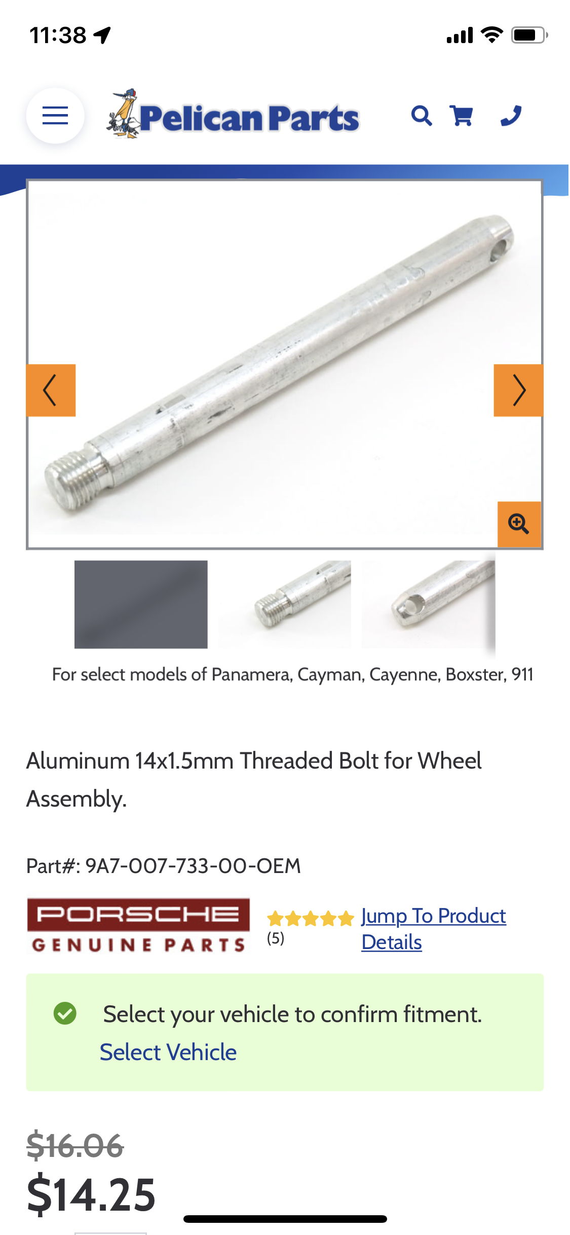

I have this gizmo
Thread it into one of the lug bolt holes hang the wheel and insert other lug bolts then remove
Pelican Parts has them I had this for my Audi’s same principle on Porsche

I have never used one of these studs before. Do you buy 4, one for all wheels or do you just move it around?audi4t wrote: Mon Aug 08, 2022 8:33 am I have this gizmo
I had this for my Audi’s same principle on Porsche4635C569-50E7-4E82-A000-72D3F034A863.jpeg

You just need one to hang the tire on and then move on to the next wheel once the first is mounted. I also keep one in the car, for what exact reason I don't know...Pcarnut wrote: Mon Nov 28, 2022 6:24 pmI have never used one of these studs before. Do you buy 4, one for all wheels or do you just move it around?audi4t wrote: Mon Aug 08, 2022 8:33 am I have this gizmo
So simple a device, yet so very, very helpful.

Thank you. Ordering one now.blueline wrote: Mon Nov 28, 2022 6:42 pmYou just need one to hang the tire on and then move on to the next wheel once the first is mounted. I also keep one in the car, for what exact reason I don't know...Pcarnut wrote: Mon Nov 28, 2022 6:24 pmI have never used one of these studs before. Do you buy 4, one for all wheels or do you just move it around?audi4t wrote: Mon Aug 08, 2022 8:33 am I have this gizmo

Well, not so fast. I refuse to pay $16.50 for shipping of a $14.25 part! I’ll look around.Pcarnut wrote: Mon Nov 28, 2022 7:53 pmThank you. Ordering one now.blueline wrote: Mon Nov 28, 2022 6:42 pmYou just need one to hang the tire on and then move on to the next wheel once the first is mounted. I also keep one in the car, for what exact reason I don't know...Pcarnut wrote: Mon Nov 28, 2022 6:24 pm

Amazon. Very high quality. A pair in the pack. Free shipping. It's what I have in addition to a third one that I got a few years ago.Pcarnut wrote: Mon Nov 28, 2022 7:55 pmWell, not so fast. I refuse to pay $16.50 for shipping of a $14.25 part! I’ll look around.Pcarnut wrote: Mon Nov 28, 2022 7:53 pmThank you. Ordering one now.blueline wrote: Mon Nov 28, 2022 6:42 pm
https://www.amazon.com/s?k=cta+tools+wh ... nb_sb_noss
Site not accepting the link to what I bought. I'll find a way to get info in a separate post.
