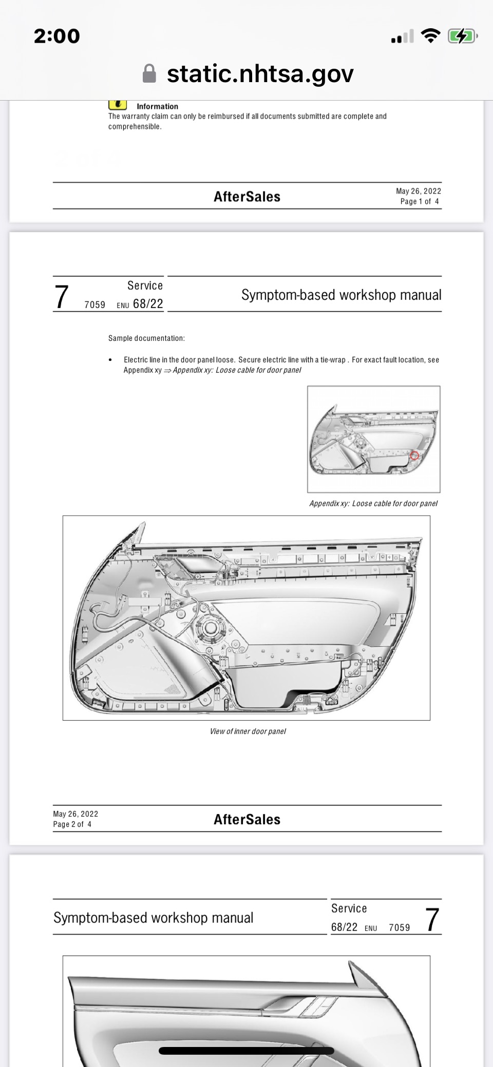

there's a TSB from couple months ago to zip tie the unsecured electrical wire powering the (?) lower red "door open " warning light & puddle light installed in the door panel
..it may click and clack between metal outer door and inner door panel in some 992s ( note image shows the removed LEFT side INNER door panel , not the metal right door outer skin ! )

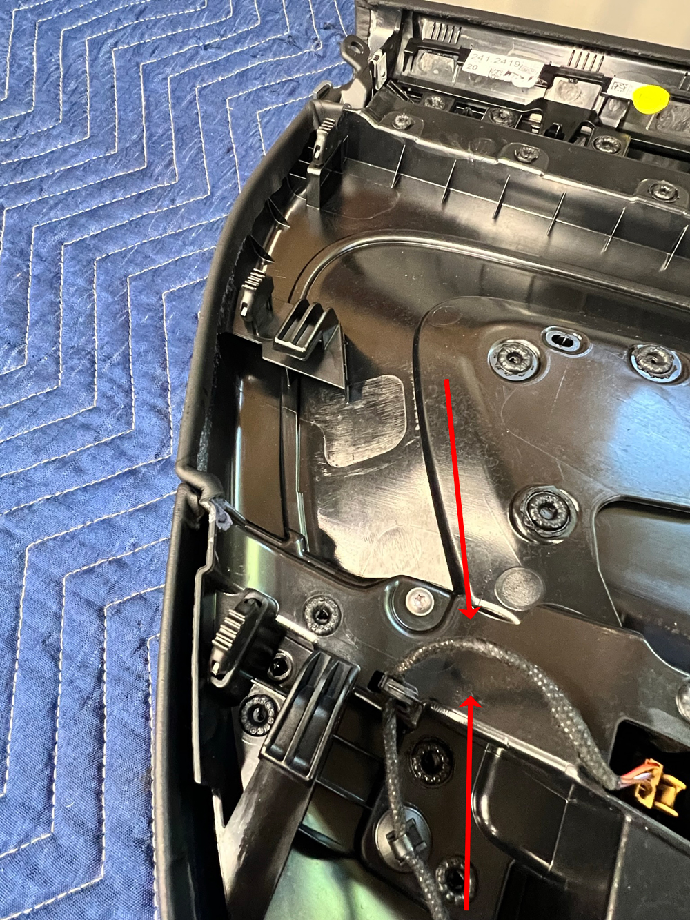

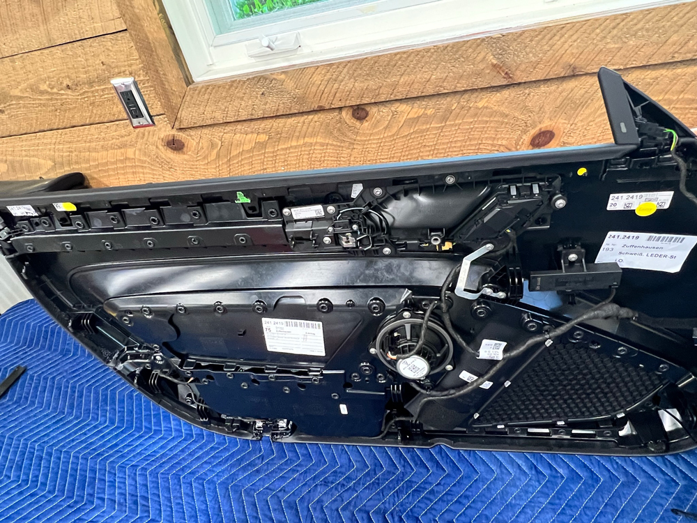

I had my door panel off a while ago, and took these pics. I assume wire with the red arrows if the one called out in that TSB?
