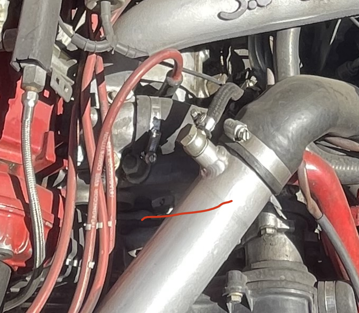

That engine bay looks like it could be by Chris Cervelli based on the age. He was building 3 liter turbo's before hacks like me ever dared. :) There are two basic kinds of 944 blocks. The 2.5 liter motors all had blocks with free-standing 100mm bores. The so-called 3 liter blocks had 104mm bores and the cylinders are joined together. There were also two basic crank sizes. The 78.9mm crank, and the 88mm crank. All 2.5 liter motors had 100mm bores and 78.9mm strokes. All 3.0 motors had 104mm bores and 88mm cranks. Porsche also made an oddball 2.7 liter motor in 1989, using a 104mm bore block and the shorter 78.9mm crank. The head on that 2.7mm motor was an 8 valve head (unlike the 16 valve heads found on the 3.0 liter engines) but with the correct bolt pattern to fit on the 104mm bore blocks. Because that is a one-year only part that is perfect for making 3 liter turbos like yours, it's a rare and expensive head to find these days. Some people also modified the water passage in the front right corner to make a normal 8 valve head bolt up to a 104mm block.
But back to your question. The water pumps for the 100mm bore blocks were slightly different than the water pumps for the 104mm blocks. So you'd want to confirm which block you have before installing a pump. The best way to do that without taking things apart if to look at that front water passage. The engine stamp 'should' be accurate too --but easier to fake.

That's a 2.7 head there, so the engine is most likely a 3.0L.
104mm blocks need a water pump with the 78mm impeller
100mm blocks need a water pump with the 68mm impeller
Don't pay too much attention to the possible "2.5" label on the body of the pump as many Laso pumps with the 78mm impeller came with this rather than the "2.7" label on pumps fitted from new. The very latest pumps don't even have this label I believe, at least mine doesn't.

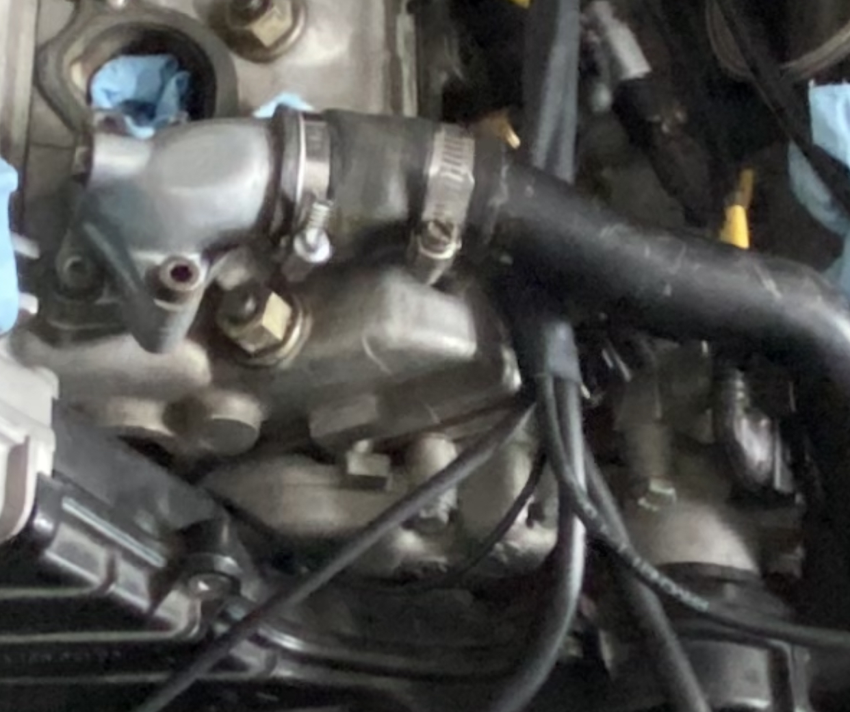

Judging by how straight the water neck is here, I’m guessing it is a 2.7 head.
This is what my car looks like (S2 block with 2.7 head)
