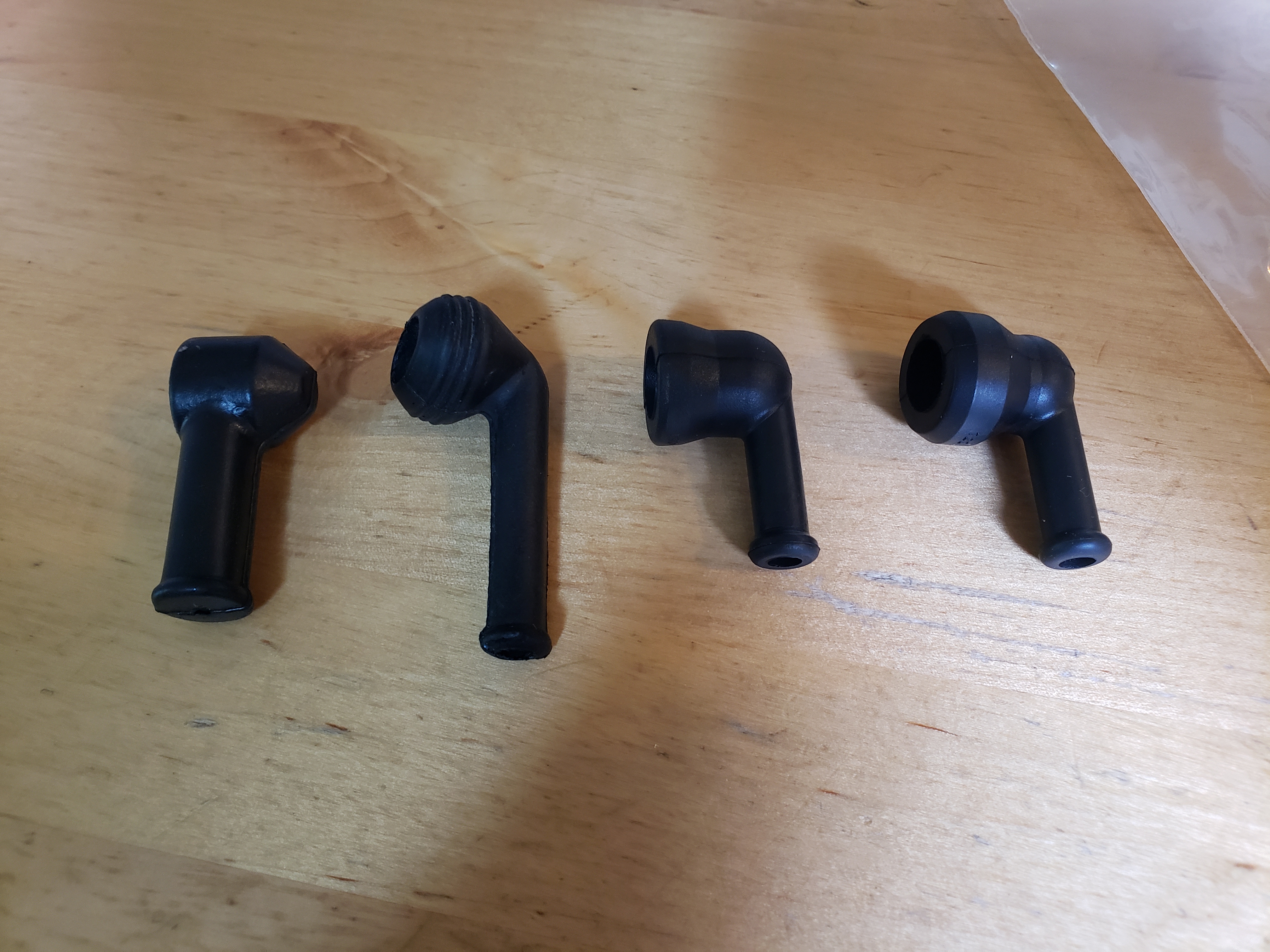

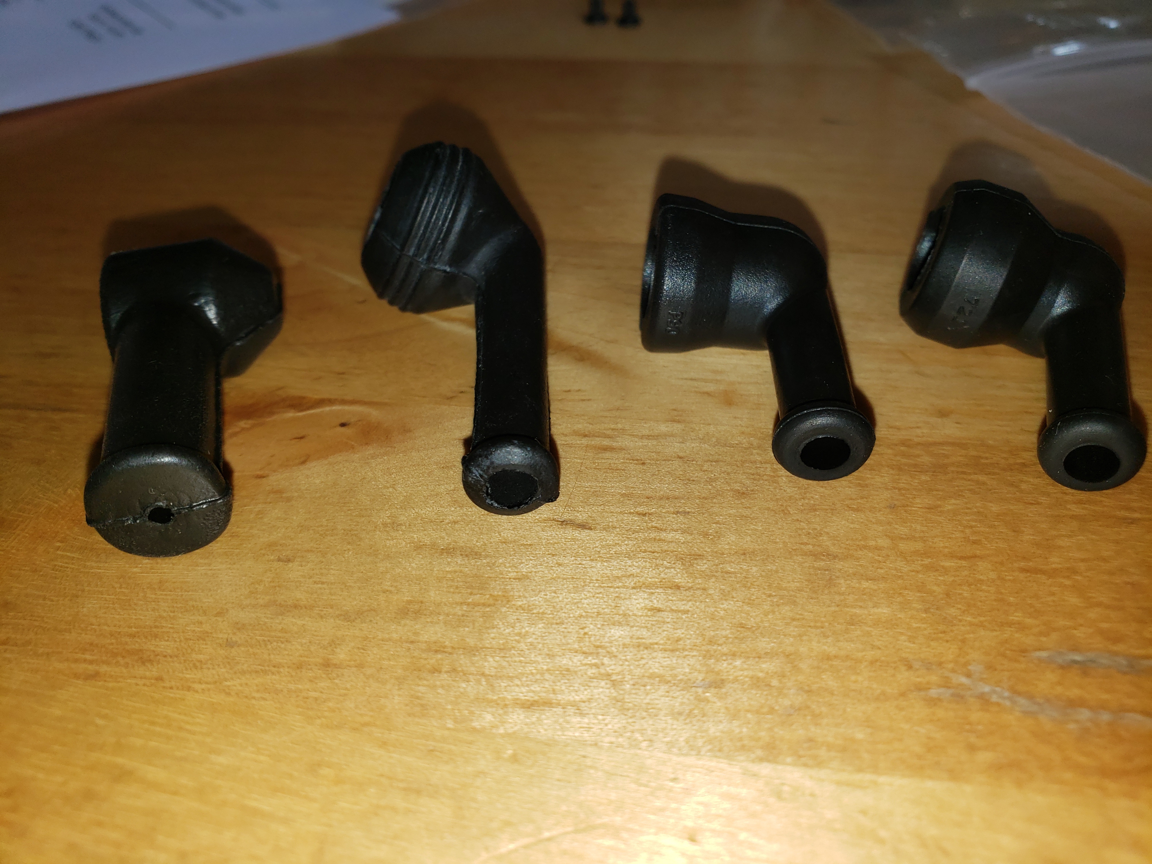

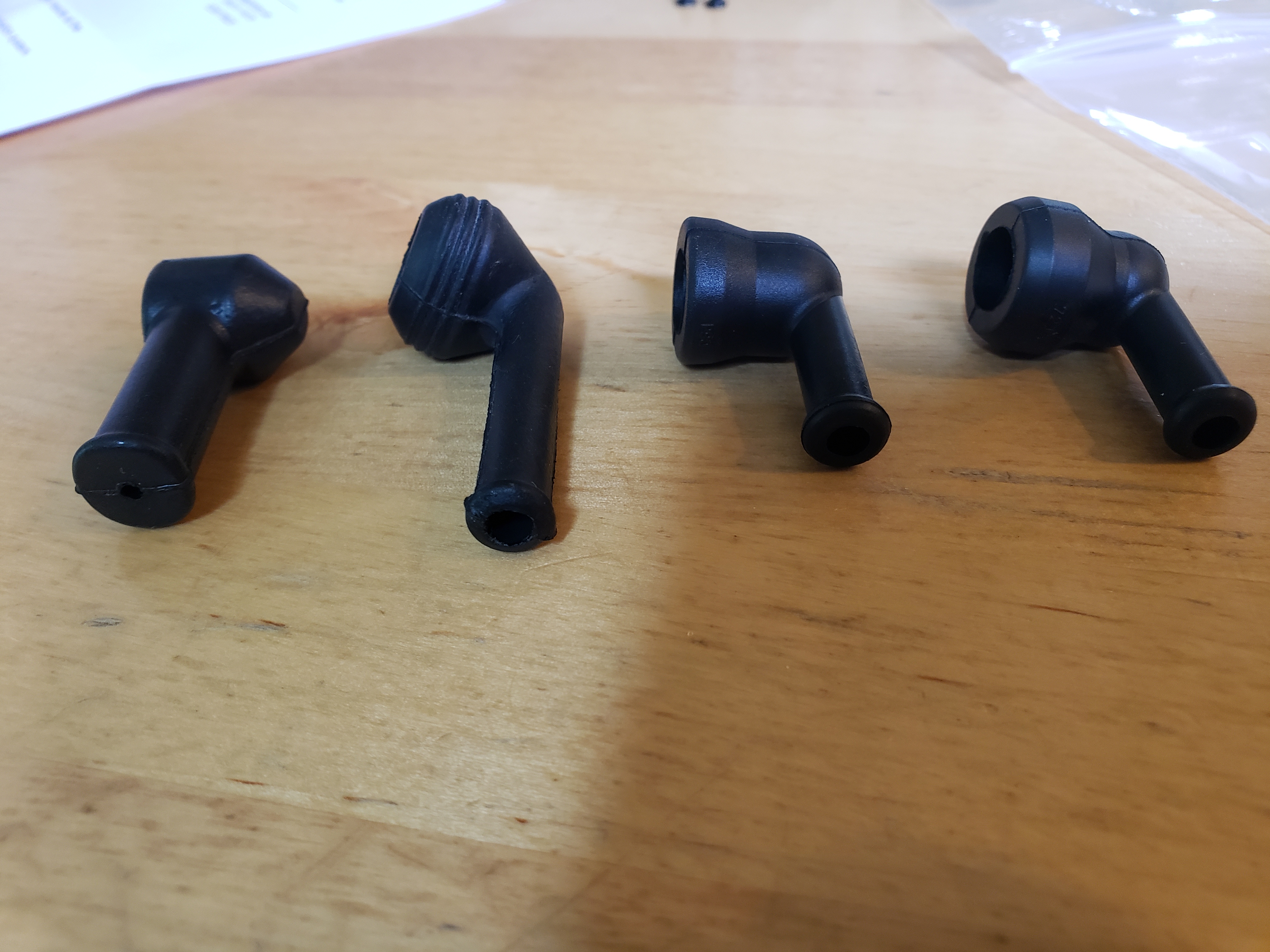

As part of some larger work on motor mounts, OPG, and a steering rack refurb, one of the WYAIT things is dealing with a very brittle oil sender terminal boot. Mine broke when I unplugged the connector and full removal involved cracking the thing off the wire/sheathing.
The nice ones with the ears are a little hard to come by, and the one I ordered from one of the standard vendors didn't suit, so I found some alternatives.
Essentially, these are all 90 degree JPT connector boots. What I liked about them is that I didn't have to cut and resplice the sensor wire to fit it through the boot. I bought 3 options, not sure which one would really work. I went with the longest of the boots but they would all work.
Below you can see the part that I bought, on the left. Try as I might there was no way I was getting the connector through that little hole in the end of the boot. All the others have a much larger opening which allows for the connector to be fed through with no cutting or splicing.
