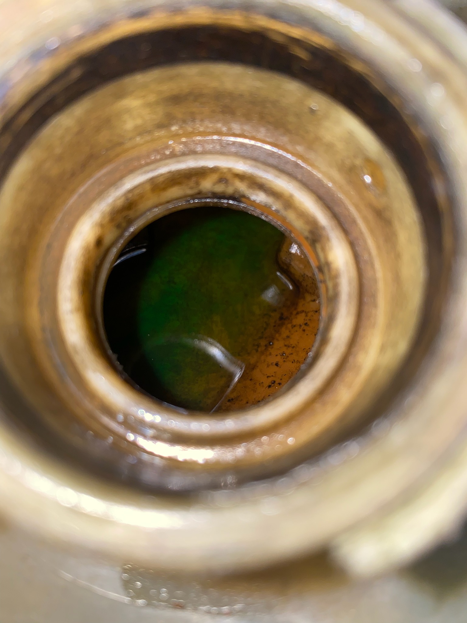

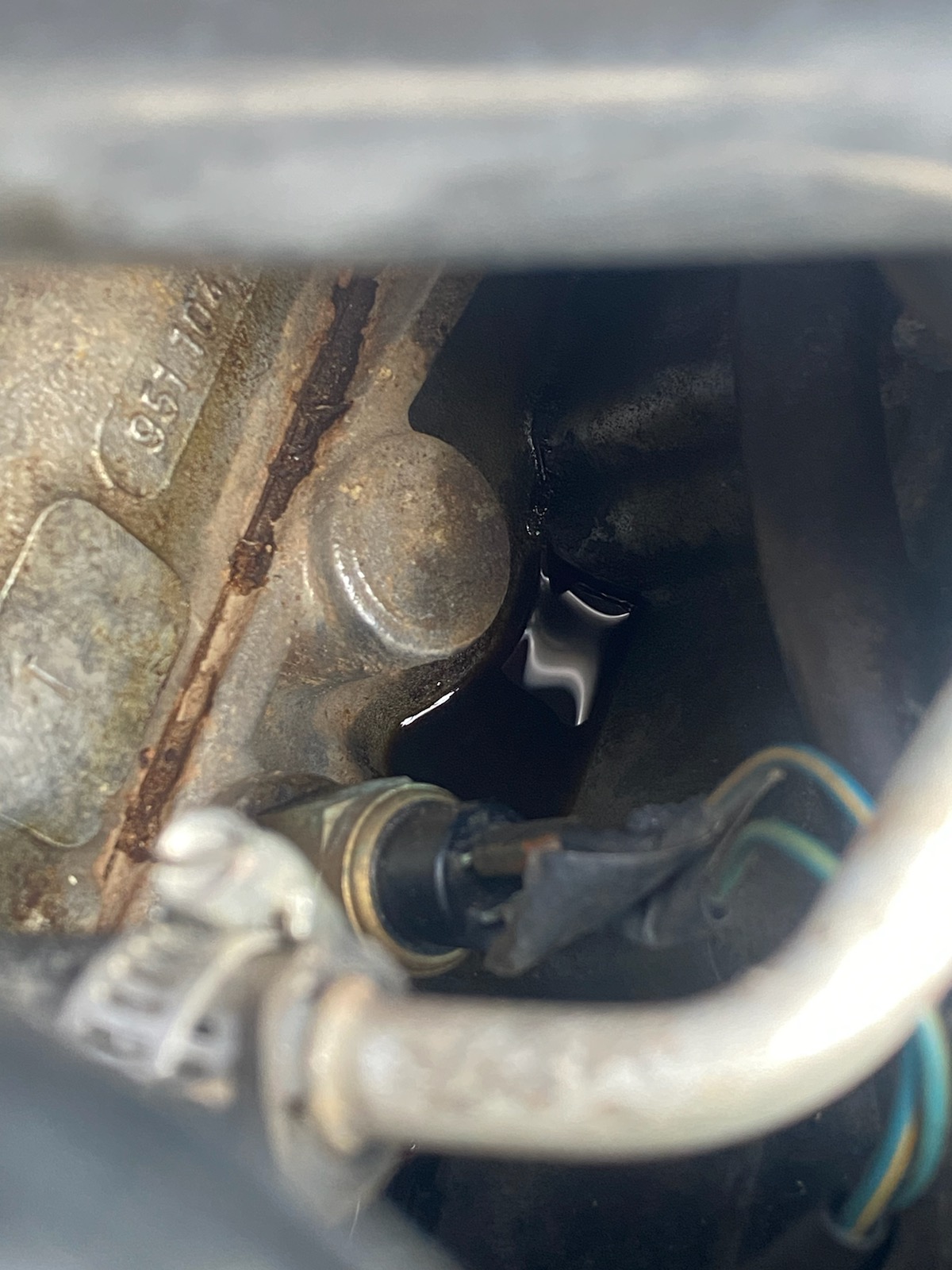

Hi everyone, it appears that I have a head gasket leak. What I originally thought was fuel, has turned out to be a mix of coolant & oil next to my cam tower, right under the intake manifold. No loss of power, white smoke, or coolant on my dipstick/oil cap. How hard is a head gasket job on the 951? The previous owner installed a widefire gasket, but i'm not sure if the head or block were o-ringed. I believe stock head studs were re-used and i'm under the assumption I'll need to source that nifty Snap-On stud removal tool.
I've attached photos of the leak, and an inside shot of my coolant reservoir. All help is appreciated!

Thank you for the quick response, those DIY manuals will be extremely helpful! I'll start with a pressure test in hopes that I can find the culprit that way. I tend to get carried away, and replacing the HG would most likely result in me sending the head to Lindsey Racing
Could the oil thermostat housing seals cause the leak under the intake manifold next to the head? That's what is confusing me the most, since that little puddle is a mix of both coolant and oil.

Deen HK wrote: Sat Jul 02, 2022 3:14 pm Thank you for the quick response, those DIY manuals will be extremely helpful! I'll start with a pressure test in hopes that I can find the culprit that way. I tend to get carried away, and replacing the HG would most likely result in me sending the head to Lindsey RacingCould the oil thermostat housing seals cause the leak under the intake manifold next to the head? That's what is confusing me the most, since that little puddle is a mix of both coolant and oil.
Not really. The seals I'm talking about are internal and down under the headers. My hunch would be that you have two different leaks if there is both oil and coolant under the intake. Do you have mocha-colored sludge on the underside of your oil cap? If coolant is getting in your oil, and you have an oil leak, then maybe one external leak could do it. I'd start with pressure testing the cooling system and go from there (after cleaning up any existing oil or coolant).
