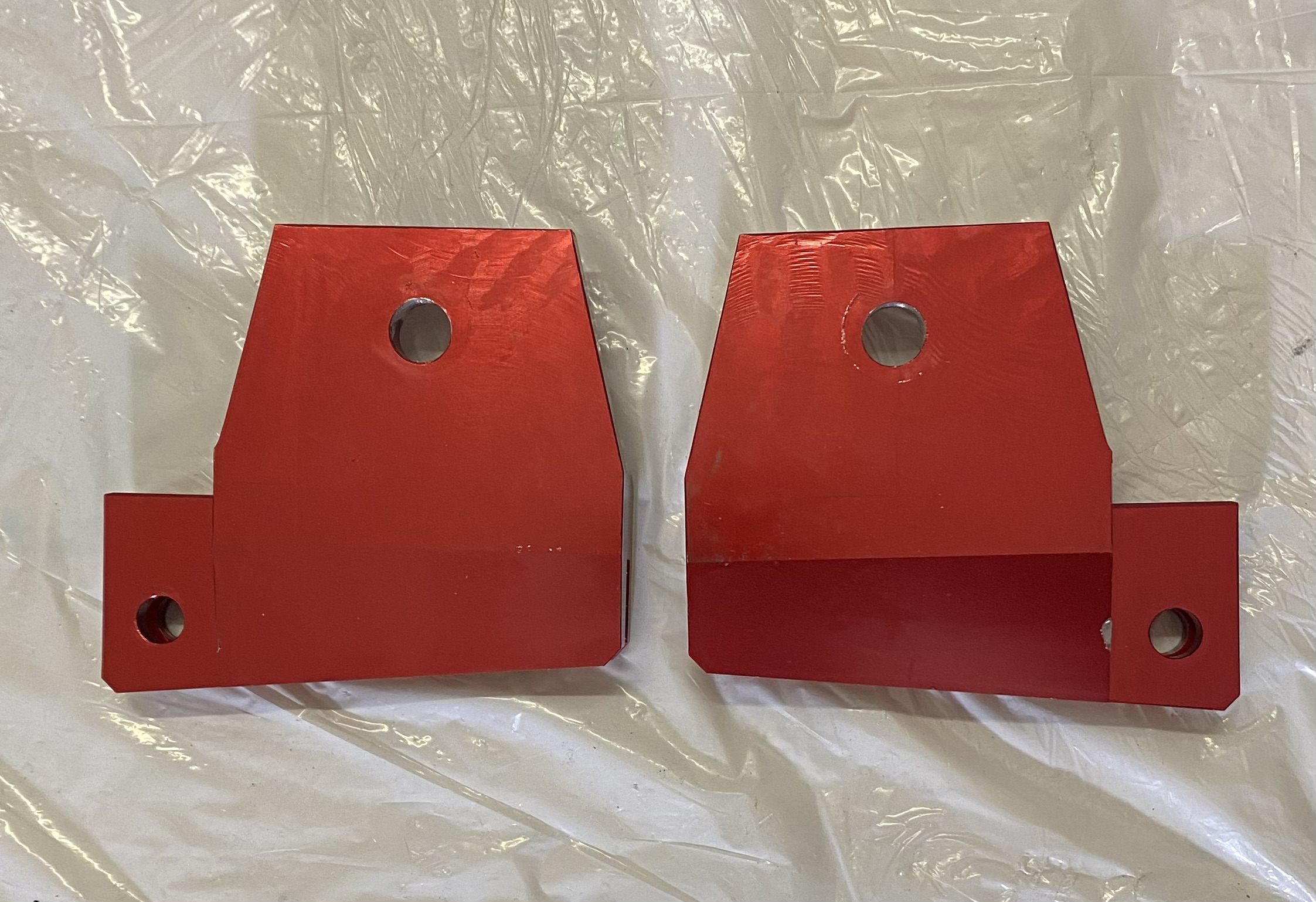

by Dave W.
Latitude48 wrote: Sun Jul 03, 2022 10:29 am
Dave W. wrote: Sat Jul 02, 2022 1:43 pm I tried the Racers Edge solid replacement for the #12 bushing and I didn't like it on my street car. It made no difference in vibration-type noises. The main drawback was that it transmitted a loud thump sound whenever I hit a large bump or any sharp edged bump, such as the lip on a driveway entrance.
I can understand the thumping sounds as my S2 has Racer's Edge spherical camber plates up front and the Koni 3012s in the rear have spherical mounts. I don't notice any issues with vibration but with my 18" wheels and tires you do get impact noise. Guess I'm used to it now.
If you'd like to try them out I have a pair for sale that I'll sell at a good price. The anodized coating has rubbed off in a couple spots from pressure on the load bearing points but otherwise are in great shape.
