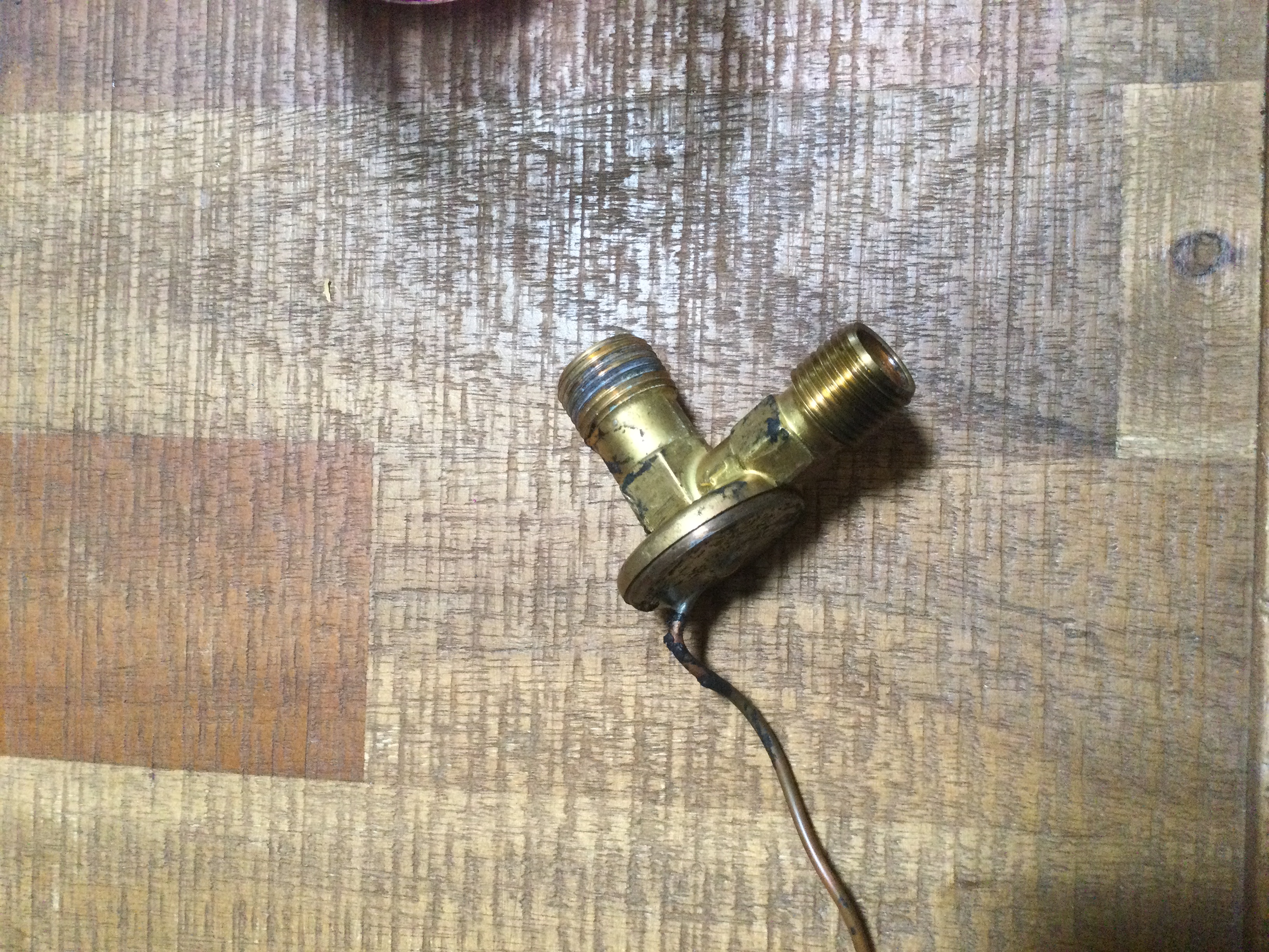

Update on my issue.
Took the car to Radiatorland. They specialize in AC and radiators. The tech there has over 30 yrs experience on AC system and the owner is a 911 SC owner.
They Evaluated the system and charged it up but the high pressure side was low on pressure. They found the expansion expansion valve to be the culprit. This is when they called me to explain the situation.
According to their estimate they would need to remove the HVAC unit and in order to do that they need to remove the dash. This is according to their manual they they use for reference. They quoted me over 2k to do the job. Told them let me think about it and I automatically did a search on Expansion valve replacement. I found an post from 2010 on Rennlist and another on Pelican. Both post states you can access expansion valve directly from the hood where the blower motor sits.
I showed the post to the owner. He’s familiar with Pelican and Rennlist. He said they’ll give it a shot using this method. 5 hrs later car was done.

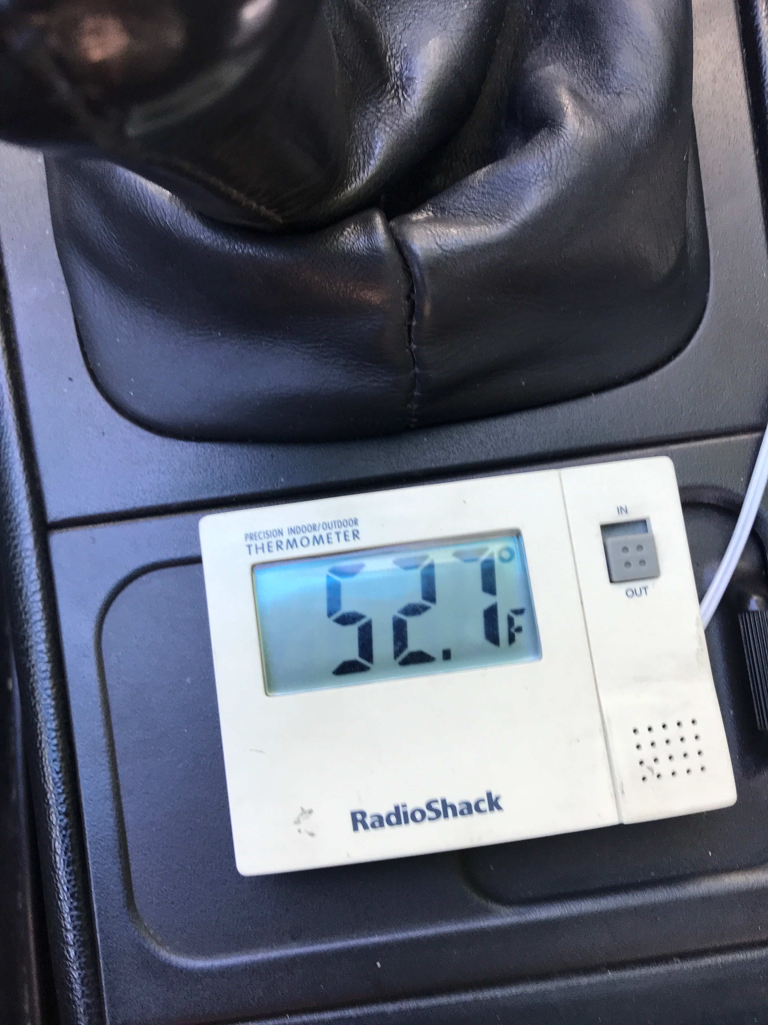

Note
The Thermometer temp was at a stop. While moving it was 50 deg
