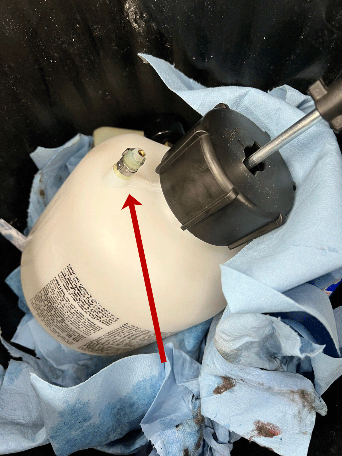

Well that blows, literally. I went to bleed the brakes with my Motive Bleeder and all seemed fine until it didn't. The main line out of the tank tore apart at maybe 12psi and blew clear off. Brake fluid then spit out the hole all over the engine bay. Most of it ended up on the plastic cowl protector thing, but took me at least an hour to make sure cleaned it all off everywhere. I had a moving blanket on the fender thank goodness, so as best I can tell the only painted part that it hit was the firewall under the hood. Basic nightmare scenario. Reading the Motive instructions, it says they "highly recommend" changing the hoses every 3 to 4 years, and now it's pretty obvious why they say that.

Tom, I replace mine every so often with Tygon tubing. It isn’t that expensive and is POL resistant.

Motive also sell a repair kit to replace the hose & clamps. That's what I used although you can probably do it more cheaply by getting the tube at the hardware store and just using fuel injection hose clamps.
Another thing you can do is dry test it first under pressure, and go a bit beyond the pressure you intent to bleed at.

Yeah, I dry tested it last night and again this morning. It was waiting for just the right moment to burst apparently. I'm sure I could replace the hoses, but I never want to see it again so threw it out.johnb wrote: Sat Jun 04, 2022 3:36 pm Motive also sell a repair kit to replace the hose & clamps. That's what I used although you can probably do it more cheaply by getting the tube at the hardware store and just using fuel injection hose clamps.
Yeah at that price is hardly worth fiddling with new hoses I suppose. The same day delivery still amazes me. Like I have literally got stuff faster than I could get it from a local store sometimes. And it doesn't seem to matter how obscure it is. I have this tiny RC helicopter that uses weird little LiPo batteries, and I was able to order them one morning and have them waiting for me when I got back from workTom wrote: Sat Jun 04, 2022 4:05 pmYeah, I dry tested it last night and again this morning. It was waiting for just the right moment to burst apparently. I'm sure I could replace the hoses, but I never want to see it again so threw it out.johnb wrote: Sat Jun 04, 2022 3:36 pm Motive also sell a repair kit to replace the hose & clamps. That's what I used although you can probably do it more cheaply by getting the tube at the hardware store and just using fuel injection hose clamps.
Another thing you can do is dry test it first under pressure, and go a bit beyond the pressure you intent to bleed at.At $54 delivered for a new one (that isn't stained blue), I figured it wasn't worth the time and effort to track down hoses and clamps. I'll be more mindful of the issue with the new one, and get some tubing for the occasion....
