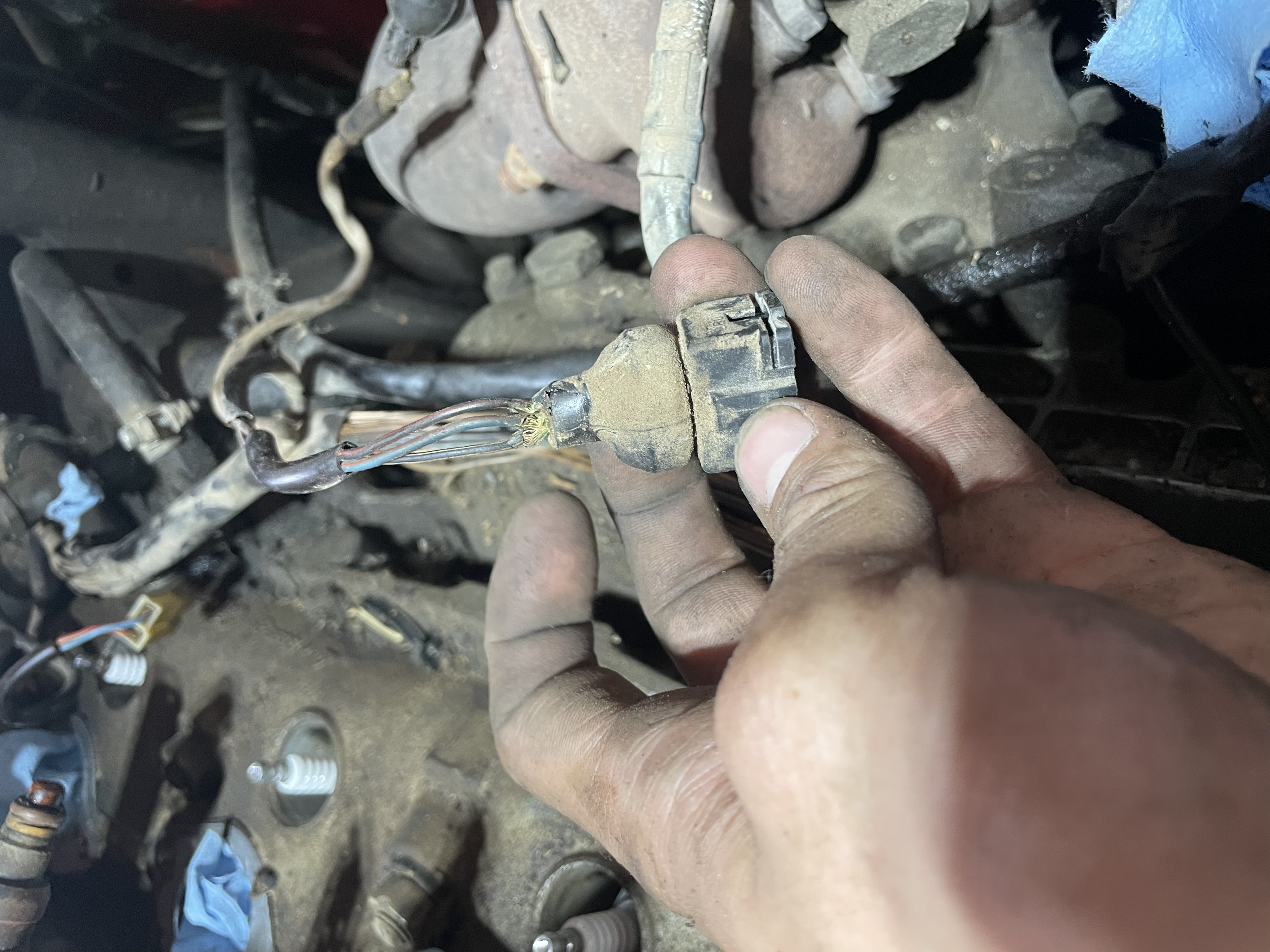

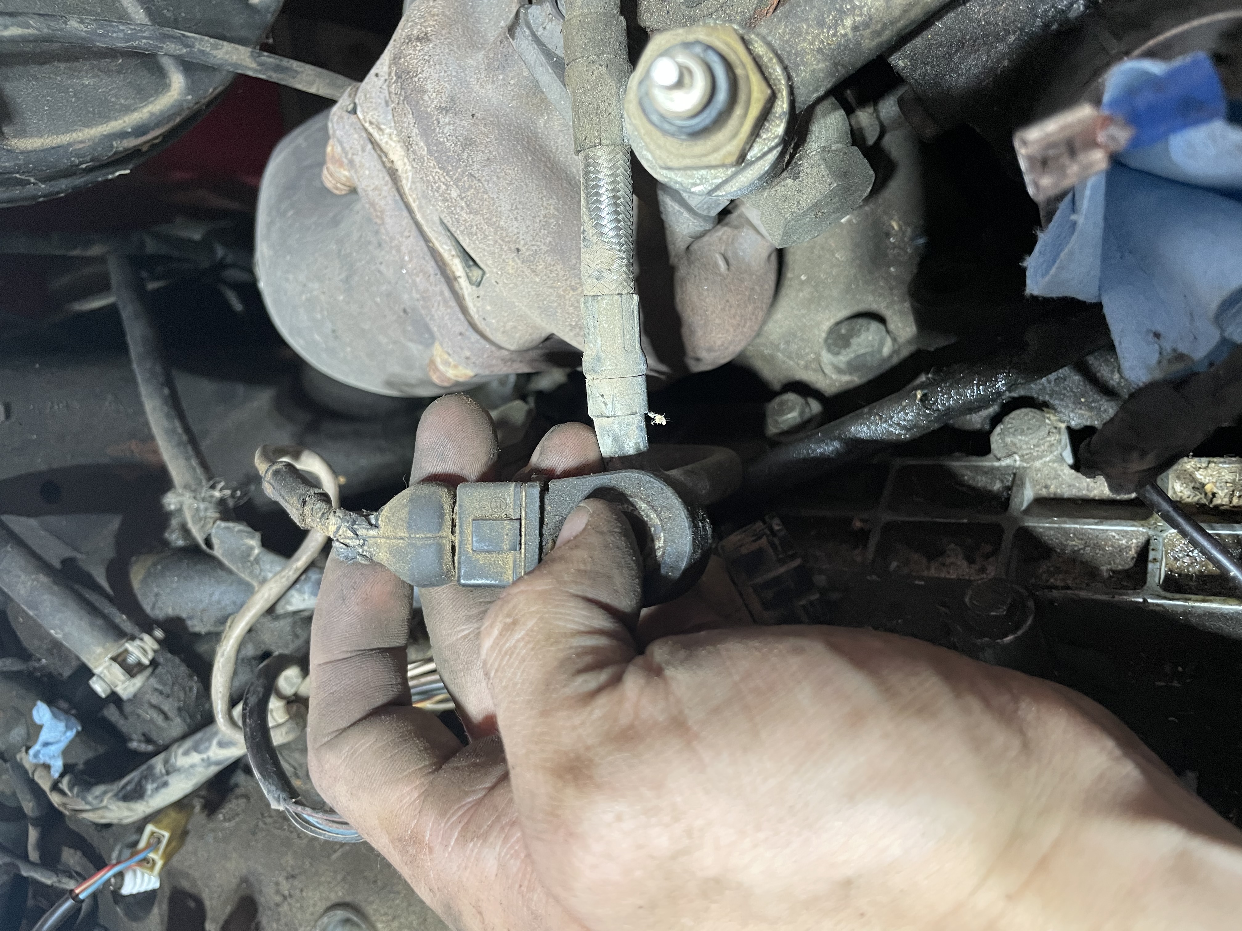

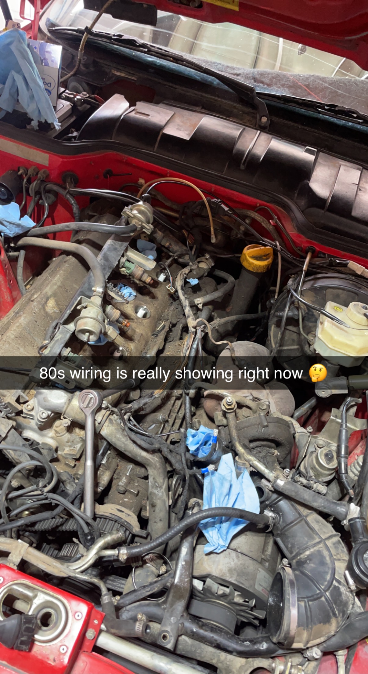

Thank you so much for being on this Tom sorry I stopped responding I was just working and barely had time to catch up once I got home I spaced out the internet and just started checking everything that was mentioned….. and boy oh boy I had so much waiting for me under the hood I started checking the sensors mentioned and to my concern every harness on this vehicle needed some love from my knock sensor, tps, icv and just everything lol but I noticed one and just dug deeper and so now the intake is off and to find out the last mechanic who worked on this car ruined the vacuum like routing… I seriously don’t know how this car was running let’s just say
but new harnesses are on the way and new hoses I’m excited to feel the car afterwards!
Since I do have the intake off anything you would mention to touch up or can see from the photos that need attention? Every hose for the vehicle has been ordered vacuum, fuel, and coolant and the Venturi delete as well I’m going to be cleaning all the grounds and the bay and changing the necessary harnesses but now it’s just waiting patiently for parts
