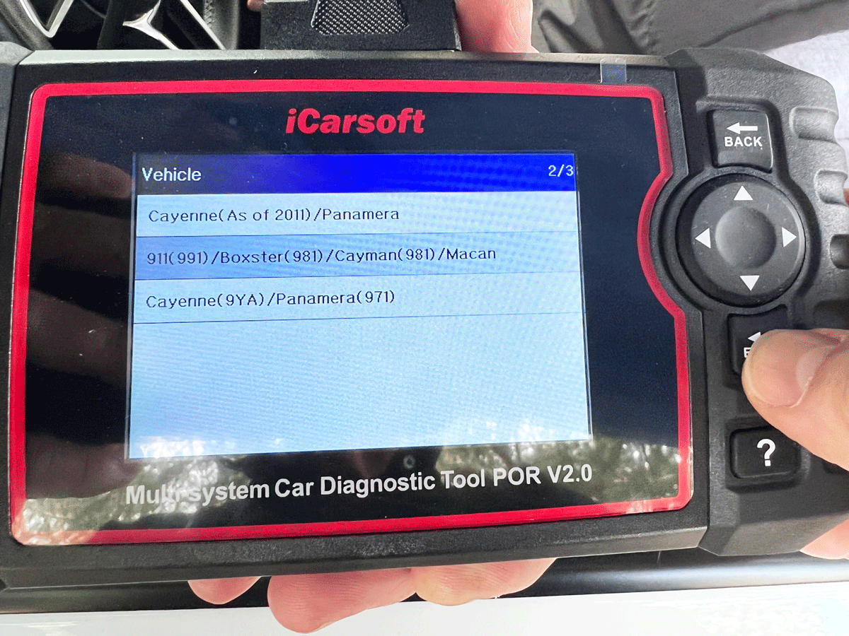

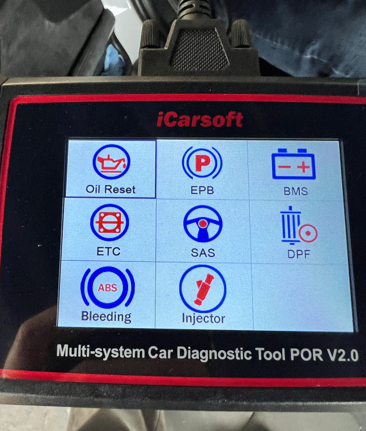

Hmmm... that is low... I have not used it myself to register a new battery, but it does have that function -- see the BMS (battery management service) screen in the pic below. If you don't use a dealer battery, you have to fudge the serial number, etc. Going through the screen shots, I also found one that confirms it has the Macan listed....
