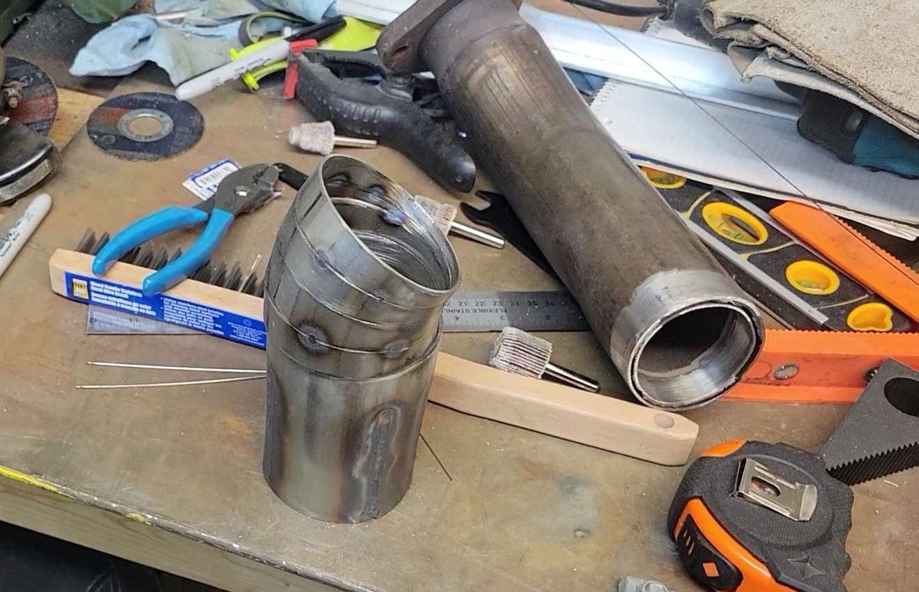

On the stock 951 the exhaust pipe between the downpipe and the catalytic converter is double walled. Apparently the inner wall is known to collapse over time / heat cycles. I learned about this after drilling a hole to install a wideband O2 sensor bung and being baffled by what I could see inside the pipe. Yesterday I finally cut the pipe in half to reveal just how bad it was.
I can't believe the car still ran as well as it did! But the performance was obviously being restricted by this, plus a number of other aged components I'm replacing. The logical thing to do here is buy an off-the-shelf aftermarket exhaust system, but why would I do that?
So naturally I bought a tig welder, some stainless pipe, and am learning as I go. At the risk of having my novice welds being ridiculed, I will share my progress and approach.
I am using 3" stainless pipe, a straight-through muffler, will include a catalytic converter, and plan to use pie cuts (or lobster cuts) to form all the bends. Not a whole lot to show yet, but here is my first bend tacked together with a reducer to connect to the original downpipe flange.
This is the last big item keeping my car off the road and summer is here, so I'm trying to get finished within a couple weeks. I'll keep updating the thread as I progress and likely make a YouTube video once I'm done. Hope to inspire or at least show what goes into something like this!

Nice welds Tom and AudiSport. I hear you about the pie cuts not being very beginner friendly, but so far it hasn't been too bad. I figure it's good practice like Tom said. All this will be hidden under the car when I'm done so hopefully I'll have developed some skill by the time I weld something visible. Also I have a decent amount of mig and stick welding experience already. The whole idea is to have fun and I am succeeding. :thumbup:
I finished the seams on the first elbow tonight and am pleasantly surprised with the results so far. Only complaint is how long this is taking and how much argon I'm using.
I think I'm overheating (cooking) the stainless but haven't burned any holes yet.
Also prepared the mini catalytic converter:
For the record this is 3", 14ga, 409 stainless pipe. Using 0.035" ER308L filler, with Solar Flux instead of back purging. Welder is a Primeweld TIG225ACDCP running around 40-50A.
1 elbow down, 4 or 5 to go. More updates to follow.
