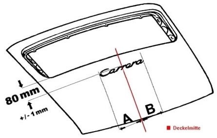

In case you ever had to replace your badge --- note the 80mm gap between the spoiler opening and the top of the lower case characters.

Jlaa wrote: Sun May 15, 2022 3:58 pm In case you ever had to replace your badge --- note the 80mm gap between the spoiler opening and the top of the lower case characters.
Is this illustration from Porsche itself? I need to put the emblem back on my 992 after PPF, and it seems like everyone relies on templates they make themselves before removing the emblem....

Tom wrote: Mon May 16, 2022 8:34 am
I remember I got it from a German Porsche owner's club I think!
