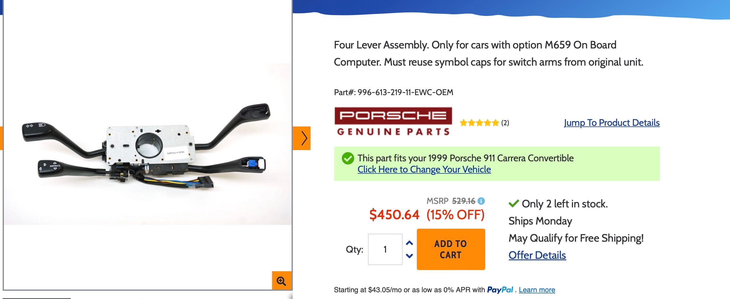

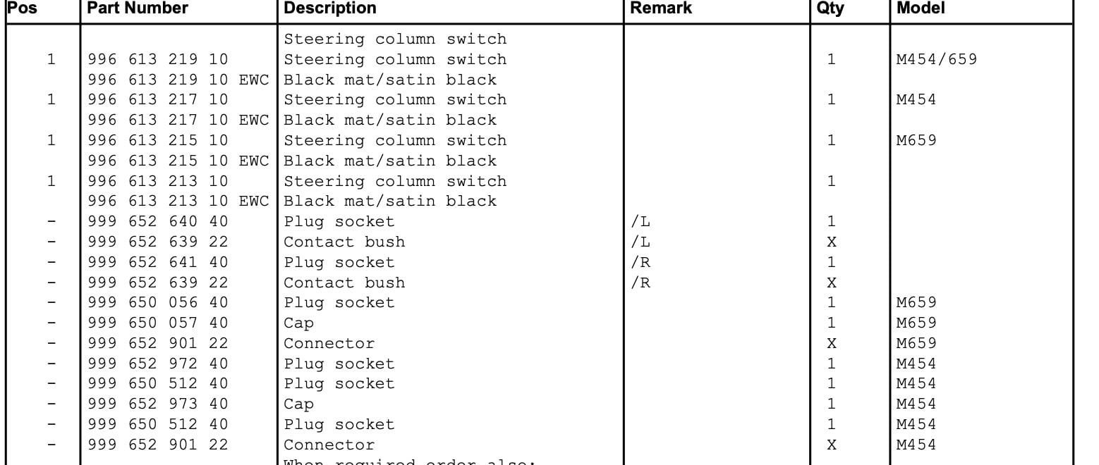

You probably just need a new turn signal stalk. Shop carefully though, there are a lot of variations... A dealer can likely give you the correct part number with your VIN...
